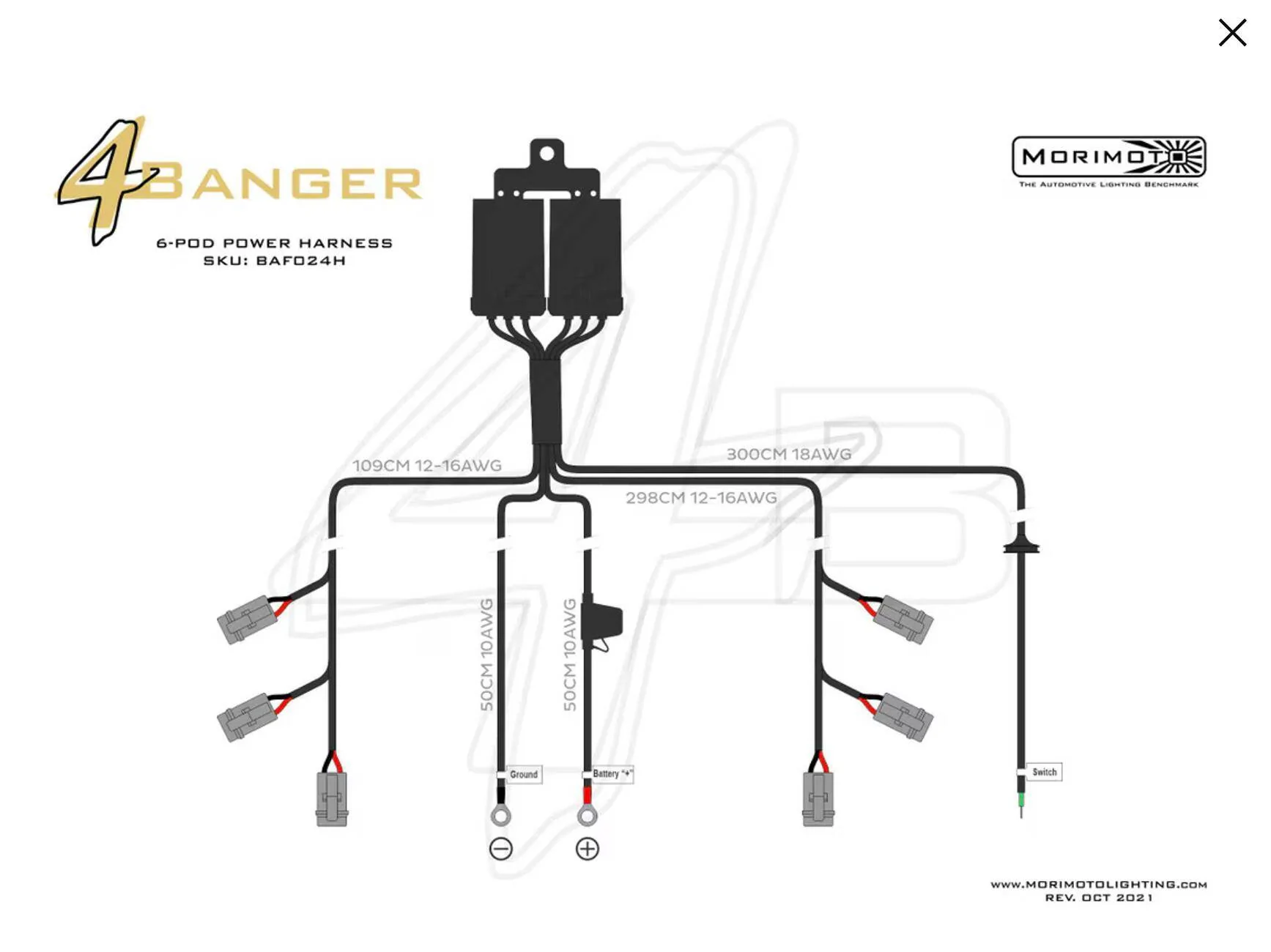

I have a 2023 4 door Outerbanks - High package - Mod Bumper - No uplifter switches
I bought the Morimoto 6 pod fog lights and need some help installing them. I have their power harness that connects all 6 pods to one ON/OFF switch. I did purchase a new headlamp switch (M2DZ-11654-DC), but I do not know how to tie in into the wiring harness just for the ON/OFF switch. Is this possible? So basically I need to know where to connect the switch wire from the Morimoto power harness to control the fog lights from the fog light button.

Thanks @Brian_B! I have read through that thread a few times. I am still confused if I can just connect the switch wire from the power harness to somewhere that will let me use the fog light button. I don't want to cut off or tear into the factory fog light wiring harness unless that is where I can find the one switch wire. If I follow that thread it looks like he ties into both left and right fog like ends. I want to just use one side or find somewhere before it splits into two.

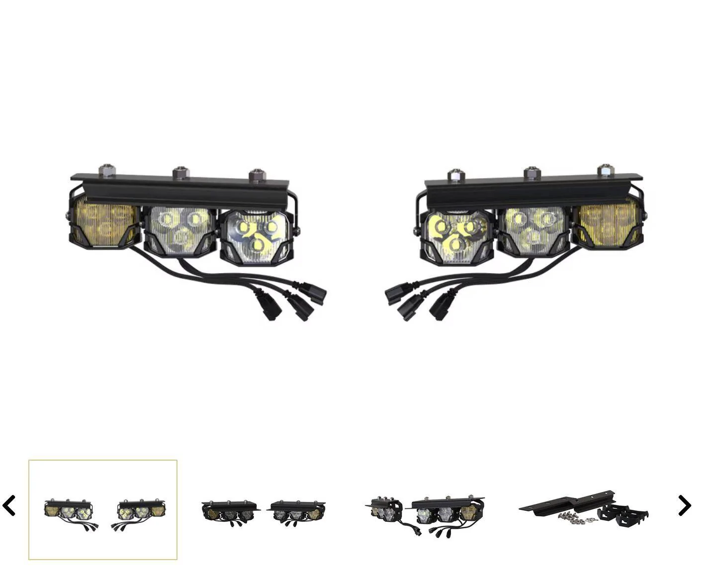

We sell the Morimoto Fog kits for anybody interested and don't charge any extra for our harness.
You'll want this pigtail. It will connect to one pair of the fogs. The other 2 will be controlled from the switch still:
https://www.4x4truckleds.com/crysta...il-pair-2021-ford-bronco-w-hd-modular-bumper/

@4x4TruckLEDs.com Do you make a 3 into 1 connector so I can connect all 6 fog lights to the factory wiring harness? I want to control all 6 fog lamps using the fog light button.
