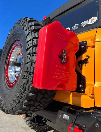

Would that need a spare tire reinforcement? I have stock 35s on right now.
It would help. But also if you got a reinforcement like Hammerbuilt it has a rotopax mount option and you could skip the strap on mount. That's what I use.
Ford Bronco Mounted Fuel Tank Recommendations? Screenshot 2024-12-04 215044

Interesting. I'm looking at it now. So help me understand, it requires the $215 mount, and then the $100 tailgate support accessory arm, plus a rotopax all purchased separately correct?

Yes it adds up pretty fast. I think to keep your budget you'll have to look at knock offs. Amazon has some inexpensive rotopax style containers and spare reinforcements.

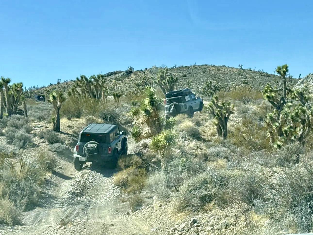

I do. Bag has held up well and the 2 cans fit nice and snug, side by side.
400 miles across washboards of Mojave and Death Valley last month.
So much better than $500!

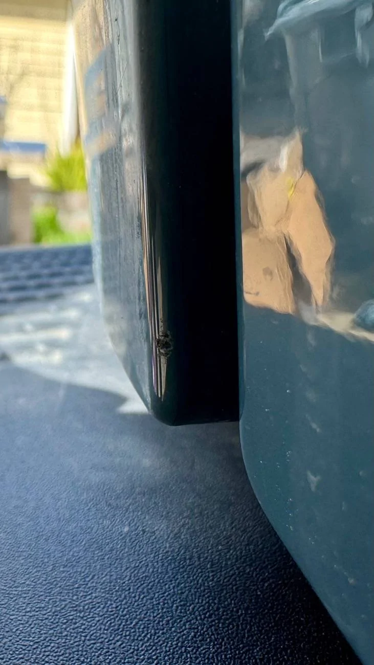

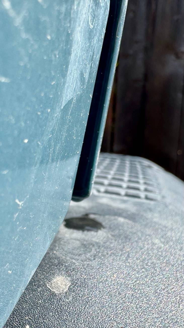

Yeah, I’ve been seeing the factory tailgate can hold 133lbs. The Sasquatch wheel/tire combo is 87lbs. And that leaves 46lbs. I’d have to look at my excel document but fuel is like 6lbs/gal and water 8.34lbs/gal.
All looks correct to me.
I’d limit it to 35 max. My tailgate wasn’t off this much prior to run.
Ford Bronco Mounted Fuel Tank Recommendations? IMG_1180
Ford Bronco Mounted Fuel Tank Recommendations? IMG_1179
