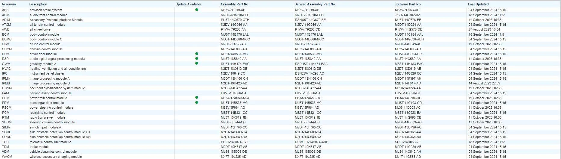

No, ignore that column to the right. That refers to the last time that particular module reported it's status to the server; not when it was last updated as far as software goes. OTA dashboard does not show any recent OTA activity for your truck. Not far behind at all.
Correct; you are on Sync which is one version behind the latest for the Broncos. 23291 is the latest version and that will come with OTA 6.3.0. You need the GWM update to come in first and that will release the APIM update for the latest Sync software.
As coincidentally as it might be, 6.1.0 just came through this morning!

Sweet! I see the update went through, but the list looks the same. Notice on the column to the right, the GWM didn't report itself back to the mothership after the update, so it is still showing a GWM pending and the APIM is not released yet. Once the truck syncs itself up, the GWM will clear and the APIM should pop up.
Awesome thank you
