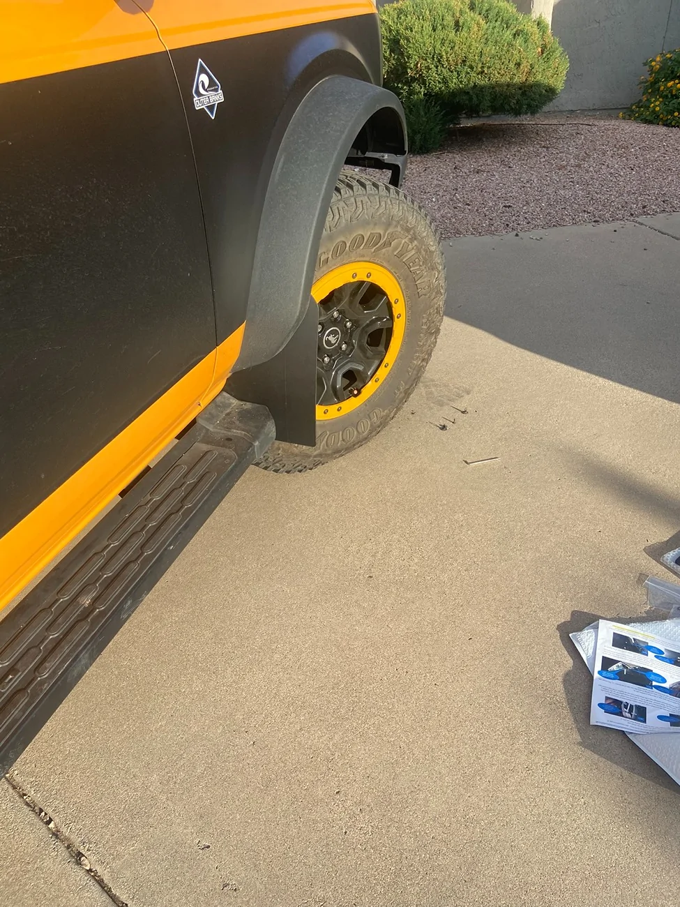

I have Bro-Flaps: Sasquatch mudflaps short on the front, non on the back. No drill and easy to install. Got them on etsy.

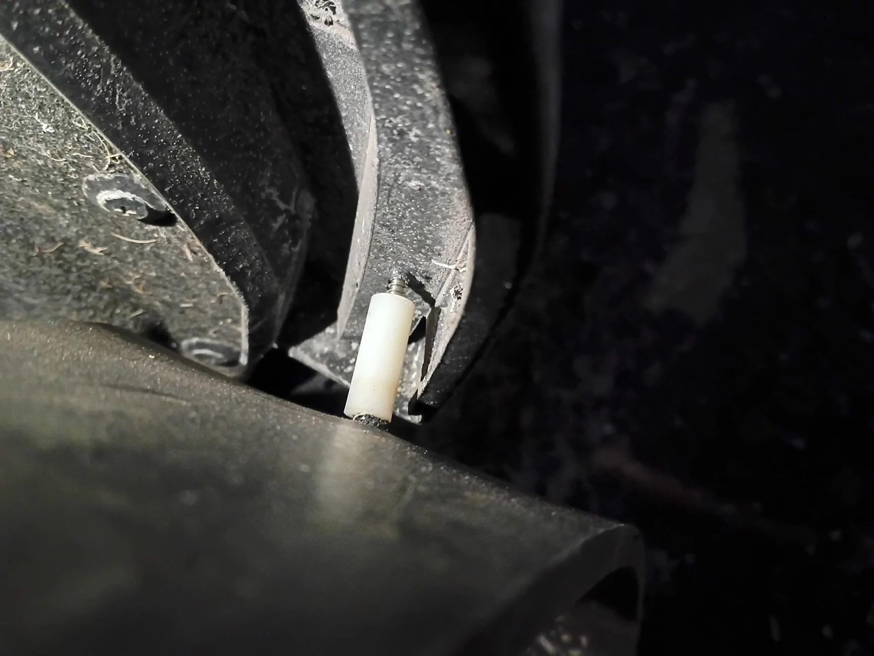

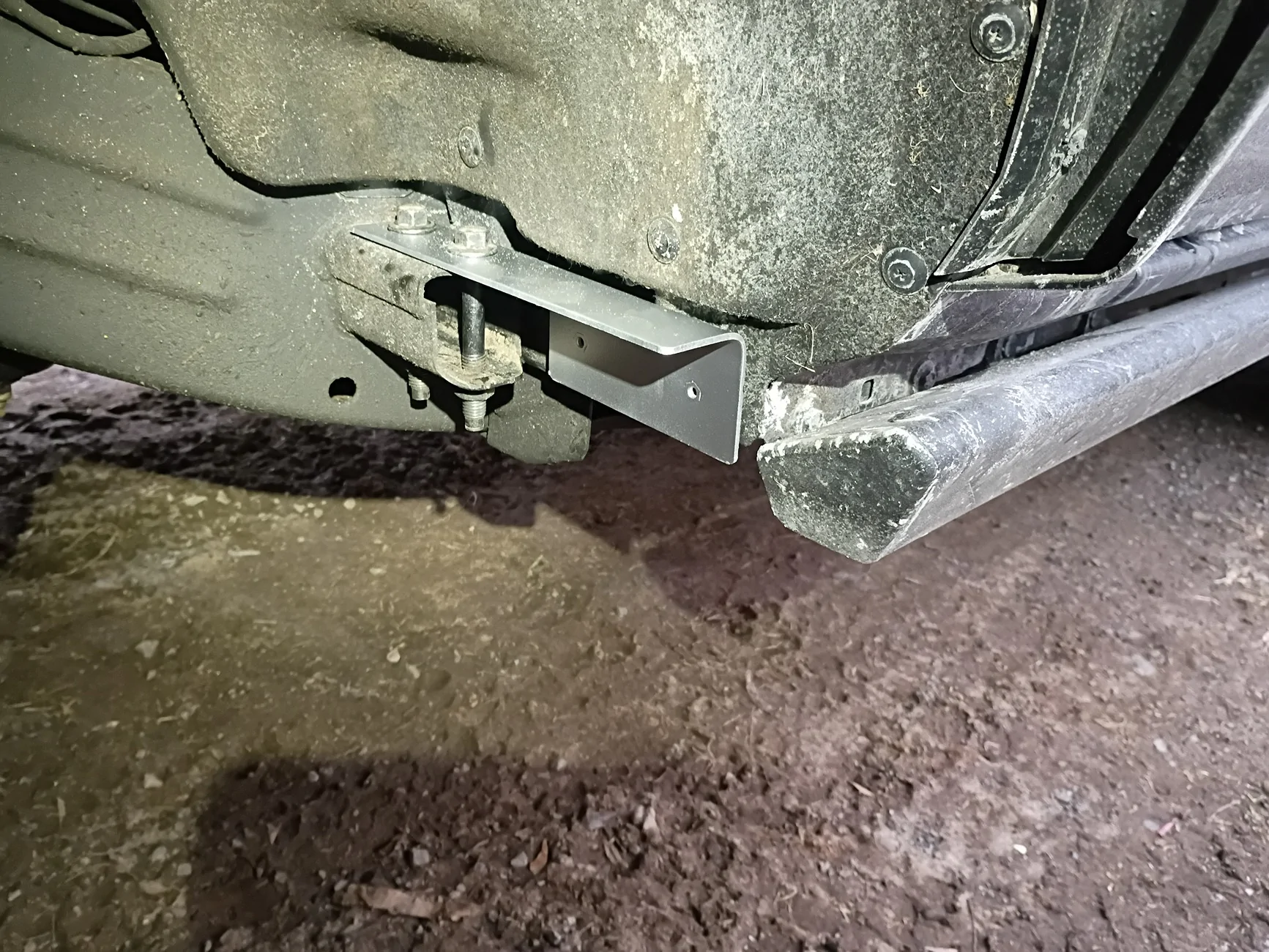

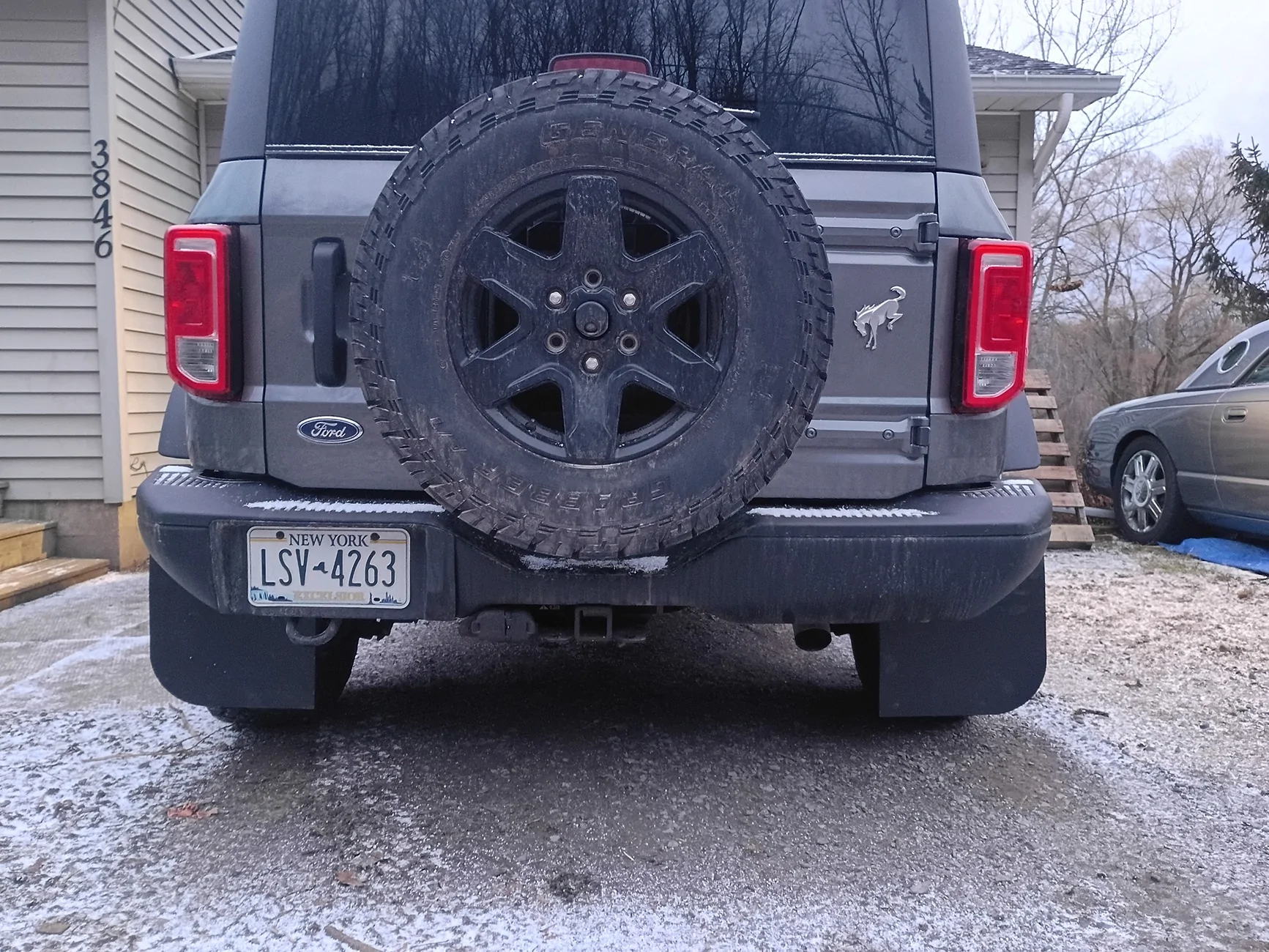

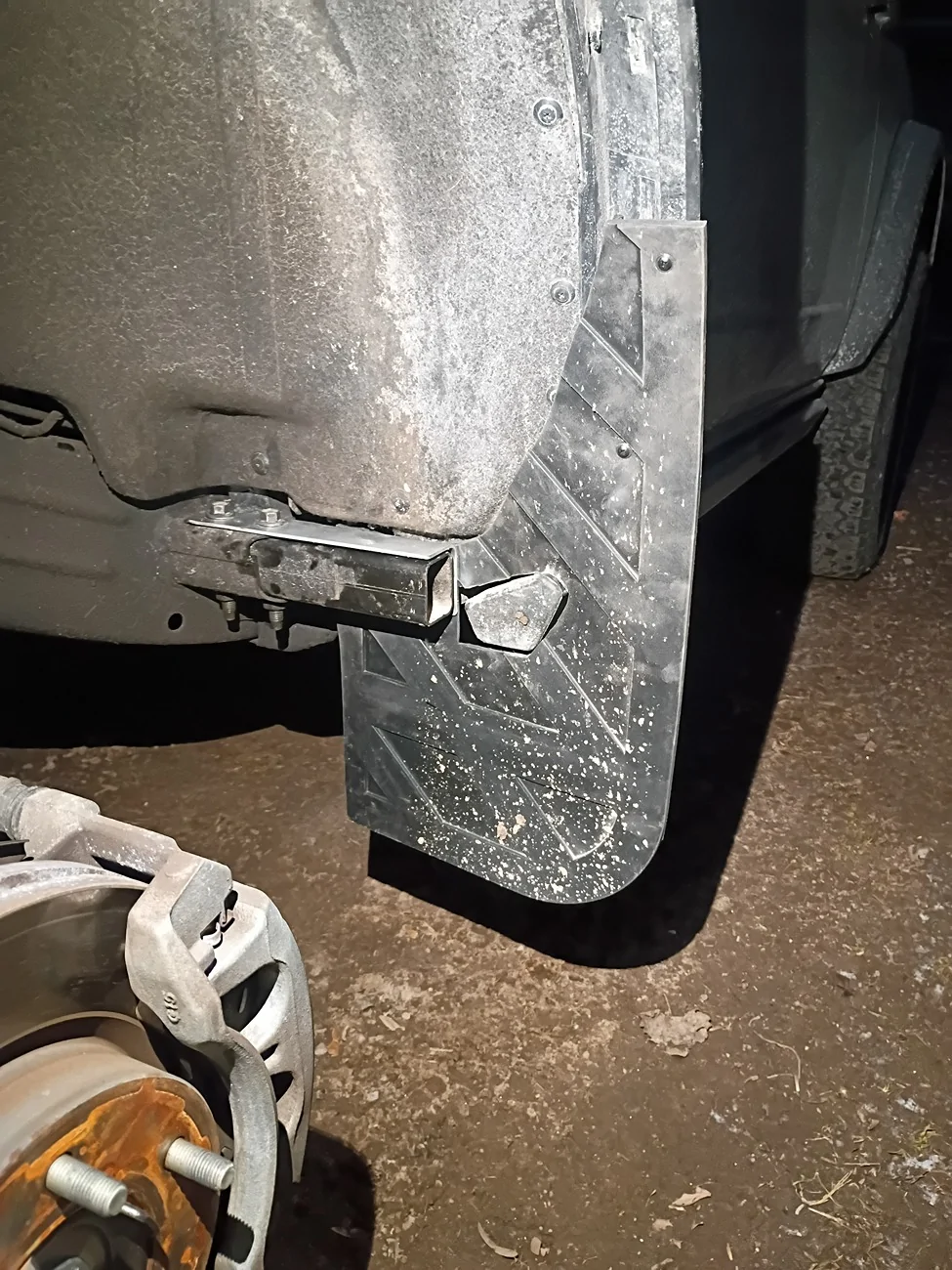

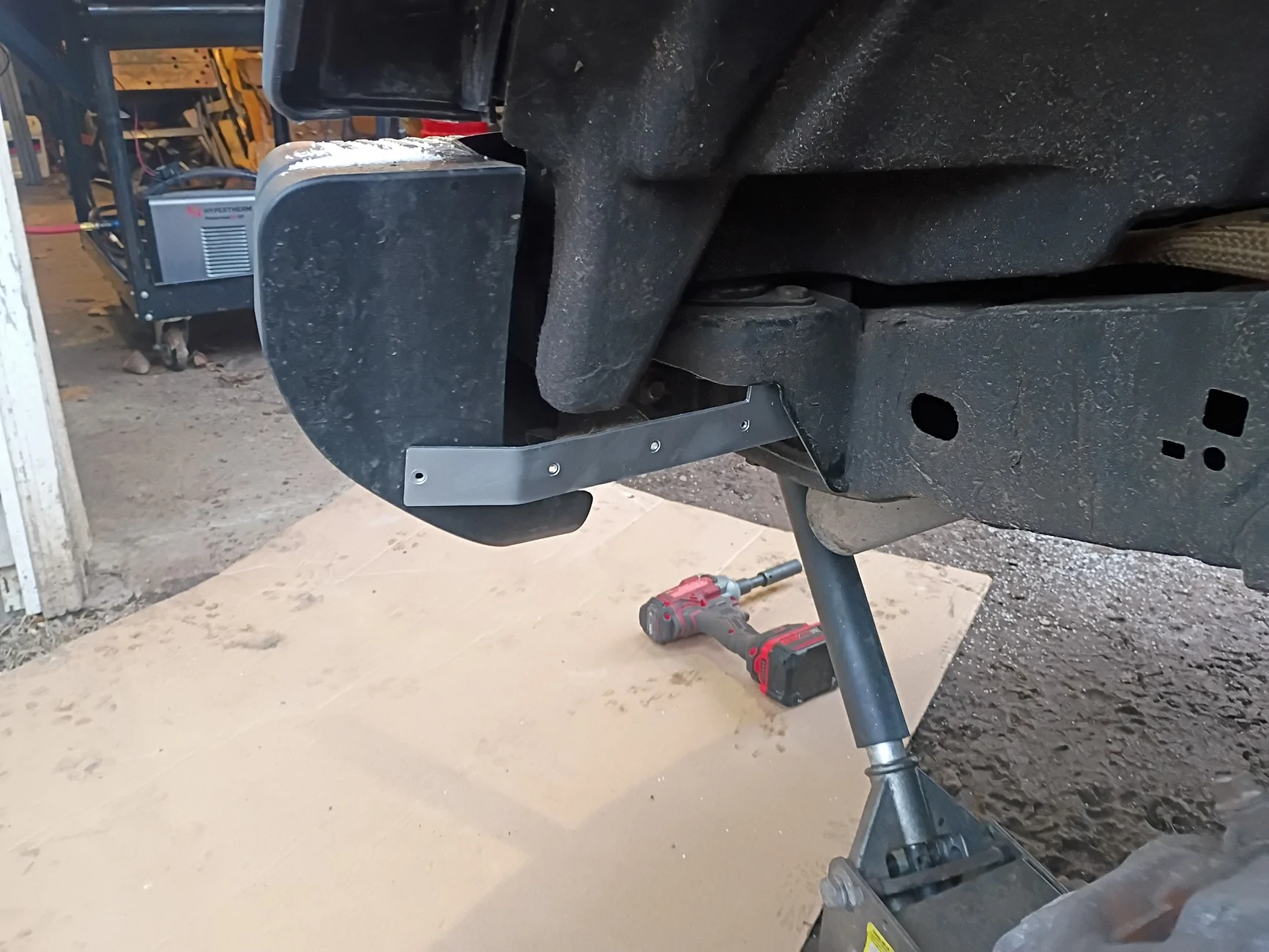

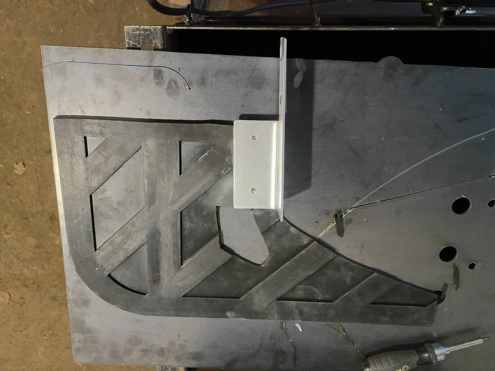

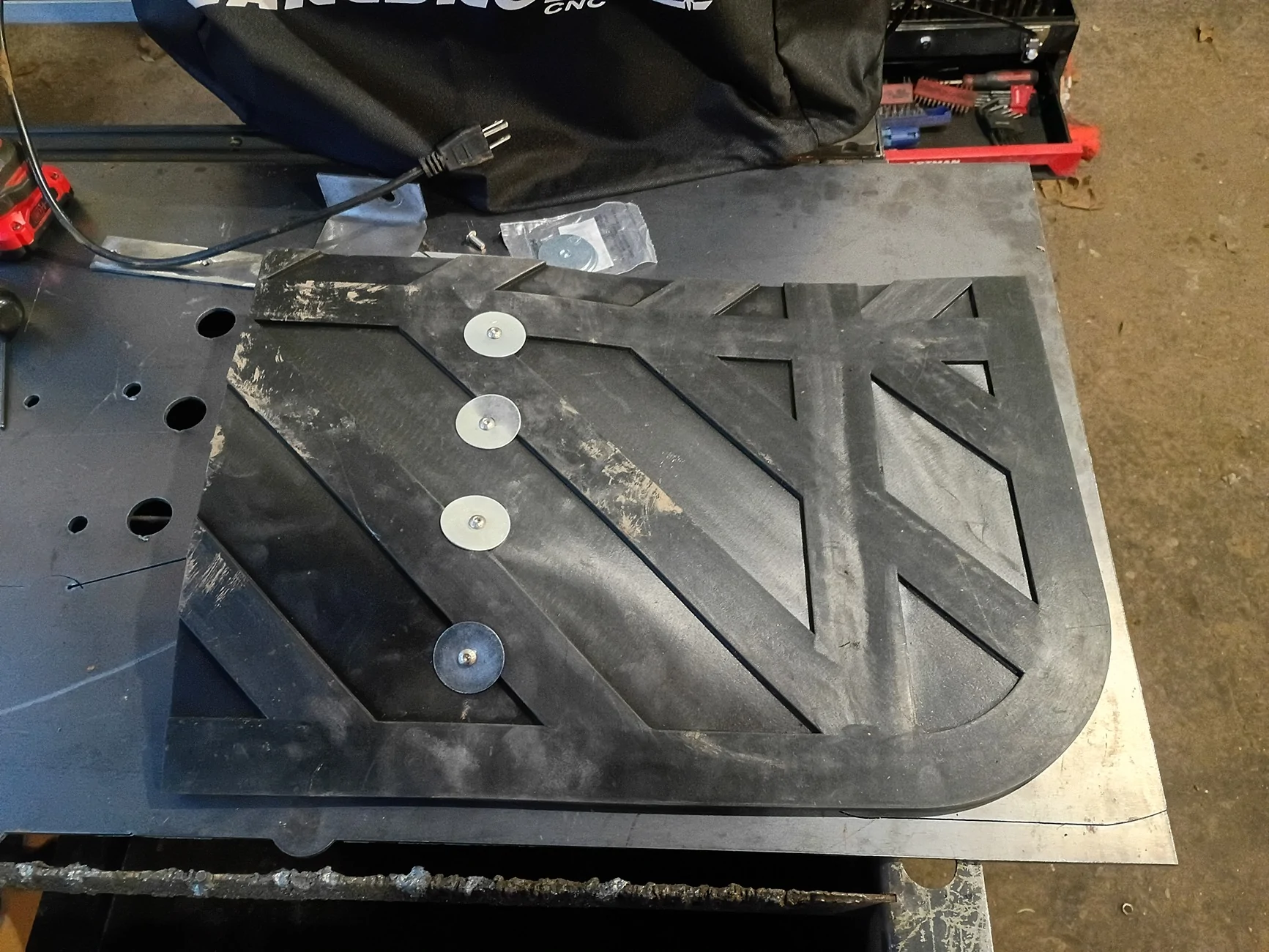

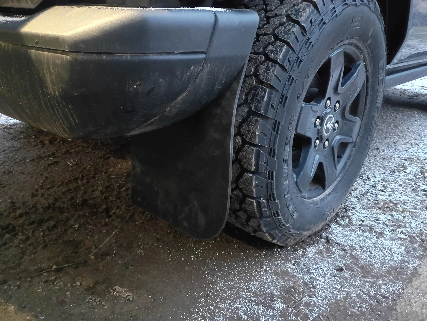

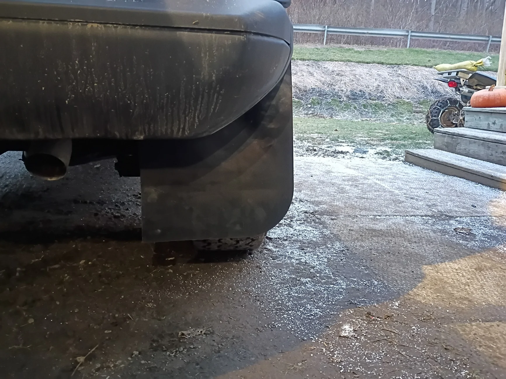

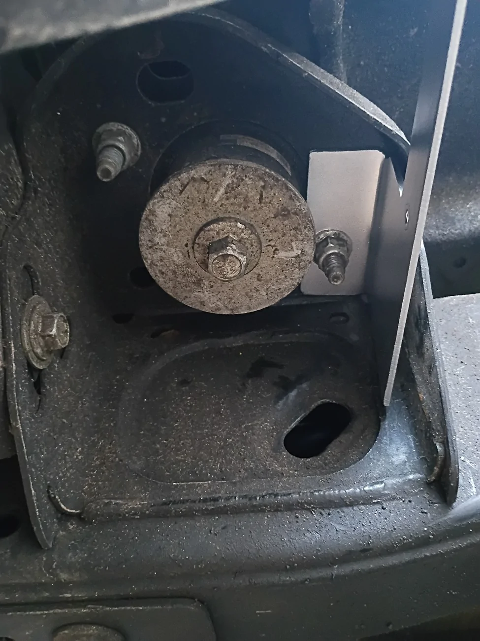

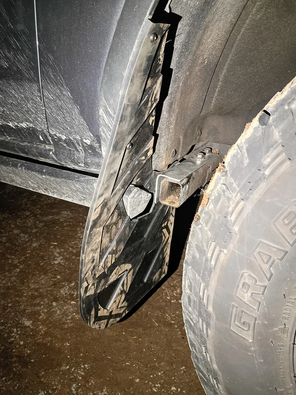

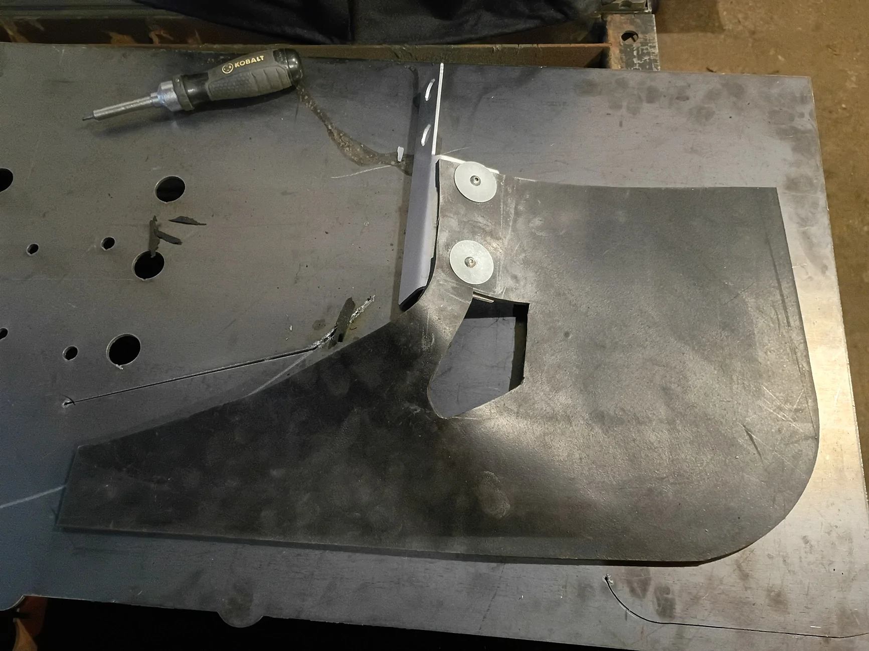

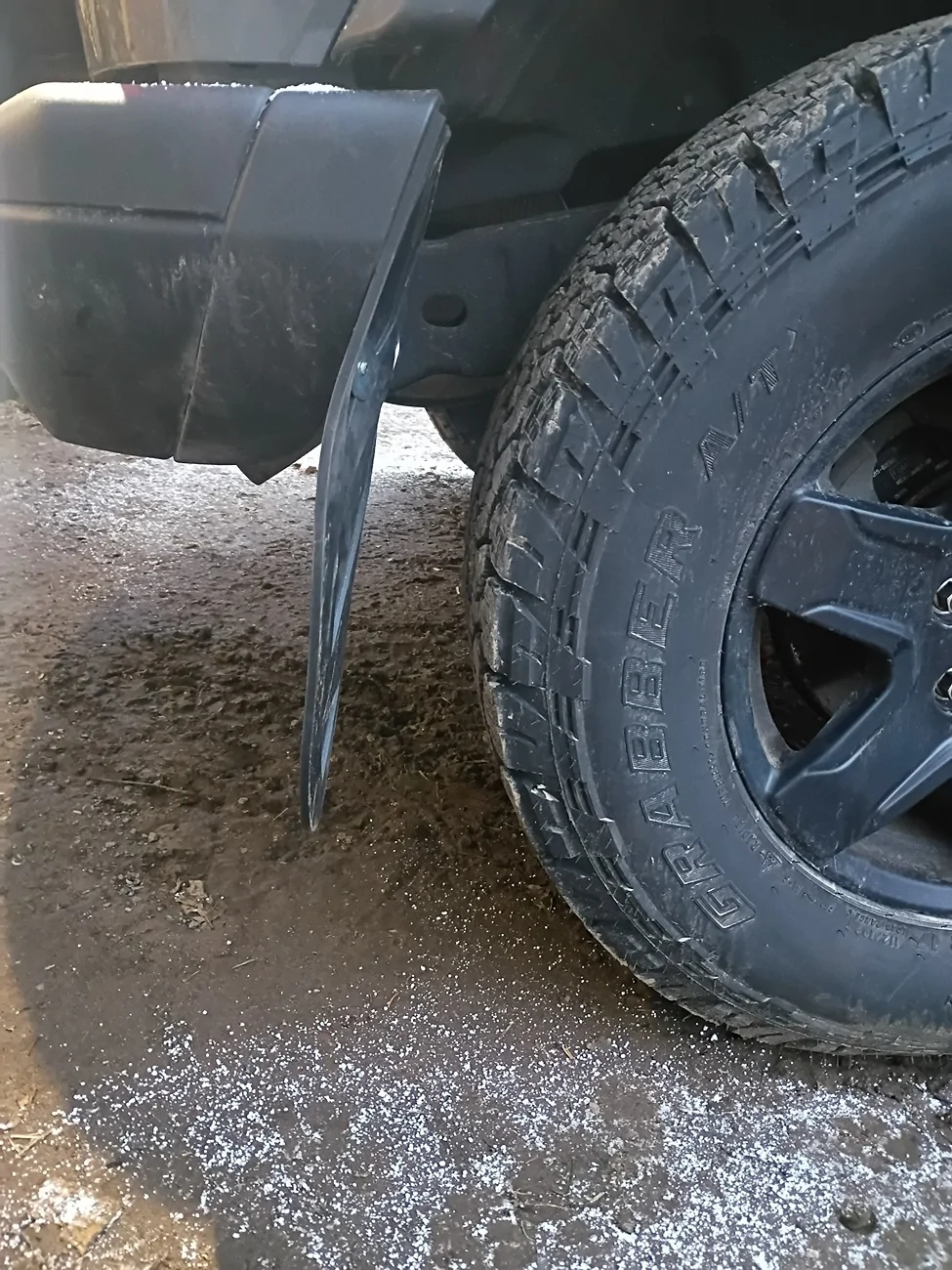

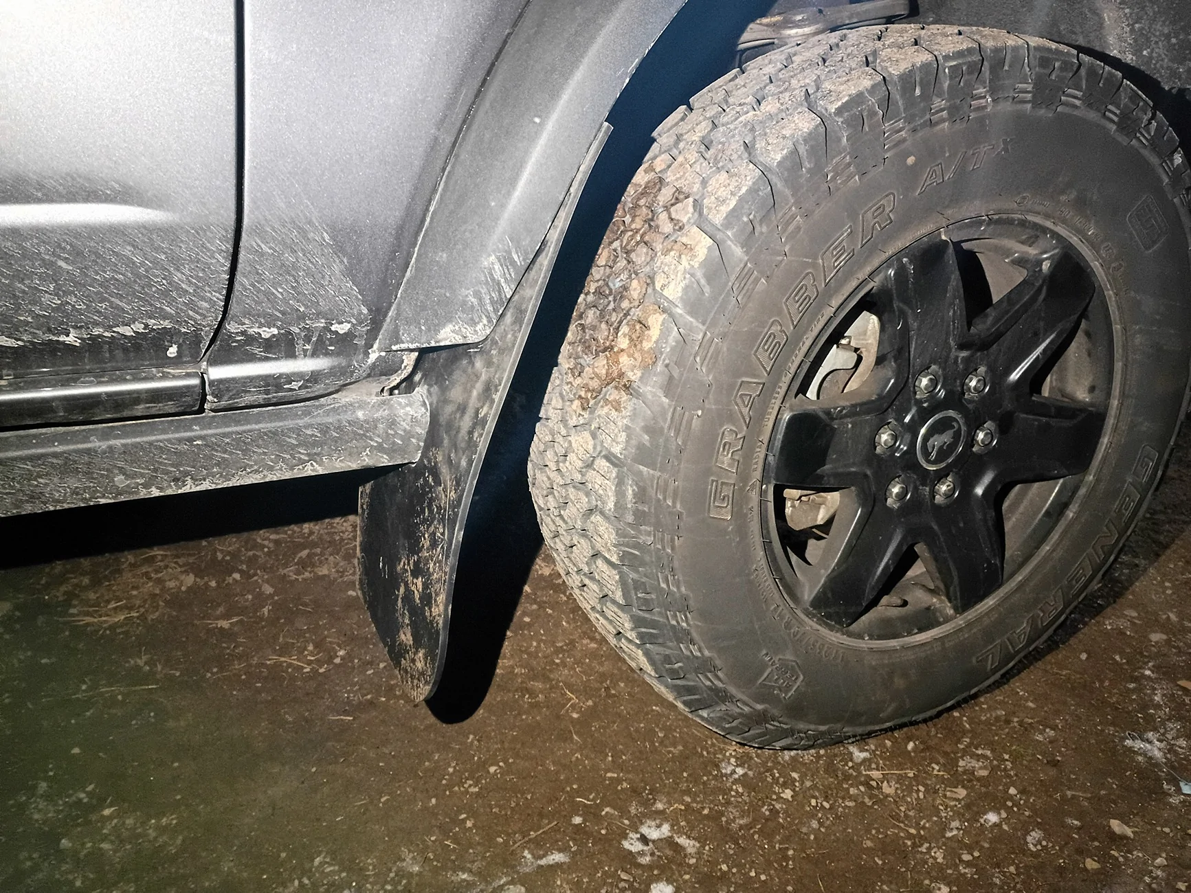

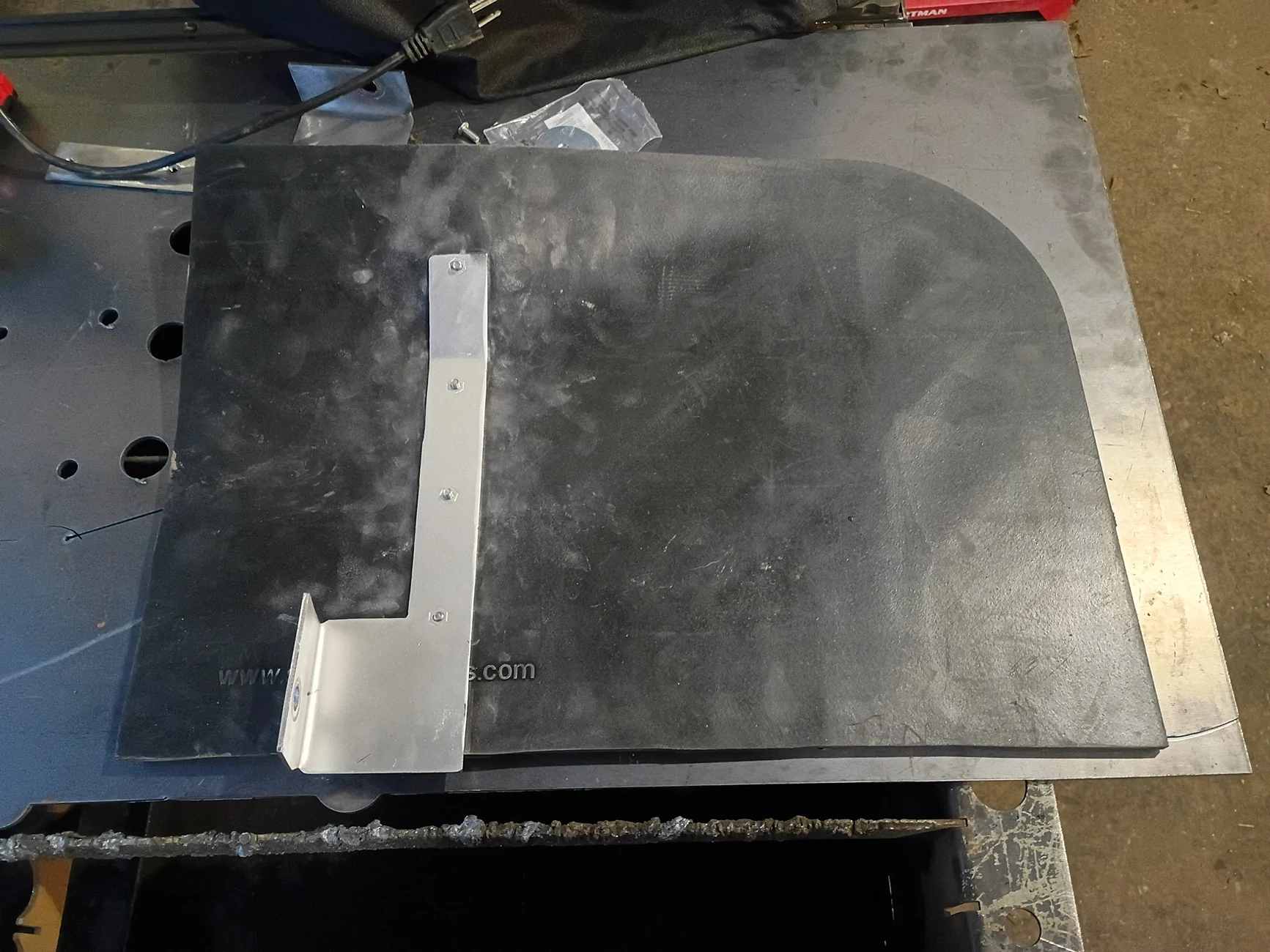

I built my own, because I wanted the flaps to be rubber, and be flexible, offer more coverage than most others, and be solidly mounted. I didn't want plastic or poly and I didn't want to drill into anything on the truck, though on the fronts I did have to screw into the fender flare with a pair of #8 screws.
The mudflap mounts use PEM nuts pressed into the mount, so no external nuts are necessary to hold the mudflap in place. The rear can be removed easily with one nut, the fronts just require removing the intrusion bar bolts, and the pair of small #8 screws at the fender flare.
