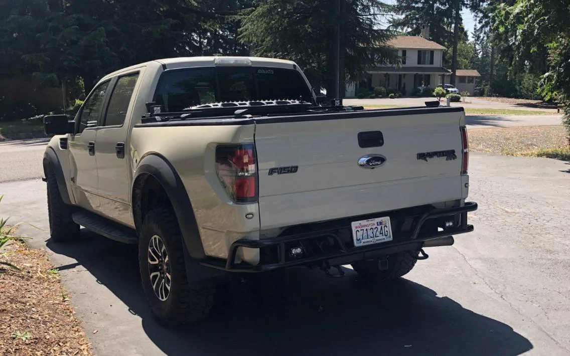

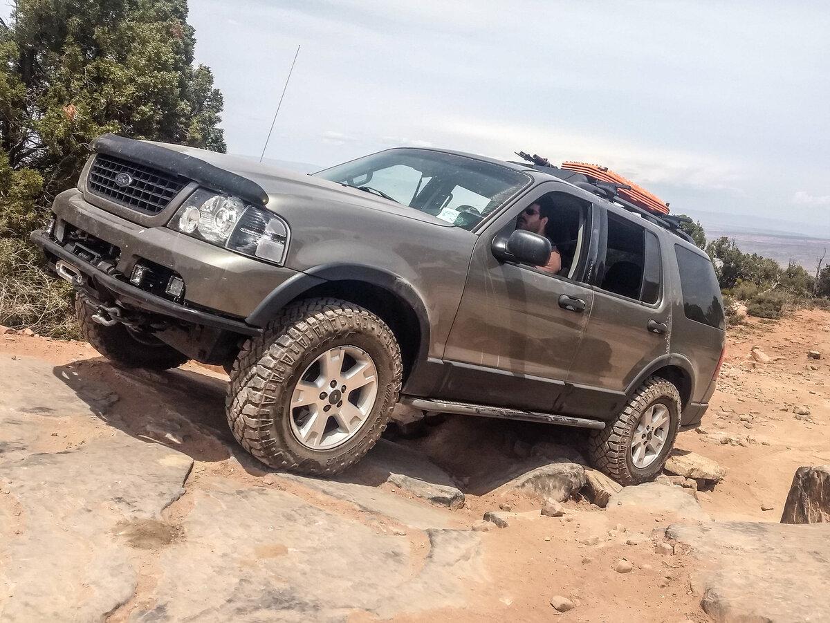

My main project was building my explorer for Moab (since the bronco was delayed so much)
and a rear bumper for my F150
