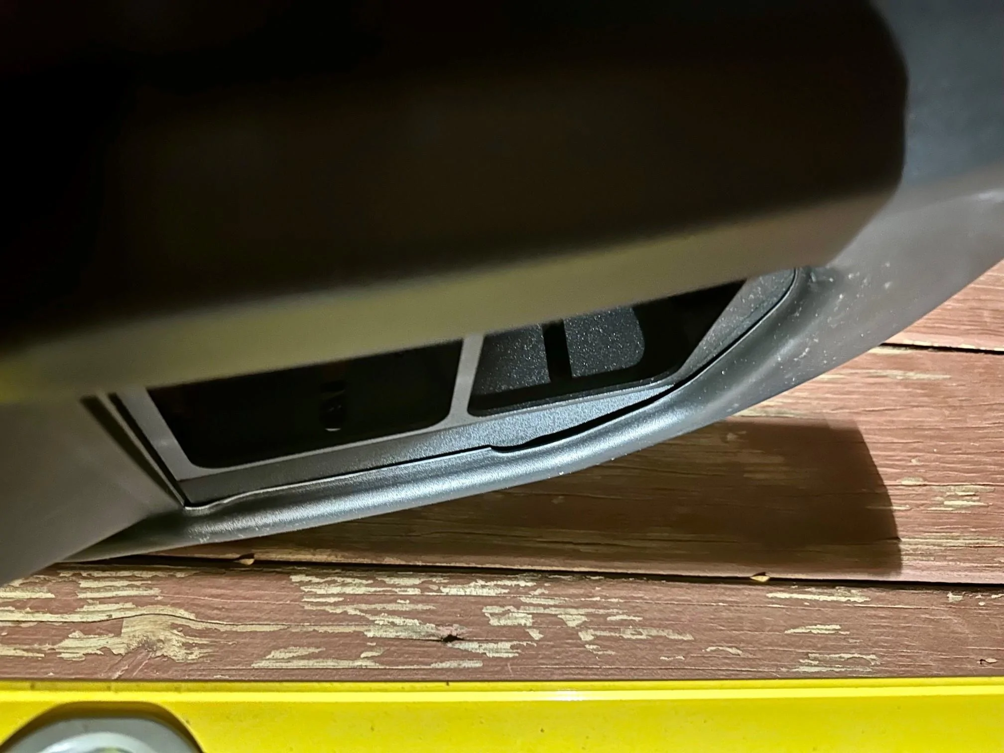

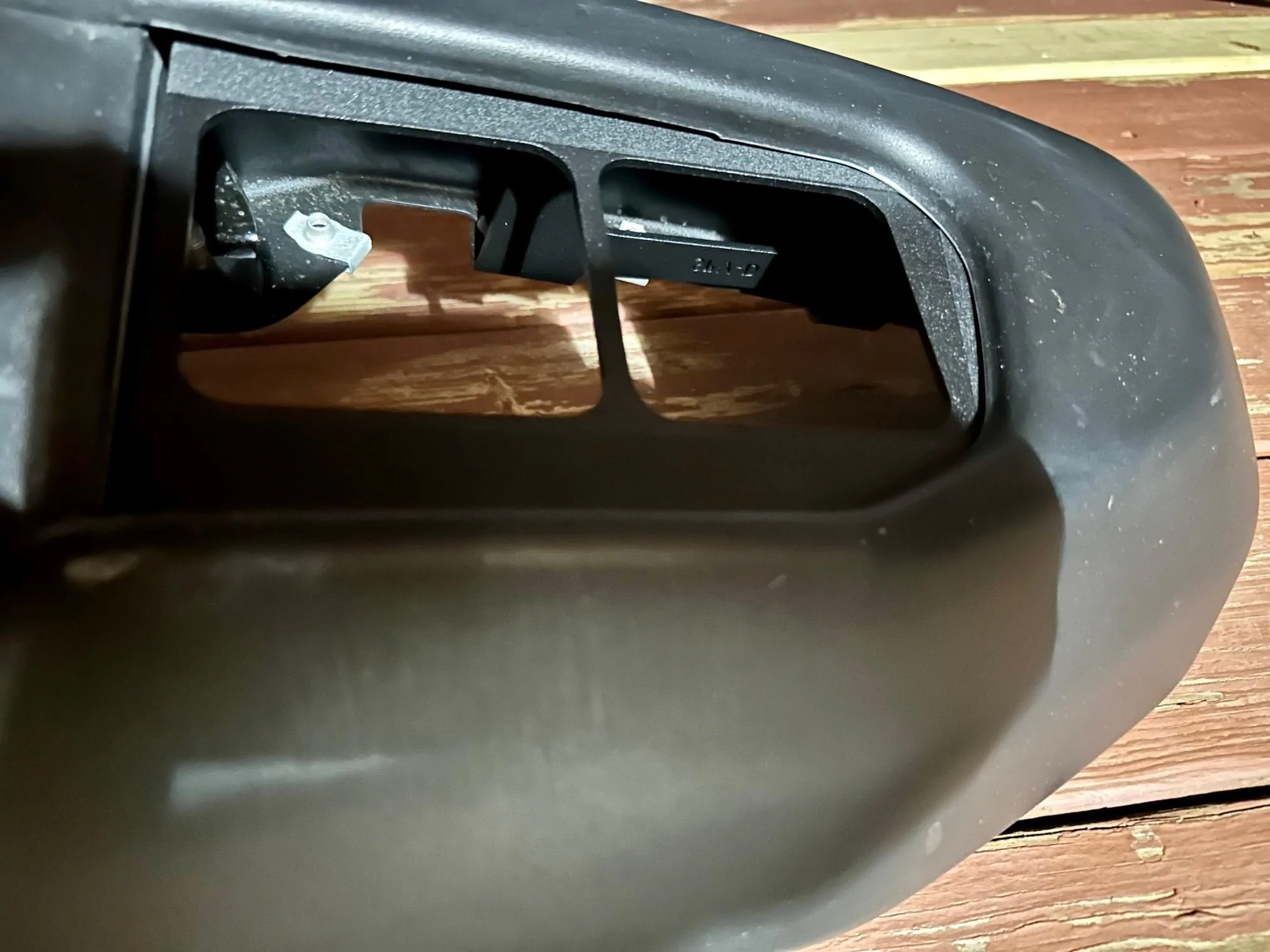

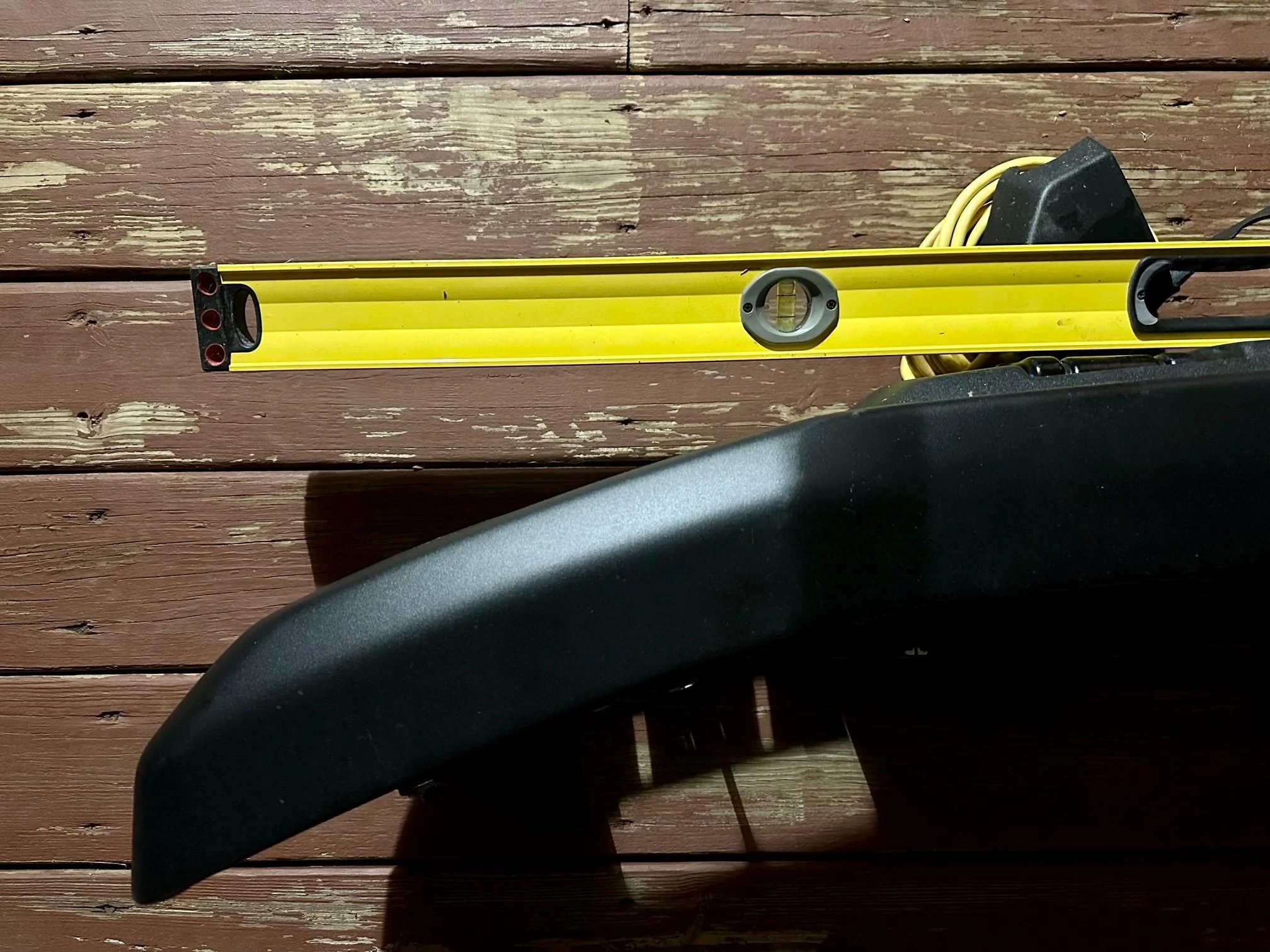

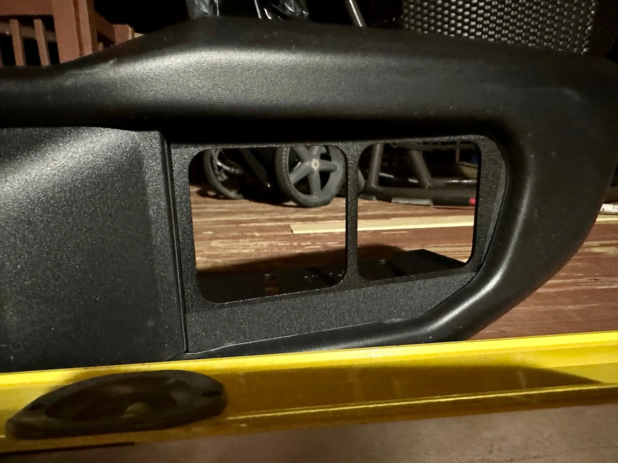

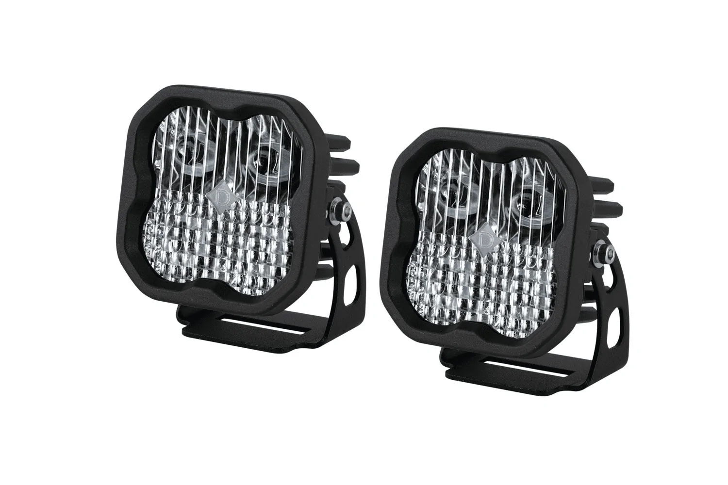

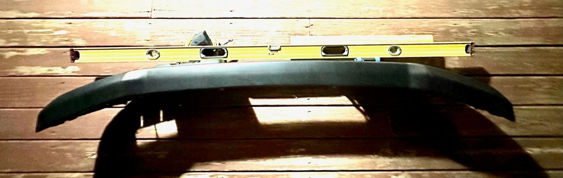

They will be. We are making some modified components for the Diode lights so they fit and position correctly. We didn't just want to throw them in there. There is "Fitting" and "Working". I prefer the best positioning and fitment when I design these things. One of the biggest things that drove me nuts, and I am sure others, are large gaps at the base where the brackets meet the bumper. It took me 4 weeks of prints to all but eliminate that.
You see, you are taking a flat piece of metal and trying to lay it over a hole that is curved on the edges. So there has to be a slight gap somewhere. The question is, would you rather have a tiny gap at the top, where you cant see it? or a big one at the bottom? Where every time you look at the bumper you see the inside/backside.
So again, the gap at the base is gone almost completely, and at the top there is maybe an 1/8 to 1/4 inch that you WONT see unless you are laying on your back on the ground directly under it, looking up.
So closing gaps is a big thing. Then with Diode, I am sure you've seen the base bracket. It bumps OUT as you see in the below picture. So if you can imagine sliding these lights FORWARD on a base slot on these brackets. When you turn them inward to face STRAIGHT, the Bracket hits the faceplate before you can angle it enough. Rigid and Baja Brackets don't do that. They put the light AHEAD of the U-Bracket.
That leaves either putting the light angled BEHIND the faceplate on one side and meeting it on the other. Or, bringing the whole light forward and flush to the faceplate but angled OUTWARD.
Again, Rigid and Baja's brackets aren't restrictive like that.
For that reason, I am working on a stand alone bracket to REPLACE Diodes U-Bracket so we can bring them forward and straight and fill gaps. So that is coming soon.
These other pictures may illustrate more.
This first picture illustrates what I was saying that the bumpers are NOT Straight. Not even close. Though they may seem more straight on the truck. You can see what I mean with this big level.
This next picture is a close up showing ever more how ANGLED these are on the corners where the fog pockets are. So imagine the angle needed to focus a light forward correctly and going back to those standard Diode U Mounts that come too far forward. to swivel them when they bump into the face plate. Now, this isn't Diodes fault. They hadn't probably ever planned on this type of situation. I think their design was just trying to evenly distribute the weight with the base.
This next picture shows how I was able to almost COMPLETELY eliminate any gaps between the bracket and the bumper. Let me tell you, it wasn't easy. Angle adjustments from 4 points. Print after print... Like I was saying though. Ford didnt give us a FLAT edge opening. This is pressed and formed steel.
The next picture shows a front view. (BTW, those strips on there that look even more matte are tesa tape just to keep scuffs off. The brackets are the same clean texture.
This photo shows how clean the brackets fit in there.
This last picture shows from an UNDER view looking STRAIGHT UP. As you see, there is a tiny gap at the top that you will never see. I compensated the angles of the face to close the gap at the bottom that you WOULD see with a little lift here, drop there, etc. It was nerve racking! The end results though are what I personally would want and expect when spending money on a product like this. It's about the quality to me, not the quantity. Of course, sometimes it takes me a little longer to get something out than others, but I prefer to make those special touches to be sure what I put out is the BEST.
So after seeing these close ups and details, hopefully it explains why I feel a replacement Diode bracket is needed to properly fit and align these and it will be coming very very soon. I wanted to have the METAL ones here that I could use as the base to design those Diode ones vs the Plastic which is flexible. I should have some updated pictures soon.
