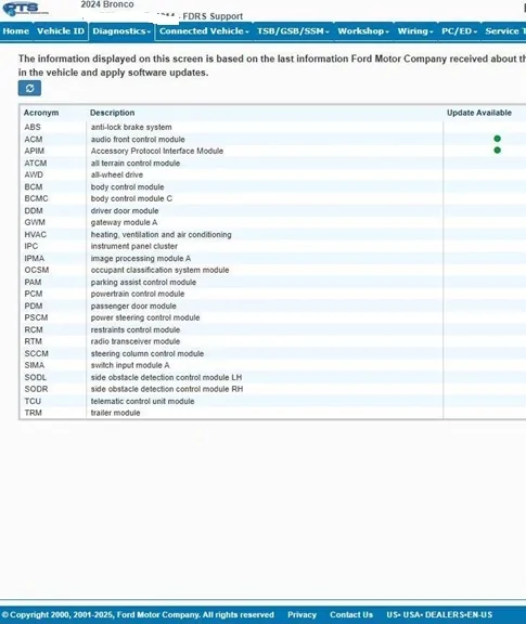

A member on this site checked FDRS if I had any updates pending and he sent me this screen shot.
When I mentioned that I haven't gotten the updates pending, the following was his response.
Just because an update is pending doesn't mean you can initiate the install. It has to be sent from the server and that happens at random. The dealer can do them with FDRS, but they won't because Ford does not pay them to update modules just because they are out of date. You just have to wait for the OTA to come in.

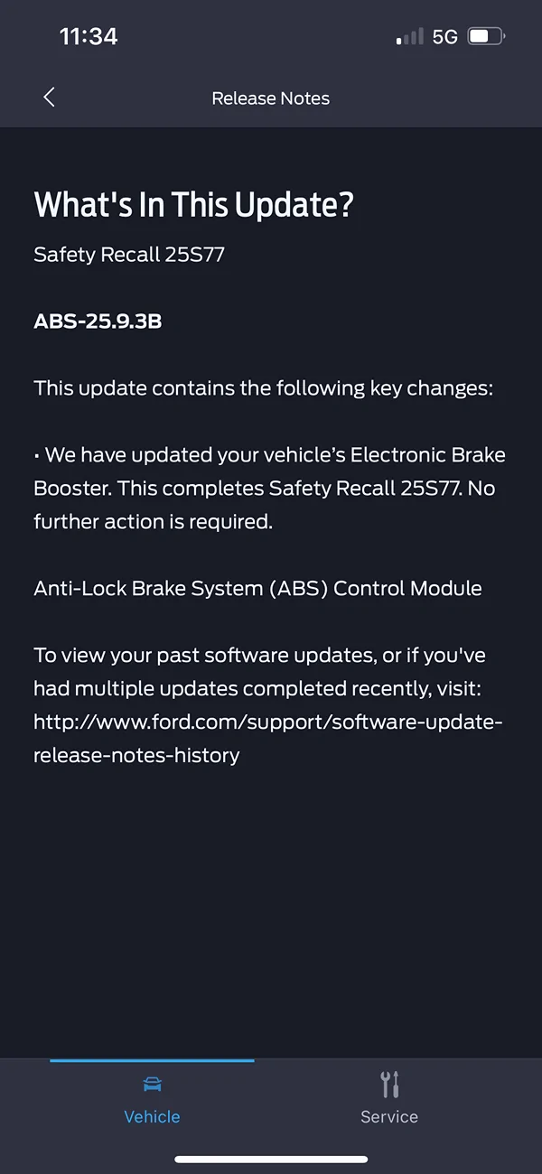

I got the brake booster update yesterday. Anyone else?
