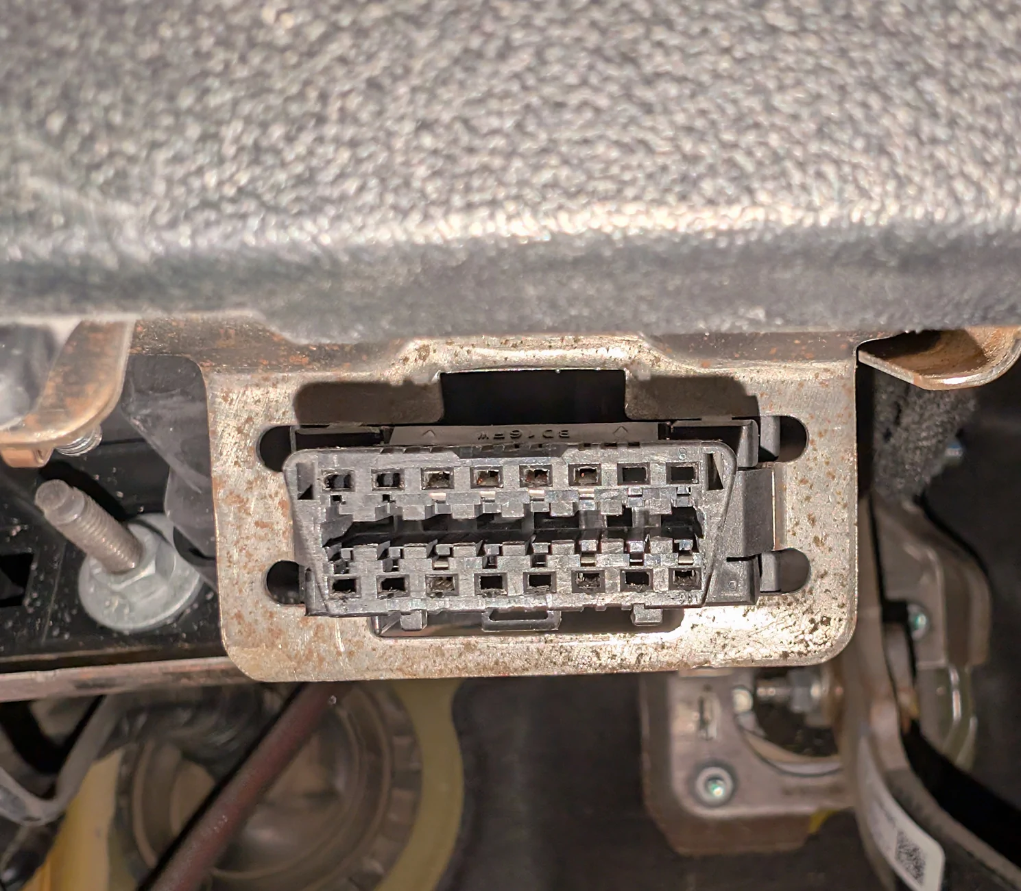

I'm guessing it's a fuse issue, but I've got no power at the port.
I didn't see a fuse specifically for the port in the manual and no mentions of the port not working for others on here.
Y'all know which fuse I should check?
The pins and connectors all look good. The Procal device works via USB on the PC and the Ethernet port on it looks good.

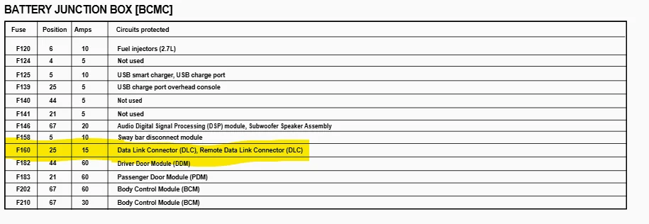

F160 in the Battery Junction Box. You couldn't find it because Ford doesn't call it a ODBII port in their documentation.

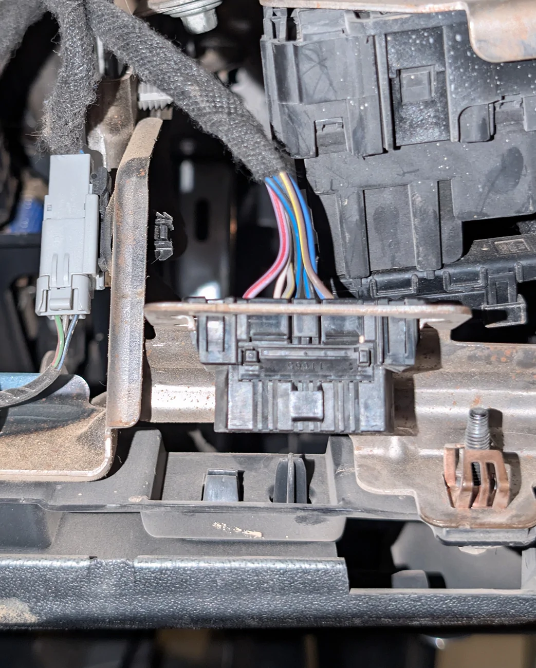

If you bought it used, check that the plug and wires are actually the vehicles plug. Could be an aftermarket pigtail from previous owners aftermarket equipment like a tracker that is totally disconnected from vehicle. I bought a used ‘21 and that’s what I encountered. Found the actual OBD2 port wire plug was tucked up under dash.

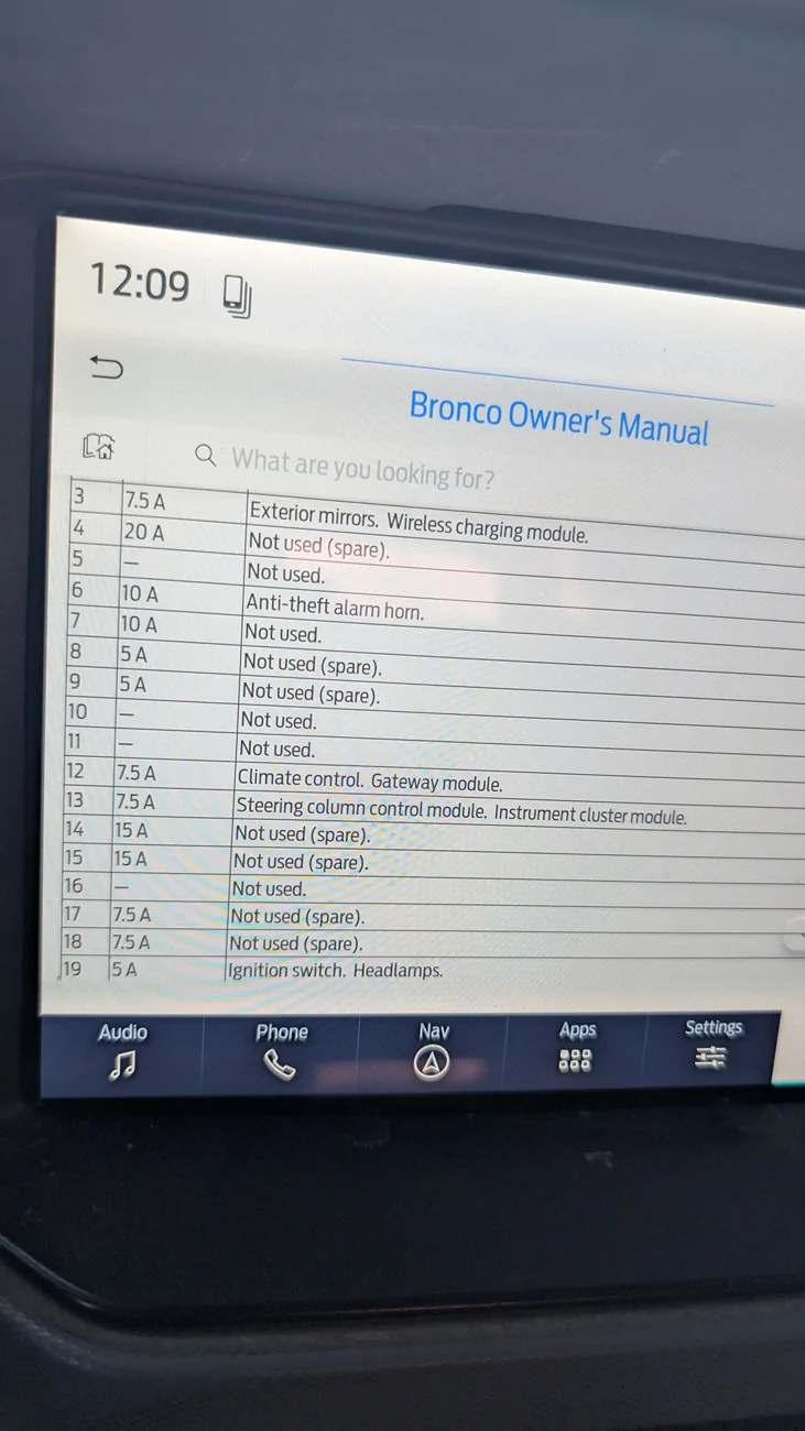

Lol, the fuses from the auto store don't fit and are a touch too big.
All I wanted to do was check my tune and reflash it if needed 😂
I'll find some proper ones online for it.
Hopefully that's all it is, the fuse has some heat damage on the pins but doesn't necessarily look blown. Will update in a few days when I've got replacements.
Edit: I'll borrow one from a different spot to test it.

The port itself looks fine, I did spray it with some air, the pins look good from what I can tell.
It won't activate an OBDII scanner or Procal.
Hmmm. I'll check another scanner tomorrow.
