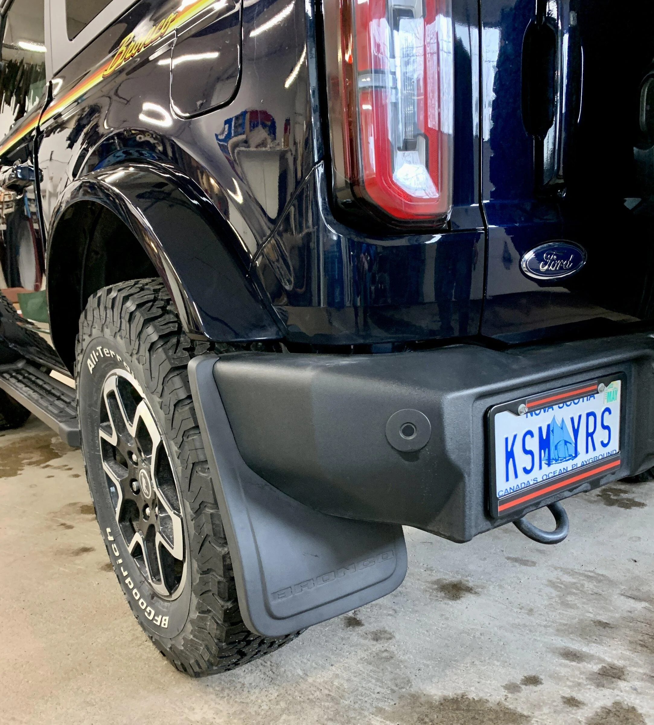

I kept stock OBX and mounted 275/70/18 KO2's. You need mud flaps to address rock/debris issue. On 17 inch rims you can go to 285/70/17 KO2's with no mods (lift and/or crash bar removal). My 2 cents. JCG

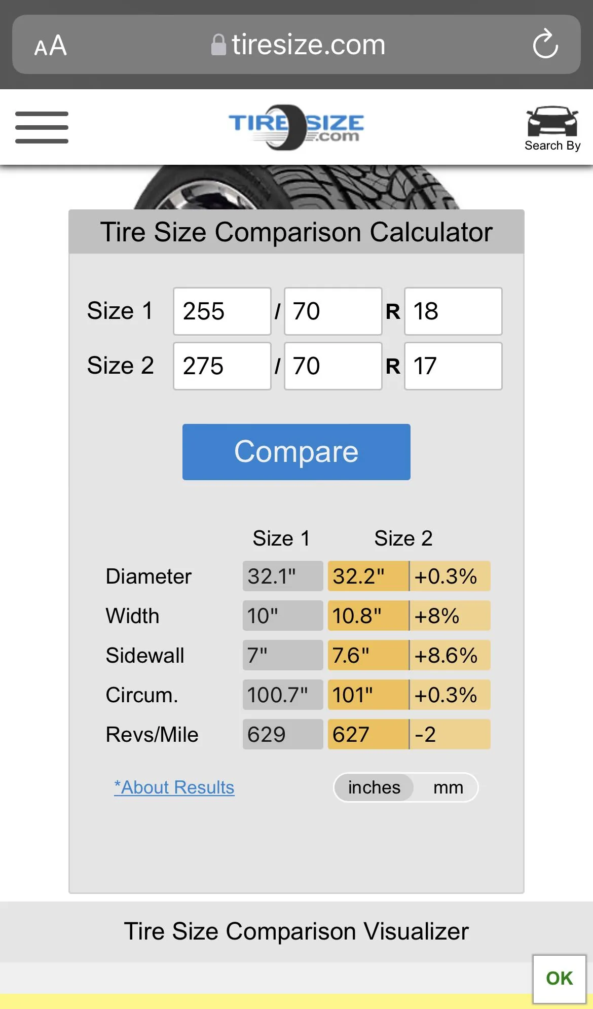

Since the rim is smaller, your 275s are actually almost the exact diameter of the stock tires. So you could actually do a larger tire. I’m not sure how offset is going to play with the suspension components, but in terms of overall diameter you could handle 285/70/17
Ford Bronco OBX tire suggestion/confirmation please B8F099DB-D4FE-498A-81D6-4005DF17F560
Those looks good. Wish I could have the AMB. Anyway…did you just do the mud flaps on the rear? I kno there’s some issues with getting them on around the side step.

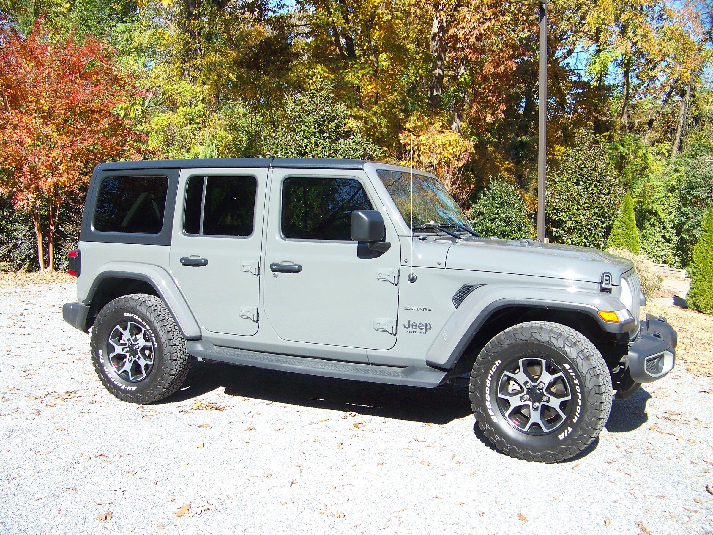

Just some food for thought. I lost 2 mpg with my 3.6L Jeep when I went to 285's. They look great, but them suckers are heavy.
Ford Bronco OBX tire suggestion/confirmation please 100_5384.JPG
