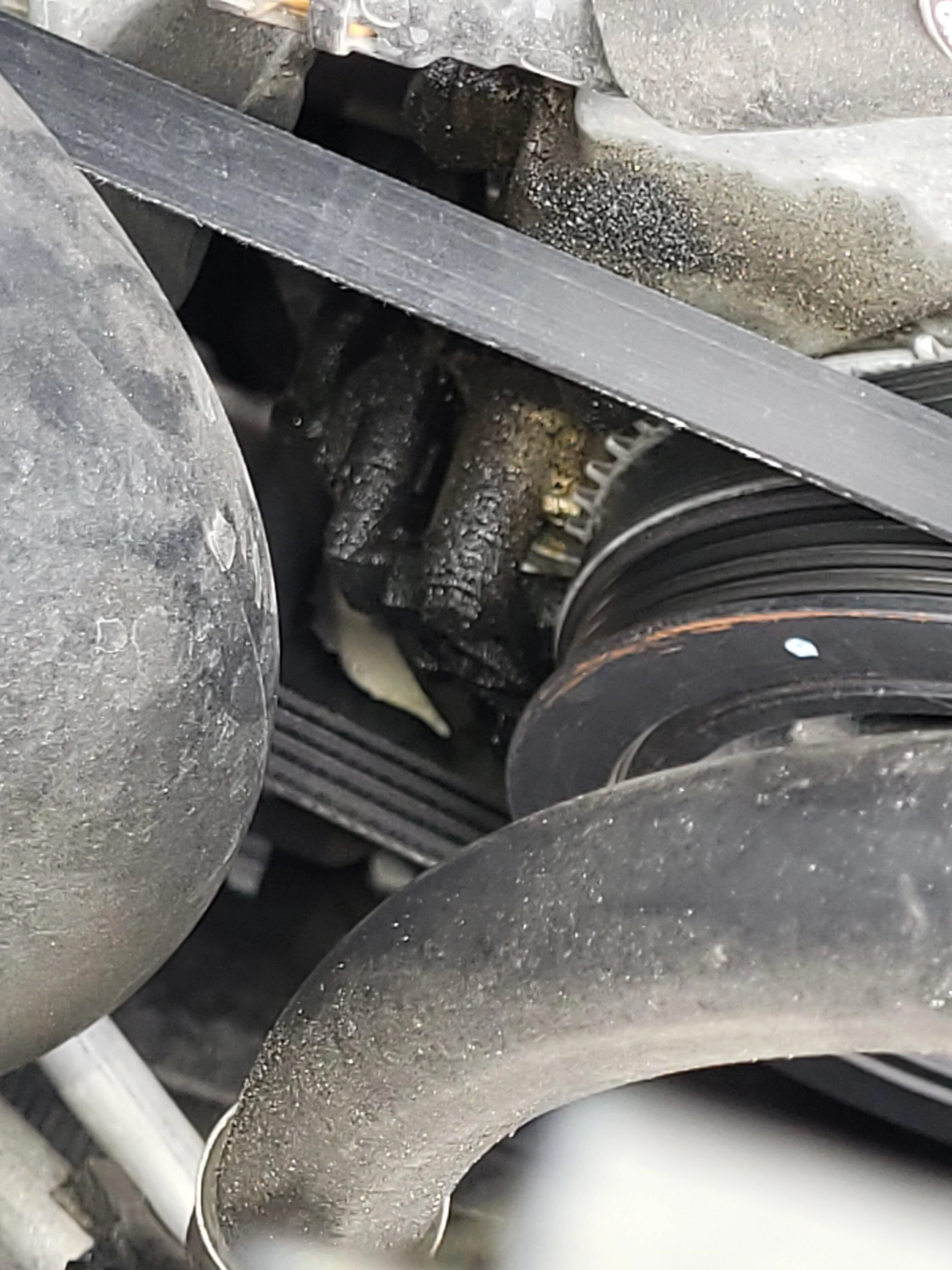

Noticing a little oil buildup on the front of my engine. At 20k and just had the maintenance done about 500 miles ago. It's not a whole lot, but should there really be any? 🤷

Hard to tell but it looks like it’s seeping from the front cover. Pretty typical for most Ford 4 cylinders to start leaking eventually in that bottom left corner. Luckily it’s an easy repair.

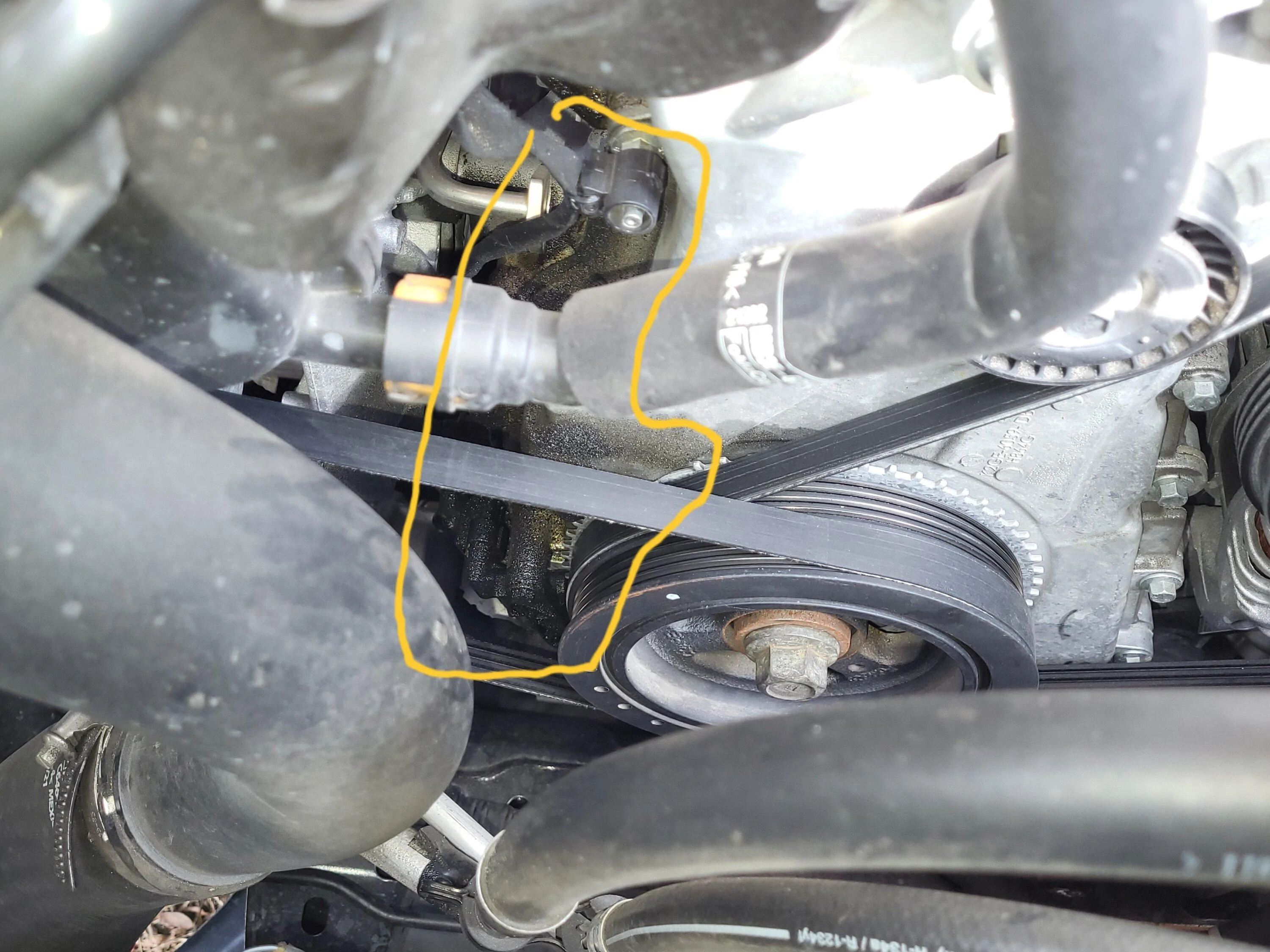

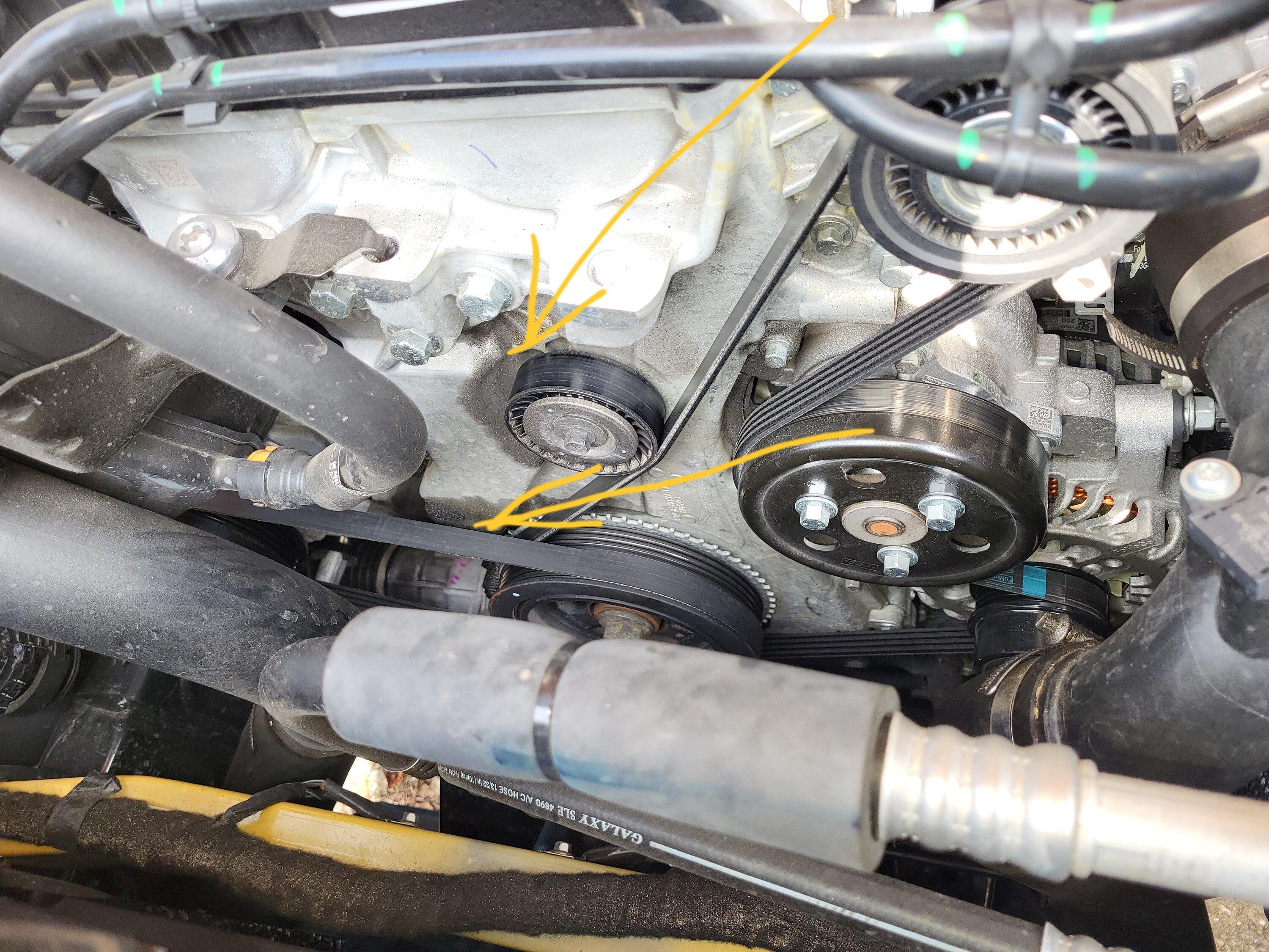

I have the same thing coming from behind that idler pulley. I'll have to take a look at the lower part now.
