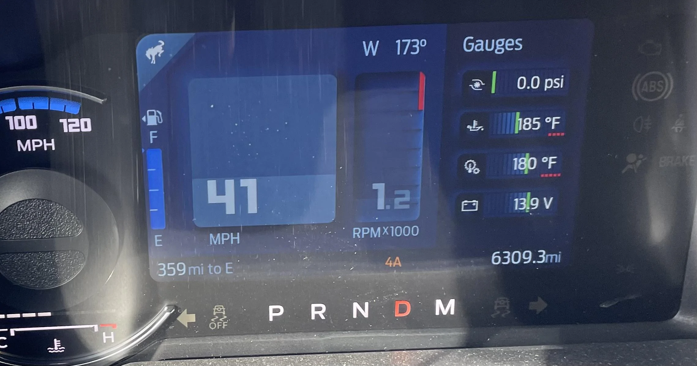

My display of outside temps has always been several degrees off. Today, whole new level…. Anyone seen this? It was 20f outside.

Happened to me on a previous F150. Dealer replaced the sensor.
Yup, there are a few of us. They initially found a loose plug and thought they fixed it.... Nope.
Next service visit, they tore into it and found the sensor "had a chip outta it". No parts in Canada... Waiting for it to arrive. Currently on week 2.
Oh, and it'll f*ck up your HVAC, heads up. 👍🏻

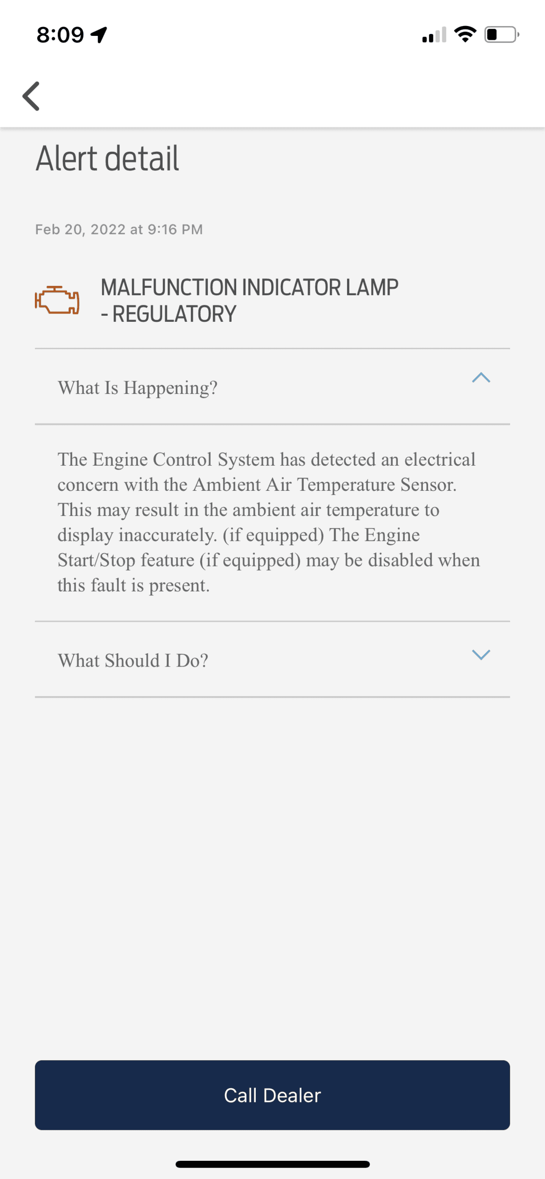

Damn…. Just drove again and now my check engine light is on. Will post back in a few days once I get it looked at.

Just had my driver side mirror replaced due to this issue. Last Thursday. Ambient temp sensor is in driver mirror.

I now see this in my Ford app…

Happened to me today. 90 degrees when 25... Two weeks till I can get it into the dealer though.

Mine bit the dust today too. Showed 100 degrees but outside temp was 25. Seems very odd they are all dying all of the sudden. Mine just did an update on the software, maybe coincidence
