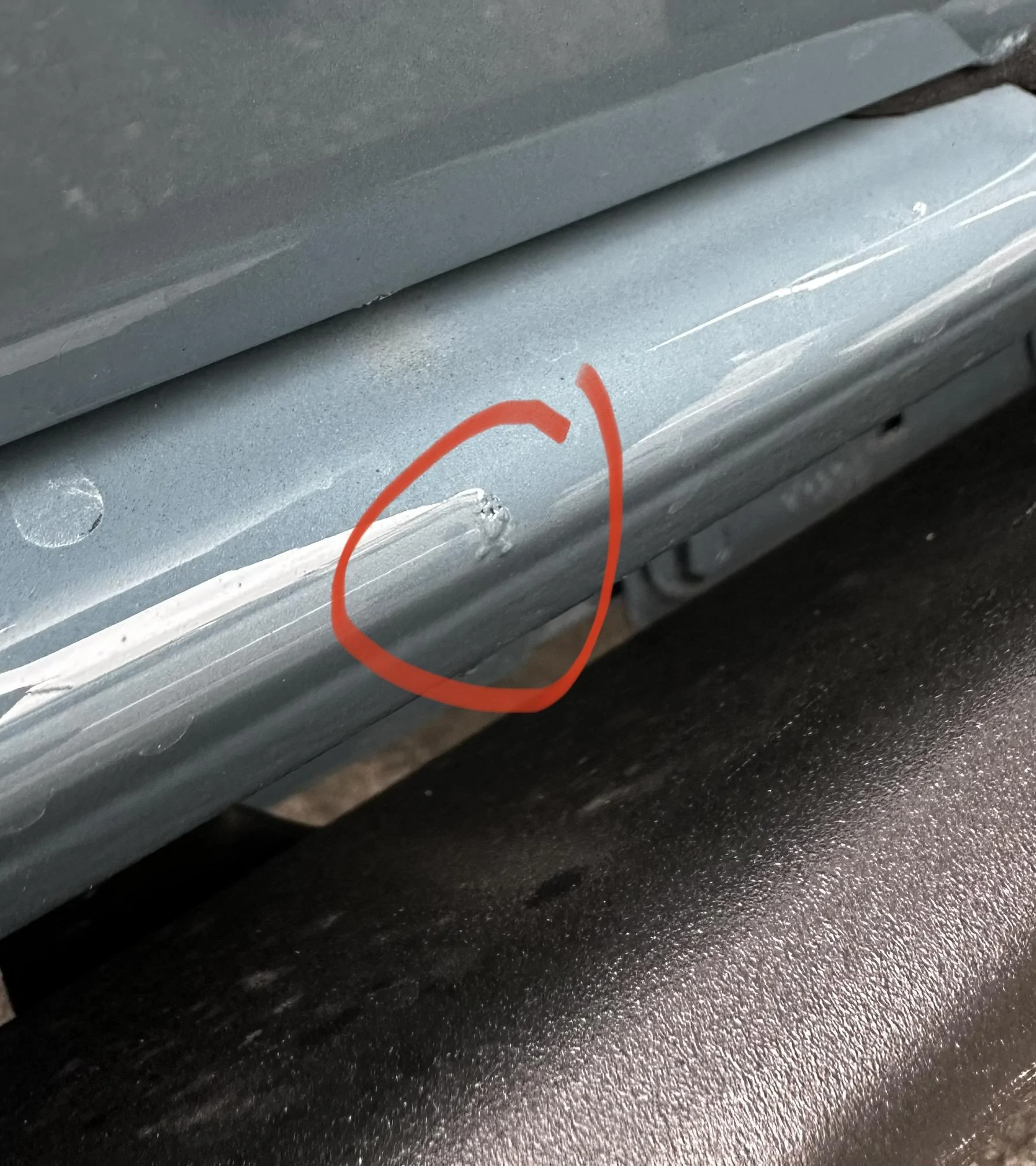

Anyone else notice bubbling like this in their rigs? Take a close look around. Not sure if it’s rust or run off.

Looks like sealer under the paint.

I have an eye for paint defects after spending the last 20 years of my career in the Automotive Collision industry. I’ve taken a very close look at mine and my Eruption Green Bronco had just some minor issues with the metal flake orientation and a dozen small dirt nibs that were easily corrected with a DA sander and some compound/polish.
Those defects on your should never get past QC and the dealer will have to make it right by sending it to a body shop if they don’t have one of their own. I assume you noticed these right when you took delivery or shortly after.

right after delivery of course. Leaving that untouched will that cause major issues down the road. If I were to keep the truck 10 years that is

Looks like dirt/contamination under the paint. Long term, it could be a potential for rust. I would get it fixed.

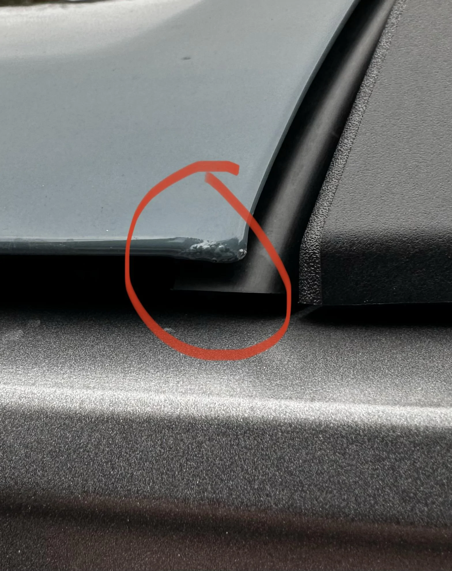

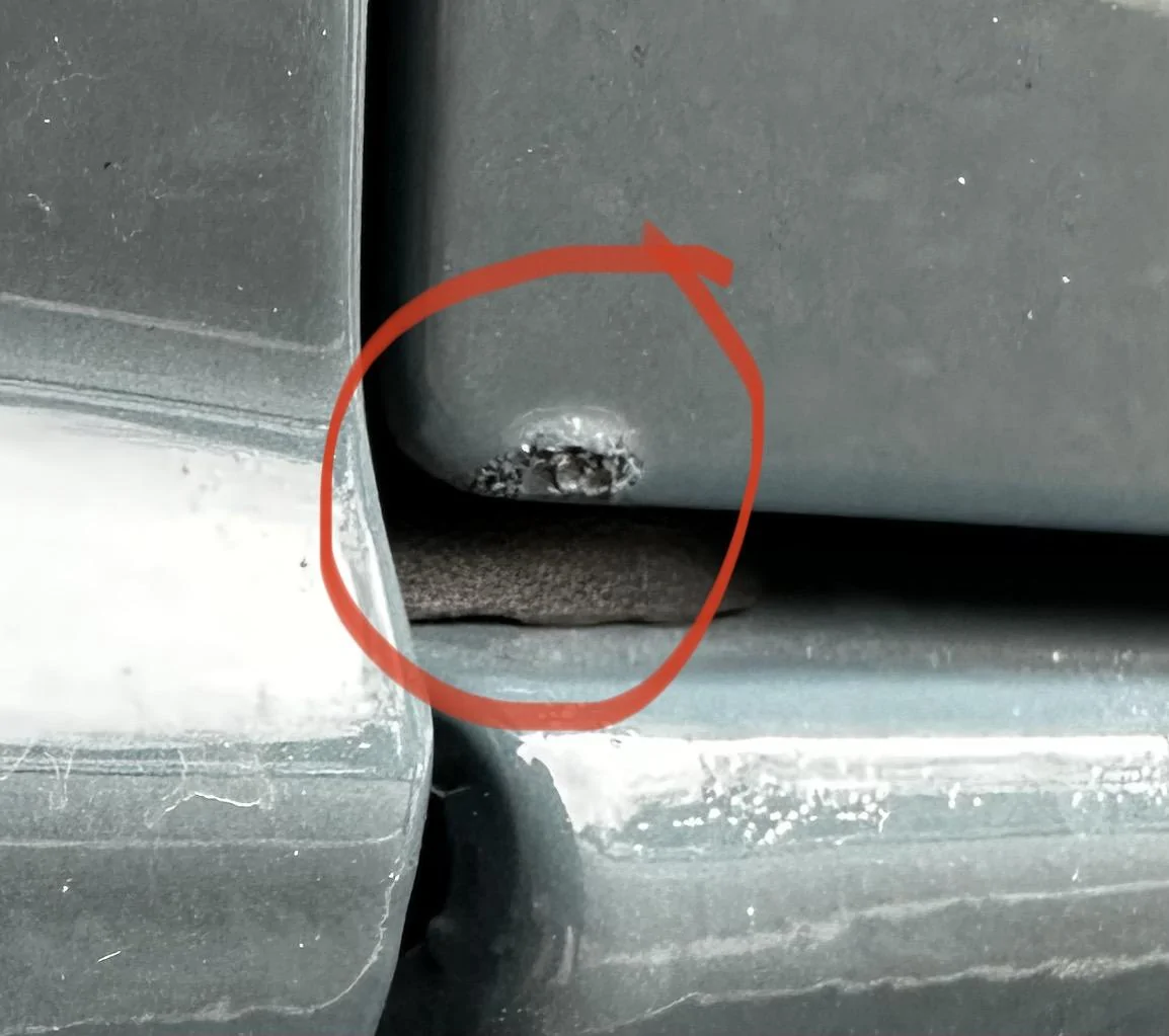

2 of those spots are on corners of class A metal that has been hemmed. Along any hem we apply a sealer, and if there is too much applied it leaks out of the seams, especially corners. It should have been caught in the paint dpt. before the prime booth.
