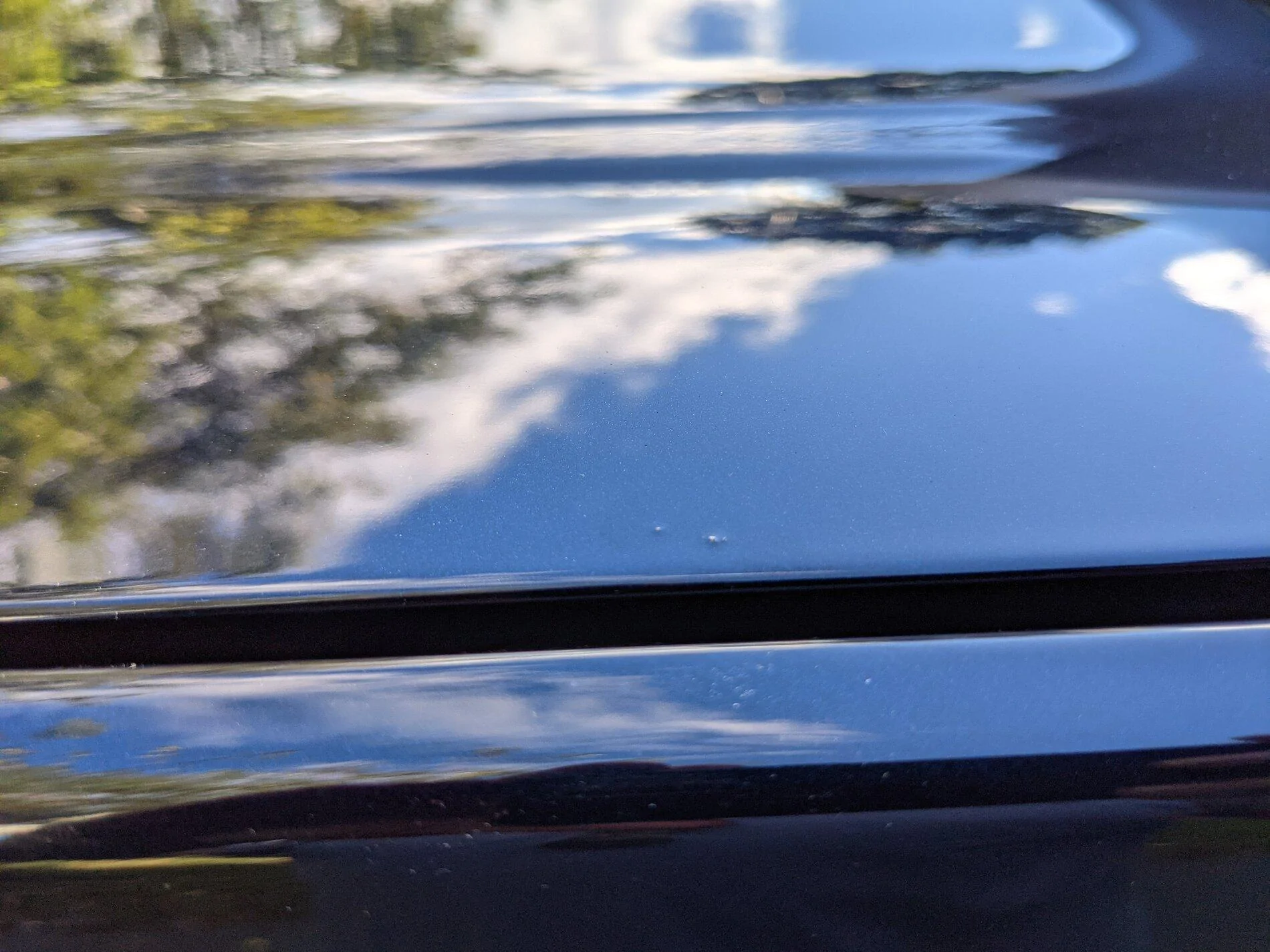

Hey all, i thought this is worth a mention and for others to be aware of.
I picked up my Antimatter Outer Banks yesterday, quite excited as you can imagine after all the issues. It looks great. However, while at the dealer i noticed a small dent on the back panel, turns out its a paint defect under the clear coat. Then i notice another on the drivers door, this is a raised nick, then i get it home and notice 2 clear coat issues on the hood. The dealers response was to put it in the body shop for repair, this is brand new! Im so dissapointed at Fords factory quality control, Im having to deal with this issue instead of the defected panels being rejected before install.
Has anyone else had any similar issues? Please check your vehicle over in detail when you pick it up. These paint defects on the brand new high profile and expensive vehicle is just insane.
Updates to follow.

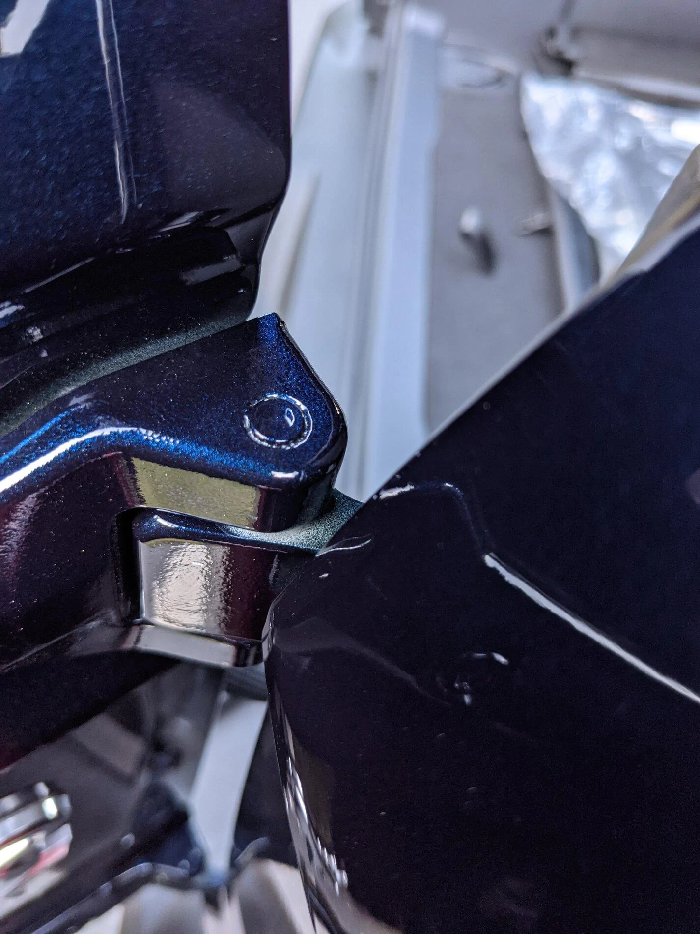

Sorry that you had this issue. My Bronco arrived at the dealer 9/24 and their inspection found a slight gap in the paint where the tailgate hinge meets the tailgate. The hinge is attached before paint and if they don't do a good job, you may see a very thin line of unpainted tailgate where they meet. They said 99% of people would probably not notice it, but their QC did - which is nice. It went to paint and body and they have taken a week to remove the tailgate and hinges and the redo both entirely. Waiting an extra week has been hard, but worth it. I hope that your defects can be corrected too.

Im glad that your dealer caught the issue, mine had no idea what was going on. Im going to check the hinge area now, thanks for the heads up.

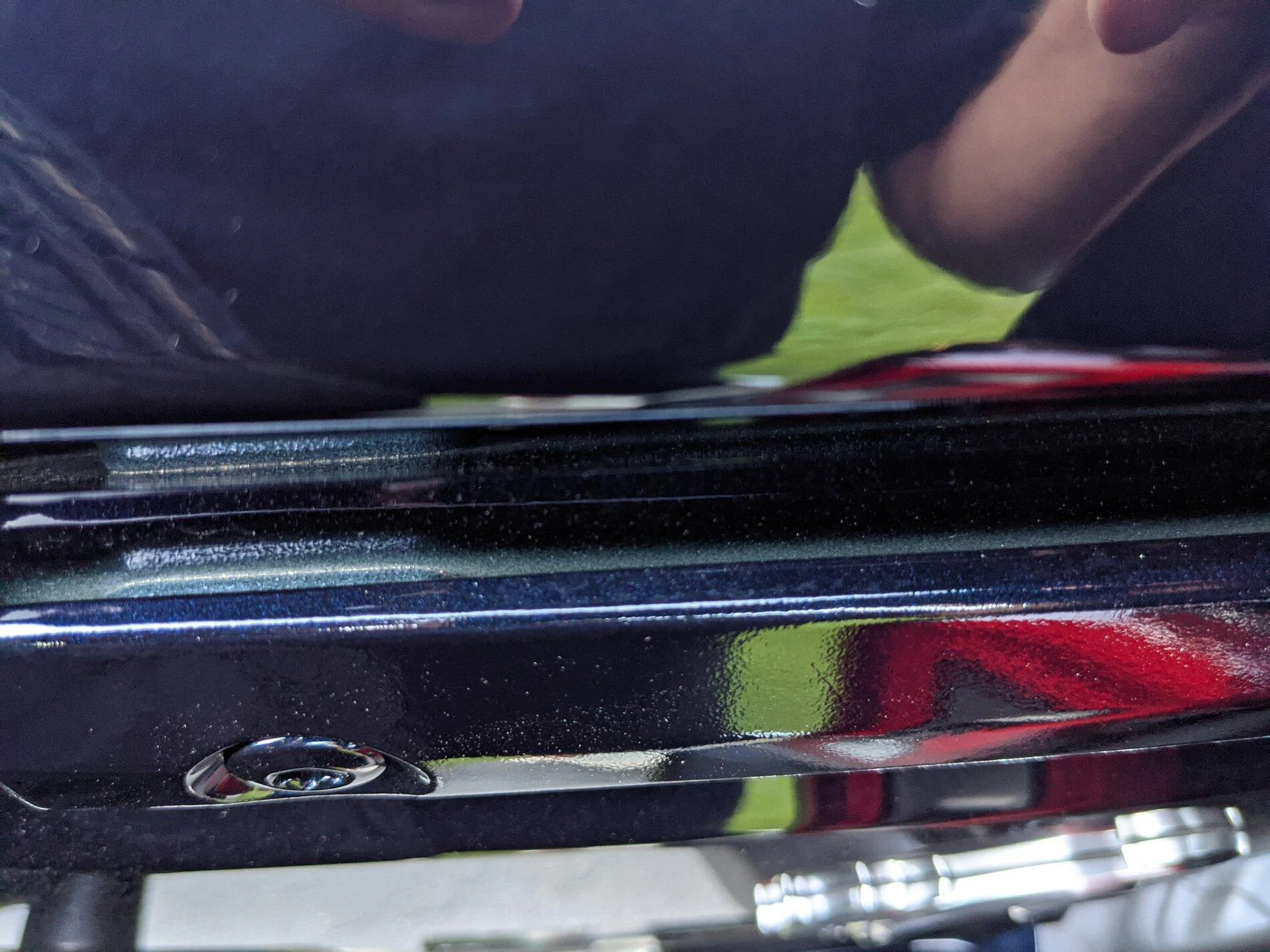

I have some update on this. JaxGtc mentioned his rear door hinge paint issue, i checked and i have the same issue. Primer but no color around the hinge area. Shocking. My dealer said they will fix everything and i will never notice, which i appreciate.
What pisses me off, is that Ford must have seen my paint issues effecting 4 different body panels and let it pass inspection, they passed the problem to the dealer and customer to solve. Im really disappointed and its taken the shine off my new toy.

Do you have pictures of this hing/tailgate issue so others can see if theirs has it?

Here are some pics that people have asked for. The issues look alot worse in real life. These are only of the hinge.
