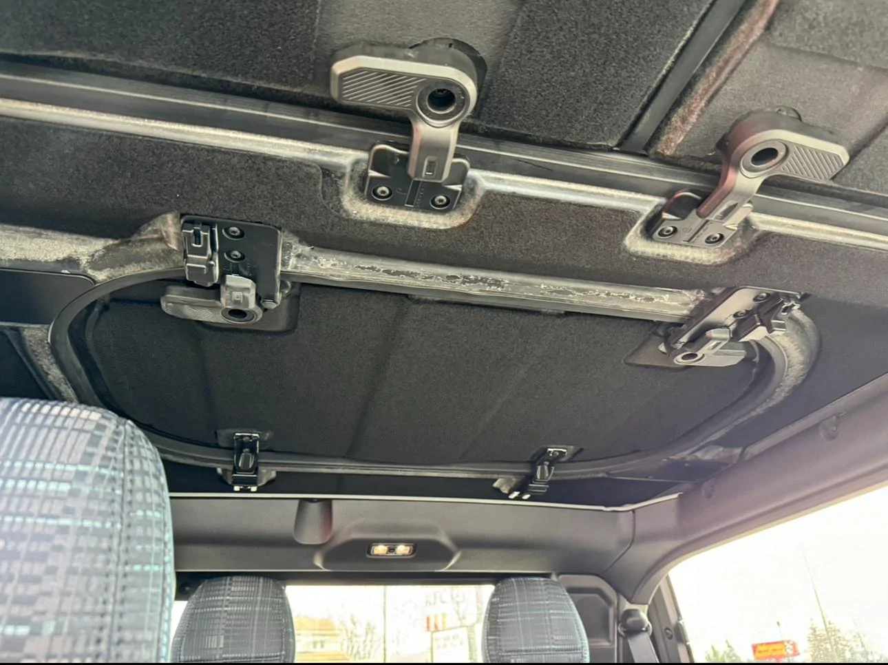

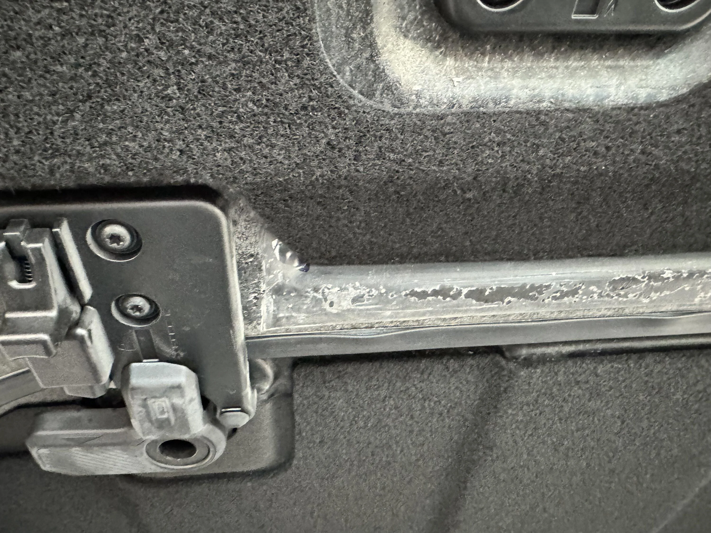

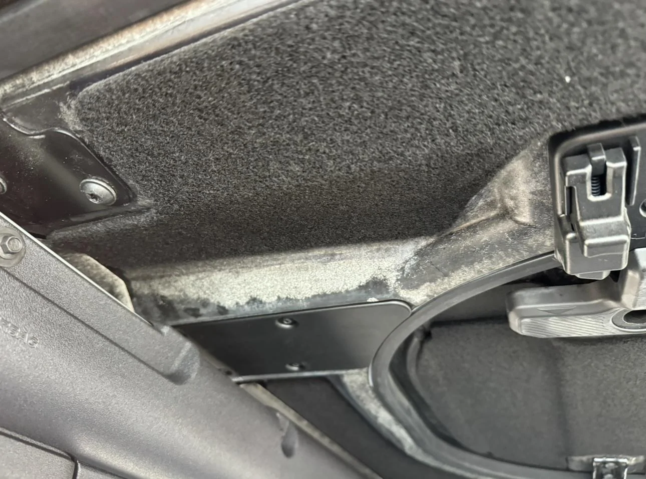

Noticed the hardtop on the Heritage has a bad finish. The way I would describe it is that it’s like super glue was put on the surface. And it was left in the sun.
Other than that, the vehicle is great, but it’s just a bummer the roof looks like this. Makes me wonder, what does it look like in the sections covered up by materials? Is this covered by warranty?

IMO the MOD top interior finish is the same as the MIC top photos I’ve seen…

Unfortunately, it won't be covered by warranty unless there is underlying structural concerns.
It is definitely a bummer that it looks like shit. Not to shift blame or offer up excuses for Webasto's quality. Version 1 MIC owners saw substandard quality issues compared to what is being shipped today. I think it was a huge leap of faith to assume the MOD top was not going to experience the same substandard quality with respect to interior finish.
I've said it in the past that the "free" headliner was only included to cover the interior's surface to hide the splotchy finish. I have a '22 BD MIC top and a '23 OBX MIC top and the difference in quality is substantial. Hopefully, the MOD top's interior surface quality improves with subsequent model years.

I think that's pretty standard on the HE tops I've seen pics of so far. I'll take pictures of mine when I get home, I have some ugly spots but not nearly as bad as your pics. It almost looks like it didn't release from the mold correctly around the corners, if that's even a thing.

Yep, I think all our mod tops have the issue to varying degrees. Mine looks bad but I honestly forgot about it until this post. I'm in and out of the back of the Bronco all the time and it doesn't stand out to me anymore.
