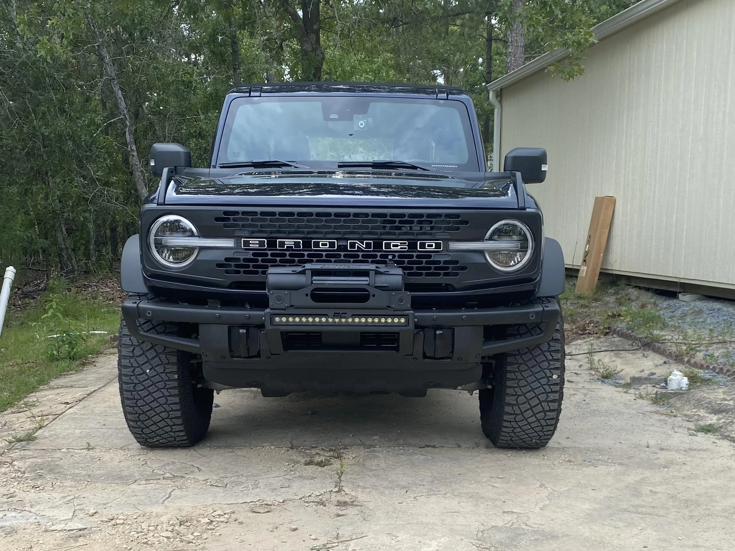

Badlands Sasquatch Lux with factory/Warn winch set up. Successfuly relocated inner park sensors to winch plate
It took 5-6 hours labor over the weekend only because i was unfamiliar with
everything.
No more turning off front park sensors every time i start the Bronco

OP, were you able to recalibrate the inner front park sensors to adjust for the new distance from the bumper? Do you even need to?
I dont think it needs to be done. Im sure they dont react the same as if they were 10” back on the bumper.

I don’t have this mount, I have the RC. That being said, moving the sensors doesn’t seem to be an issue overall. I will say that they go off long before the outer sensors now. I have tested the distance on my Bronco and seems to be the same distance for the sensor when it goes off when parking.
