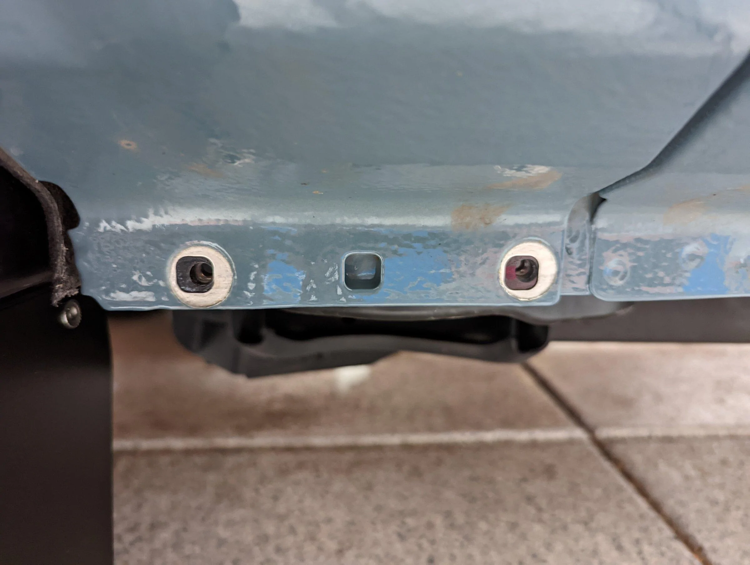

Should I have any concern about rust if I just put the covers on over the now bare spots from the front screws? Thoughts anyone?
Ford Bronco Pinch weld covers! PXL_20220429_040708202

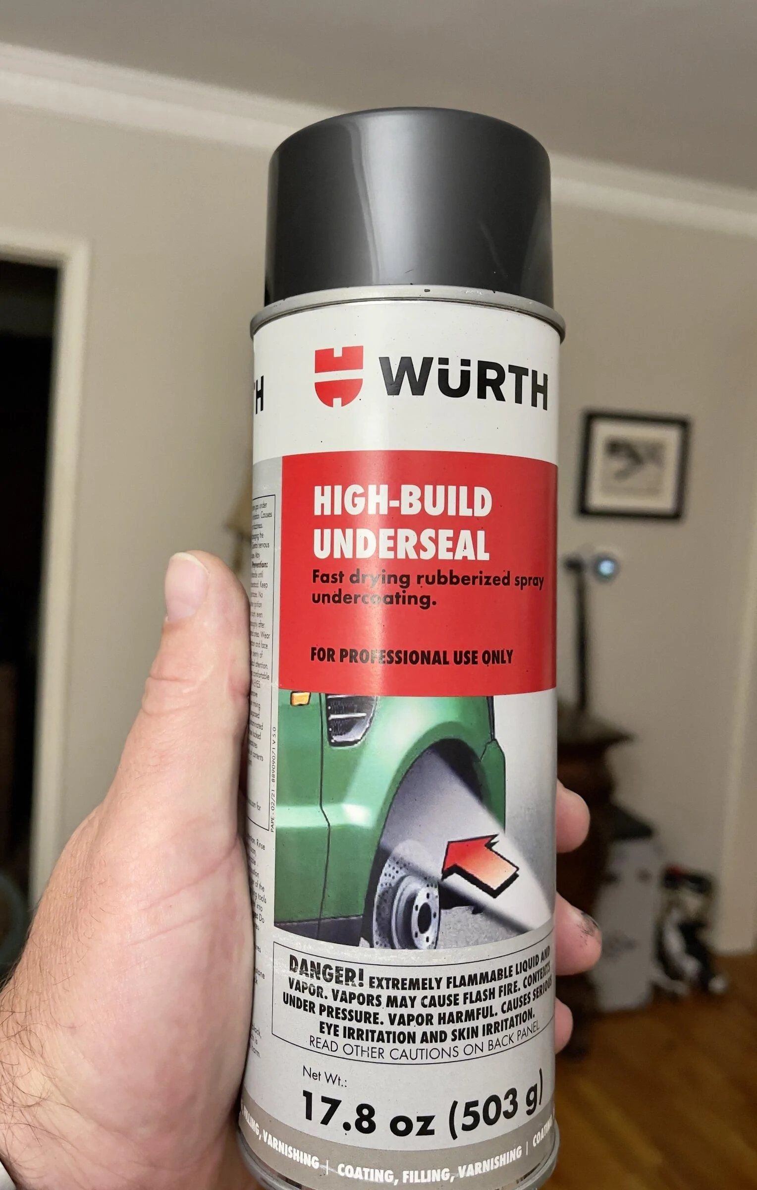

I just did mine with this. It looks really good, so do the JCR ones as well.
I'm interested in this approach. Do you just apply painters top above and spray across? I assume you only have to worry about applying to the external side.
I just cleaned the surface. And then taped around the weld area to be sprayed. Remove the tape quickly after or the Wurth will bond with the tape. I did one coat. That Was enough. I just did the outside yes. Do some test sprays on a cardboard box first. Get the hang of the spray and coverage. You'll love it.
