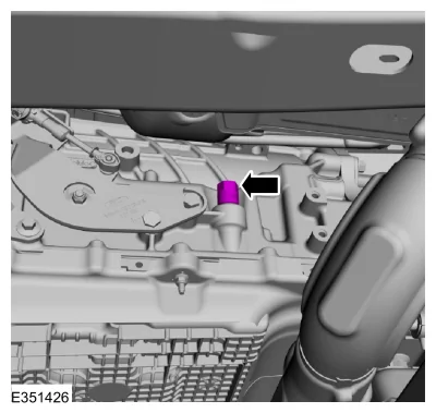

Yes, on the drivers side of the transmission case under a 19mm plug.
Right next to the exhaust...
