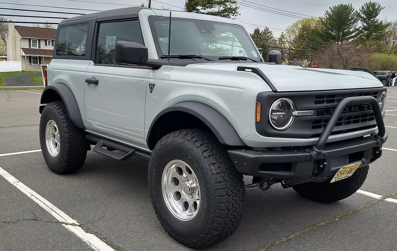

Looking to add these wheels to my Big Bend SAS 2dr. I have Mickey Thompson EXP tires in 35x12.5x17. What I find says I need 17x9 with -12 mm offset. Does that sound correct?

That will poke out a lot compared to stock. I would suggest 17x9 with 0 offset if they offer that combo. My ProComp wheels are 17x9 -6 offset and they poke a bit.
