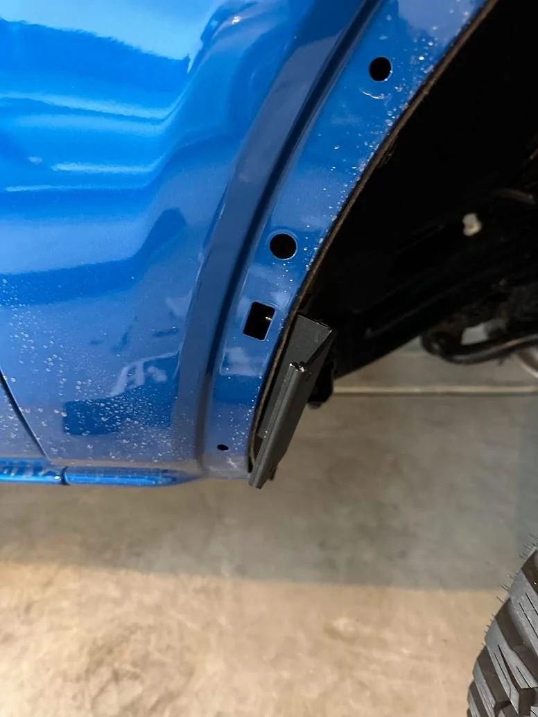

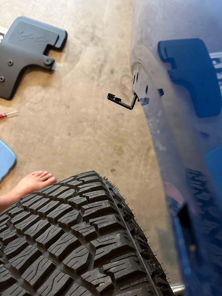

I don't know what I'm doing wrong. The install bracket has a bend in it and that seems to make the mounting at an angle to the vehicle, not perpendicular. In addition to looking wrong, it also makes the interior mounting point about 2 inches from where it's supposed to connect. The bracket is the same for both sides, and there is no way to install it backwards. I've watched at least 5 videos on this and I seem to be the only one having a problem. The bracket was built with a bend, not really sure why. The fender is very stiff and I don't think I can bend it back, or want to. Any ideas? Thanks.
