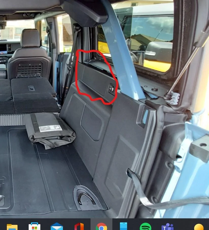

Whoa, volume up in the 20's?!? It will handle that? I thought I was pushing it about 13-14 in the Bronco, similar in my B&O 19' F350 CCSB.
I've got some woofer rattle, but I'm curious on upgrading the factory subs in both vehicles - would adding some cotton batting help?

I love my music loud, and the B&O is very clear at those levels since they have the DSP controlling the frequencies. The batting will help some. For the Bronco, the offending rattle seems to be coming from just above and to the left of the sub. See pic. This piece pops out and just put anything in there that might absorb the plastic rattle. It helped substantially. Quick fix. The real issue is the use of the plastic fasteners do not have a tight grip on it and thus have some movement that allows for the vibrations and therefore leading to the rattles.

Thanks, I'll have to give that a try after fixing the squeaks of the empty child booster seat. SO annoying!
