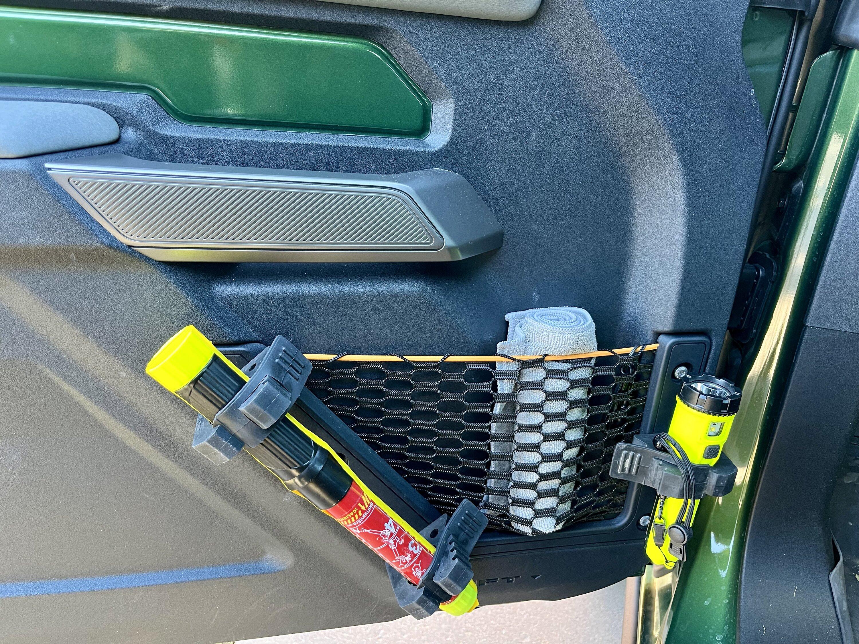

Possibly the easiest mod I’ve done so far. 15mins once parts were on hand.
- 3x quick fist tool grips
- 3x T30 M6 35mm bolts (replace factory bolts due to length.)
-Element E100 fire extinguisher
-Flashlight
-difficult to see also have combo window punch/seatbelt cutter on key ring.
not sure if it’s permanent yet. Easily reversible.

What is the brand and where can I buy it?
Quickfist.
They are all over the web, easily found on Amazon as well.
Pretty handy.
I did the same for my metal door pockets back in the spring and they hold a flashlight just fine.
