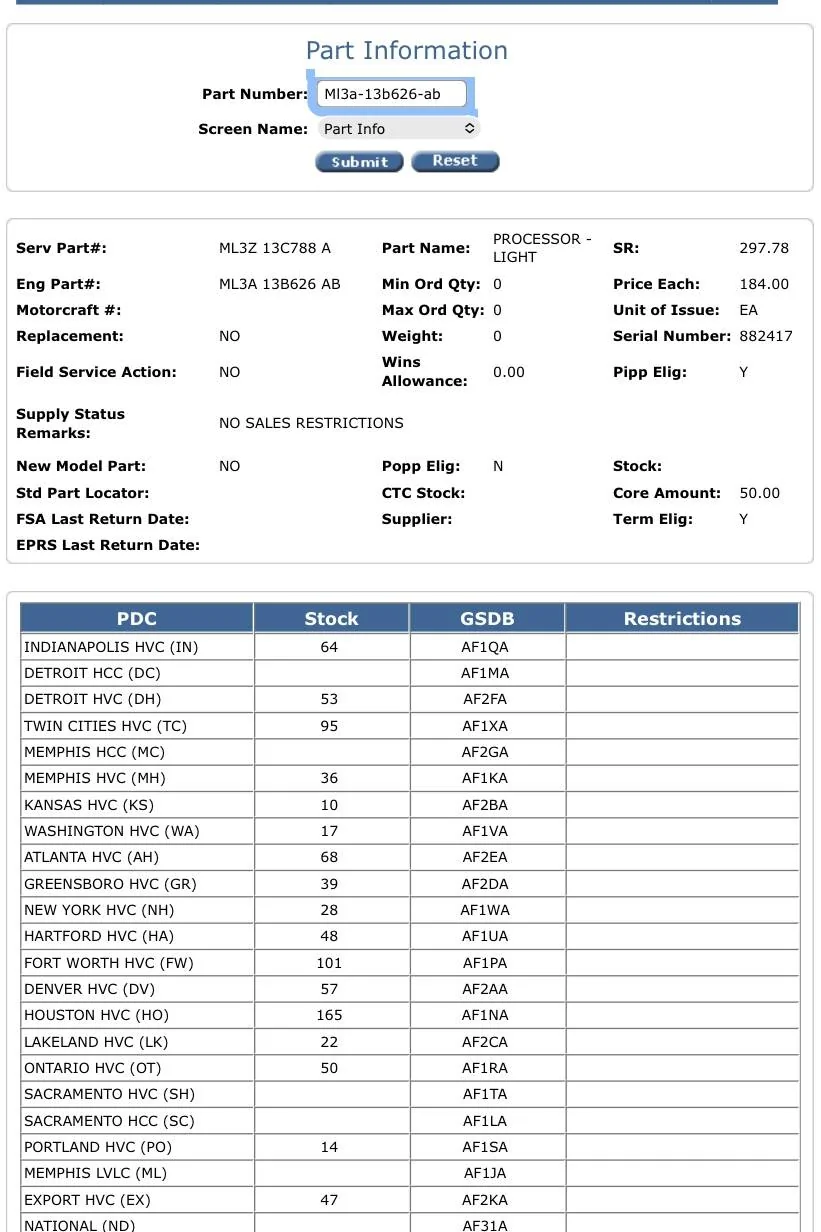

Can anyone verify that the part in the picture is orderable part LC5Z13C788I?

ML3Z-13C788-A
Looks like there’s plenty available.
Not sure where you got that LC5Z number from though.

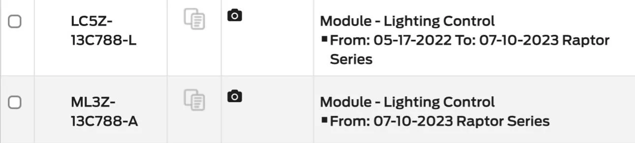

@Ducati1098 I got that number by looking up a parts diagram for a 22 braptor on tascaparts.
Oh okay. Yeah that number shows for 22-23
The ML3Z is for 23 and up. Not sure if they’d both work, but your picture is the ML3Z module.

Regular Broncos built after 5/17/22 use the same ML3Z-13C788-A
Before that the Raptor and regular Broncos were different.

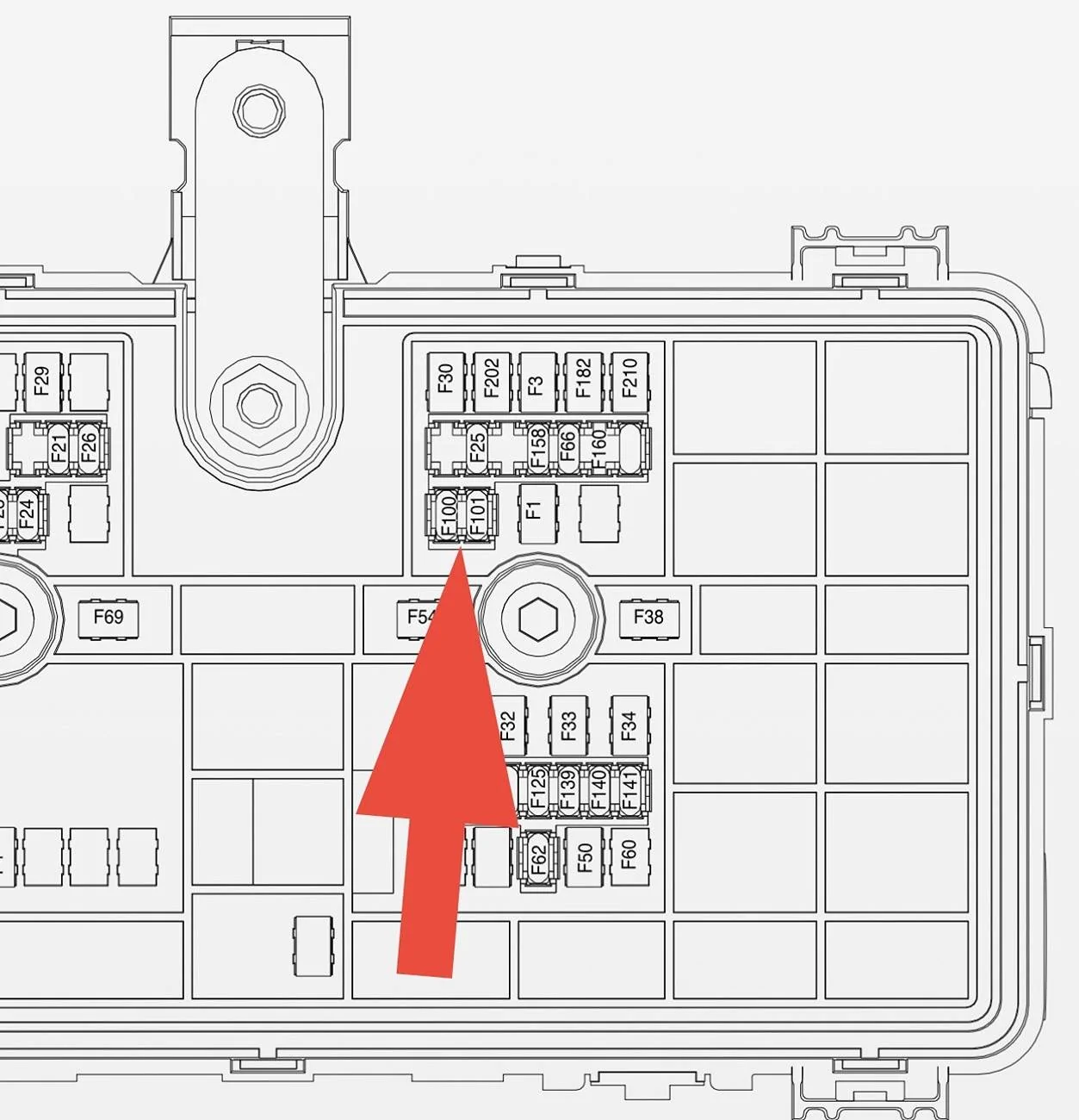

There are 2 headlight fuses in the battery junction box. I believe 20 amps in spots F100 and F101. Check those, I had a somewhat similar issue with a Bronco getting water in the module from a cracked headlight after a collision.
Funny enough both of mine were blown (from swapping the bad module around) but I replaced them prior to using FDRS
