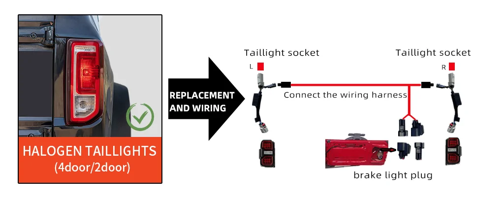

They may have updated them since I purchased my AIGMUX tail lights a year ago. I had to run a separate wire (included) from the right side tail to my 3rd brake light. That way the tail light would know the difference between braking and turning.
And maybe the newer versions have found a way to do this in their plugs, that I don't know. The Amazon link provided by @TheBroncolorian above seems to be the updated version of my tail lights... I don't remember if mine had a plug for the 3rd brake light or if I had to splice the wire. You can see in this pic how that wire connects the 2 tails and then splits off for the 3rd brake light. It wasn't that difficult of an install.
