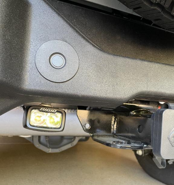

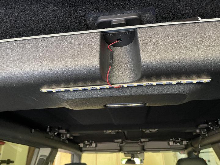

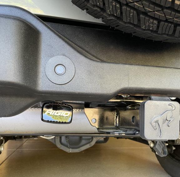

I mounted a Rigid SR-M Flood under the rear bumper. I used a 5/8" "Winged" toggle bolt with spacers into a hole in the steel crossmember. Throws out a lot of light, and bright. In fact I keep the cover on so I won't turn it on with "trailgaters". While wiring it, I also ran another wire to acc. switches for an LED trunk light. It's peel and stick so you can pretty much mount it anywhere.
Here is a link to video showing amount of light and the difference between, spot and flood.

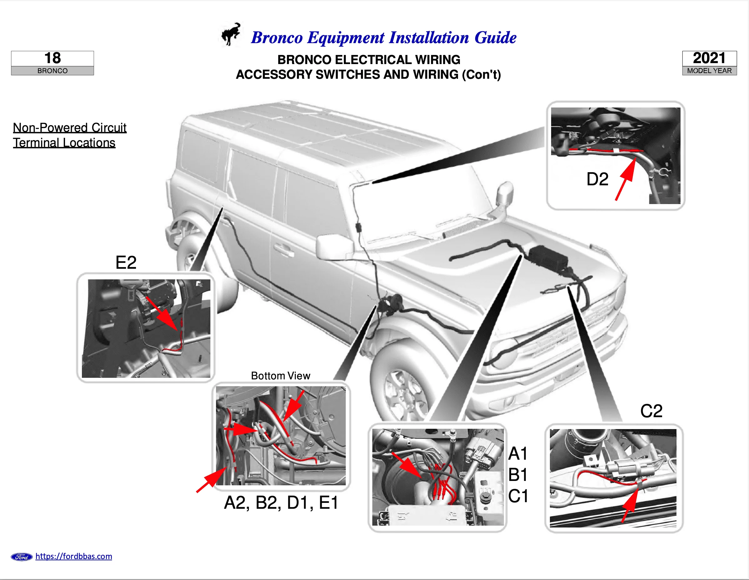

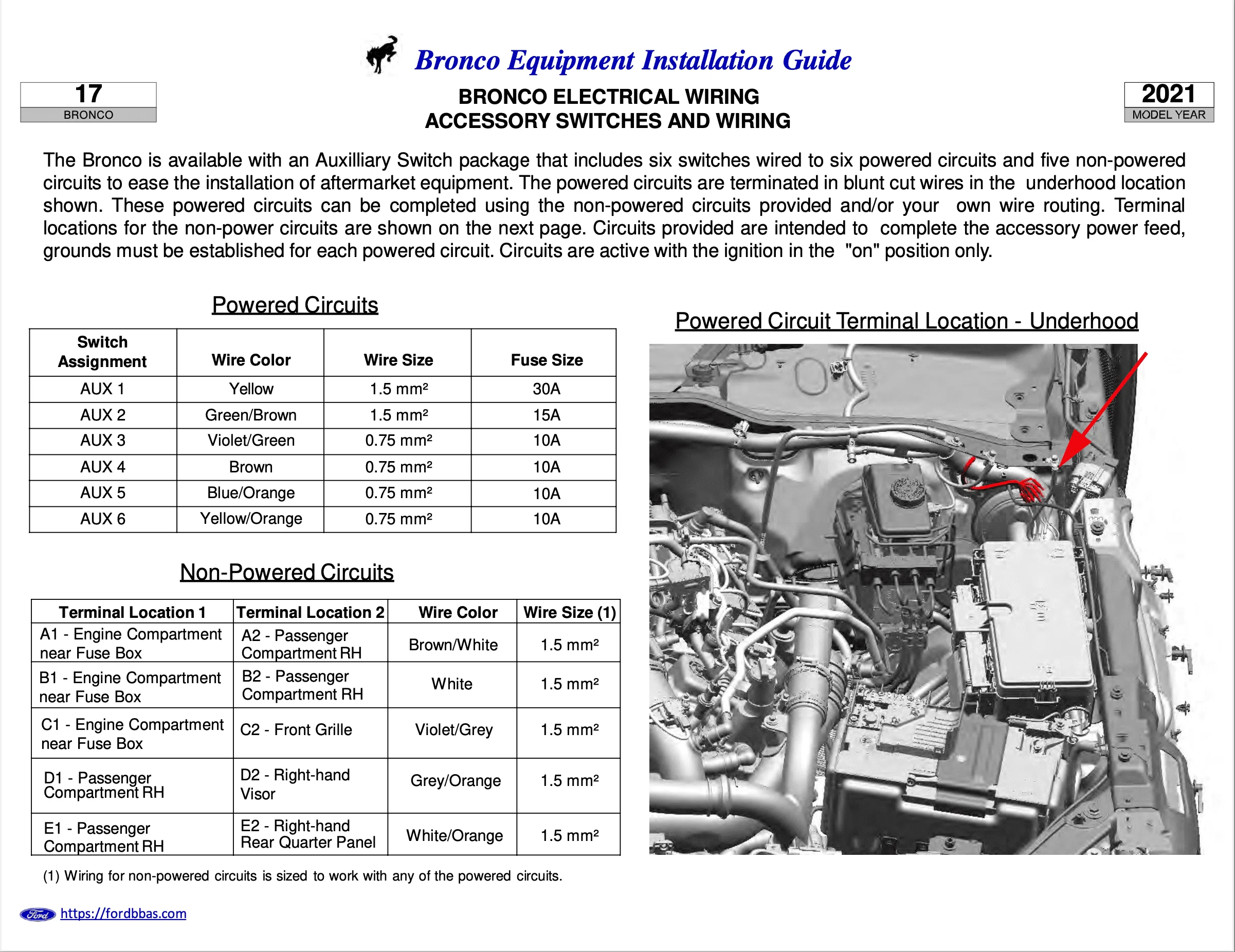

That is interesting. Thanks. Where do you pick up the pre-wire for the Aux switch in the rear?
