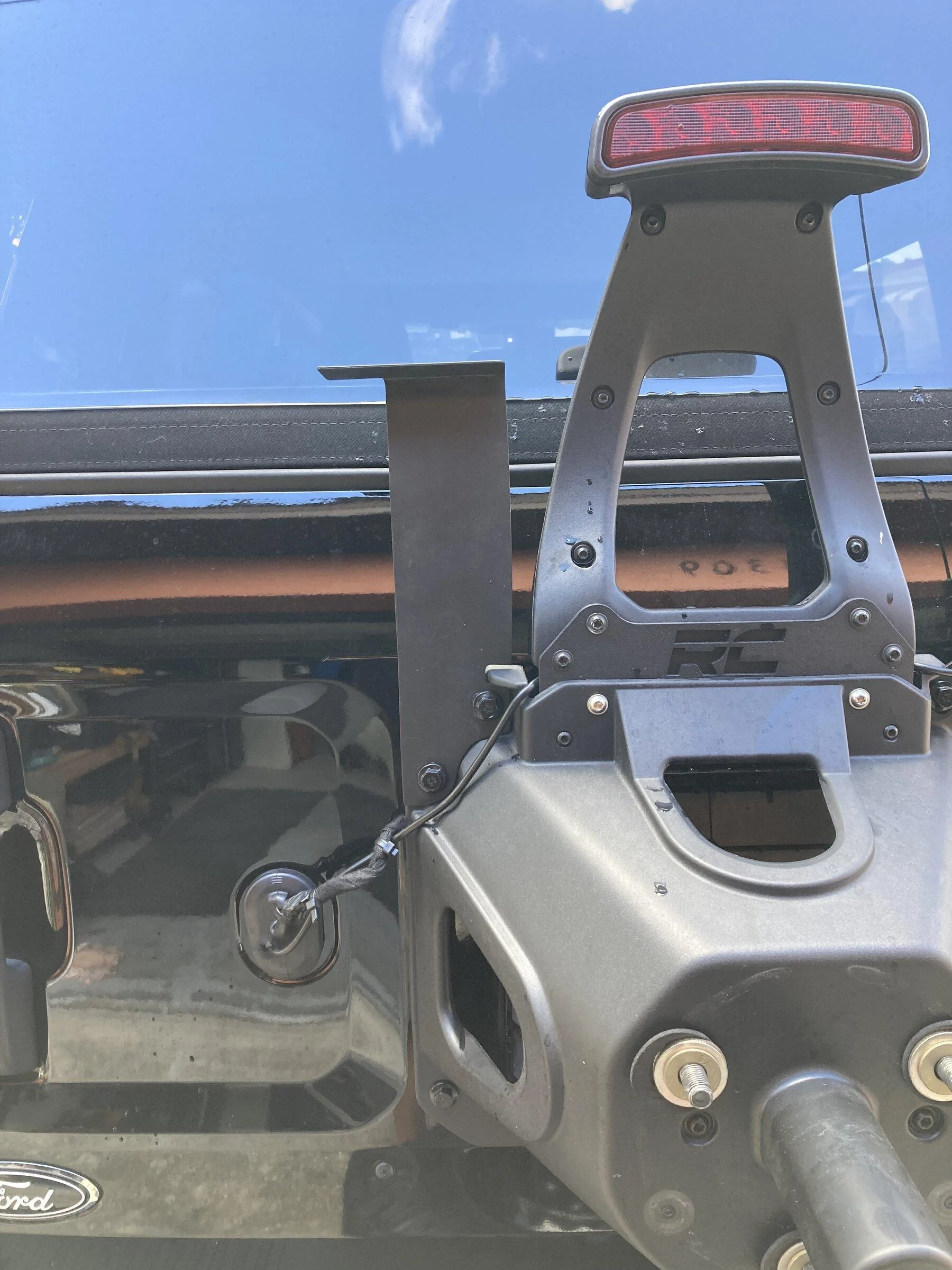

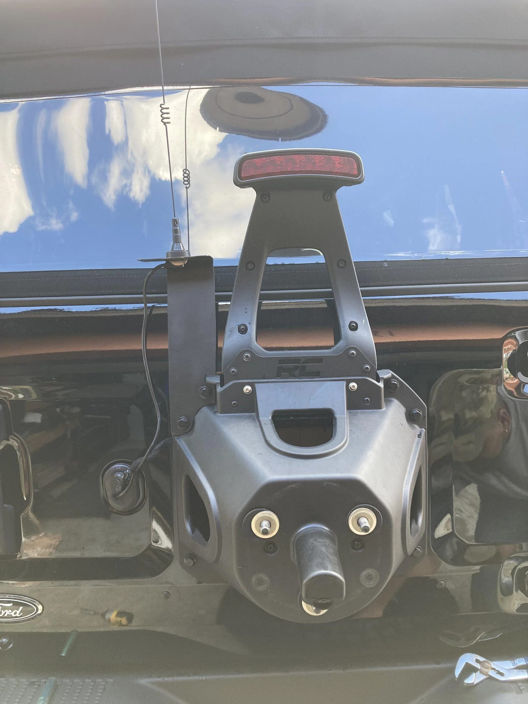

This will be a modular mount..left/right bracket. There will be a bar across the back that you can mount lights. The bar will be adjustable in height. And since it will be a bar, you can also adjust the lights closer/further from the spare. The lip on top of the bracket will have holes for GMRS/CB antenna or trail flag..

Love it! I assume you made the brackets yourself? Could also be a good option to mount even some Rigid SR-2’s or something small/discrete. Thanks for sharing this.

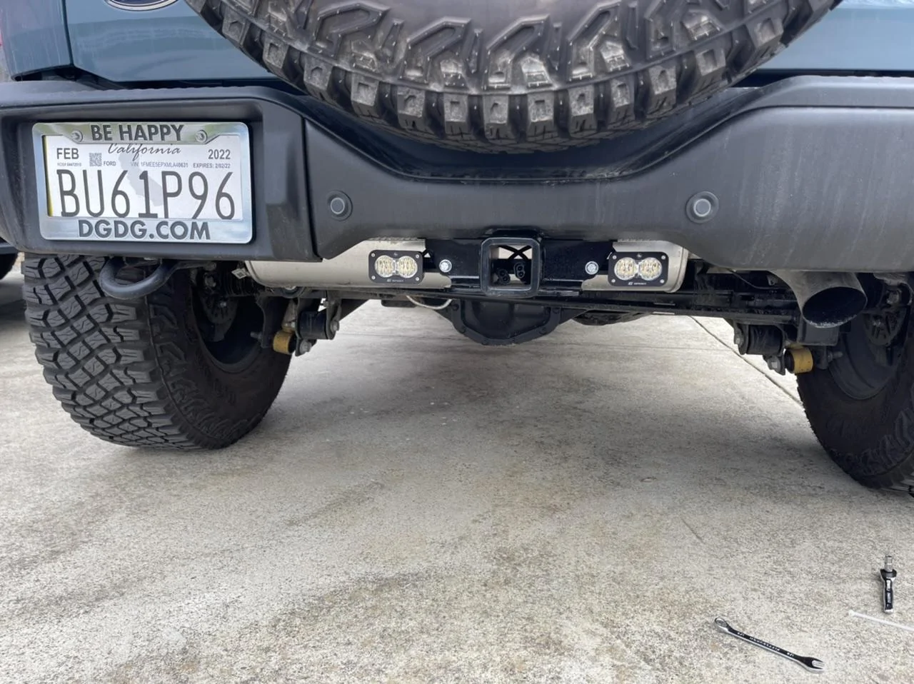

I just mounted mine today, used holes in the Curt hitch. I had a piece of aluminum Chanel left over from a bed cover.
Ford Bronco Rear Lighting Placement Ideas? 3A0546D8-A8B0-4712-9E7C-AC7BA0A261C0
That looks great - Discrete, simple - Well done! This is another great contender!

Agreed. Very nice and discreet. Could you please share a zoomed-in photo with a description of your wiring route?

The only downside on this setup is the factory tow hitch has the power plugs on the left. I‘m sure something similar could be done, but it’d have to be slightly different.

Yea I'll take another pic tomorrow. I haven't wired it up yet tho. Mounted front and rear today, I'll have to see when I have time to wire them.
Being I don't have tow wiring I have to find where to tap the reverse signal and run to the upfitters

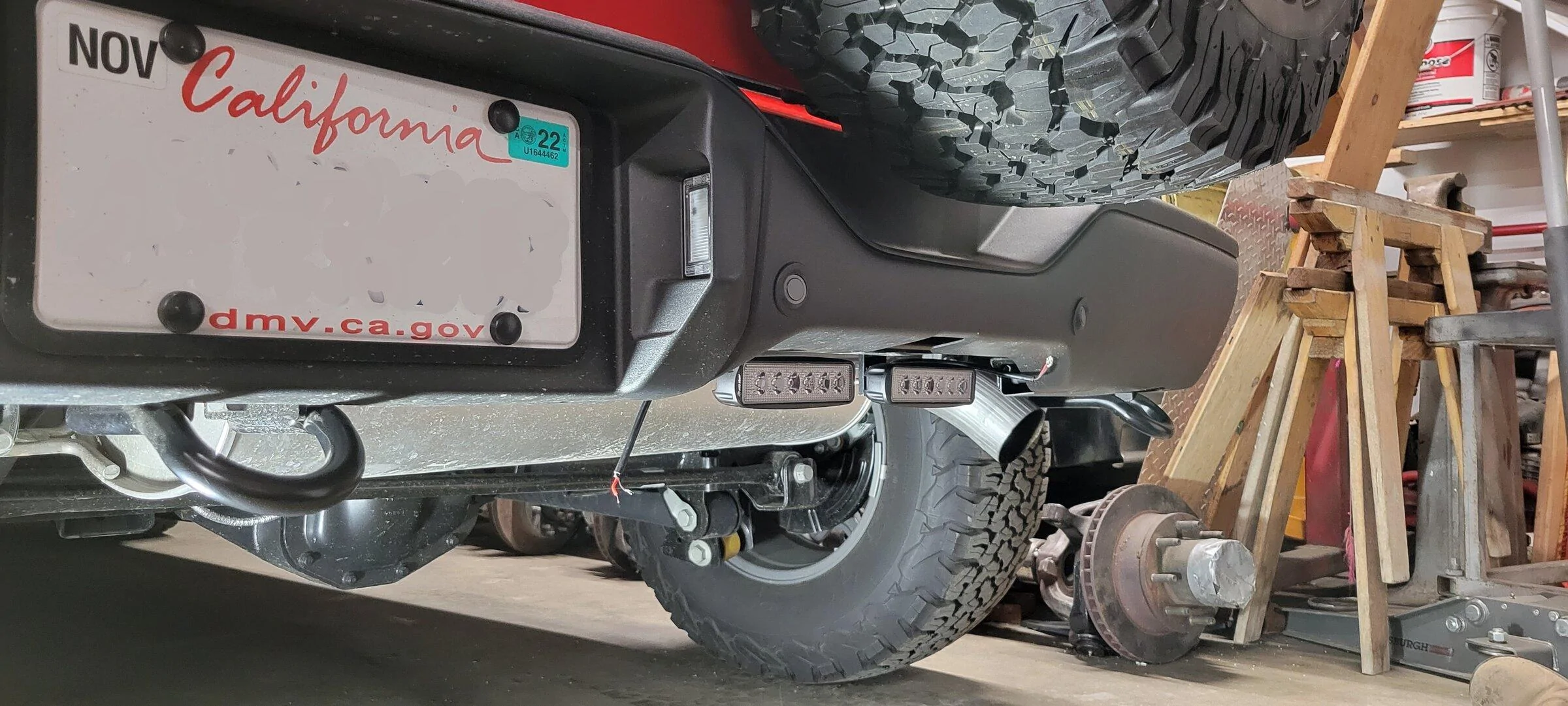

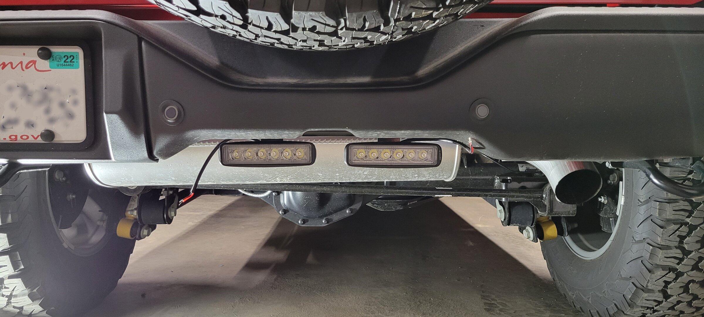

I just read a post of a member mounting a pair of lights to the trailer hitch, and it got me thinking: What are some other mounting options? Not looking for any aftermarket bumpers or cutting into the factory bumper. Anyone come up with some good ideas? Pictures are helpful too.
Anyone remove the rear tow hooks and mounted there?
Thanks!
Ford Bronco Rear Lighting Placement Ideas? 3BFE50B8-18CE-41E0-8EBE-170EF1F8C4D6
Ford Bronco Rear Lighting Placement Ideas? 645873B9-FAA8-48BA-AFE2-9ED2A25AB21C
Sorry for snow but you get the idea, they are tied into the reverse light and upfitter switch. Still above recovery hooks . Tied into the reverse circuit inside the passenger quarter panel green and brown wire coming out of tailight , the upfitter switch wire Also inside the same panel, I believe it white and orange.
I wanted them spread out as far as possible for the widest angle possible. If you turn on zone lighting they will also come on.

I like the look of this! Too bad I have the tow hitch there. Would likely look good with just one of these mounted just above that, under the spare tire on top of the bumper. Not sure I want to go that route, but just throwing the idea out there for others who may be looking for options.
Thanks for sharing this!
