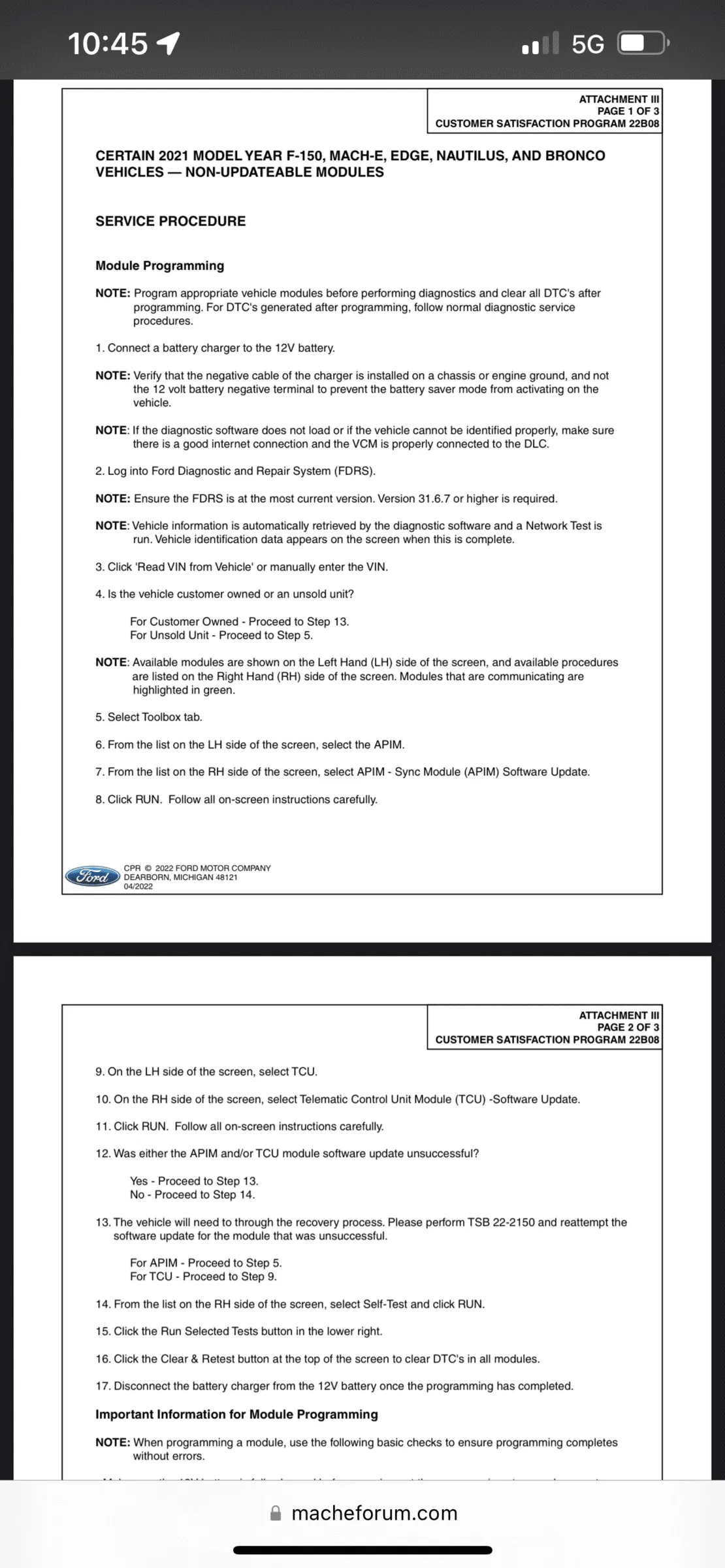

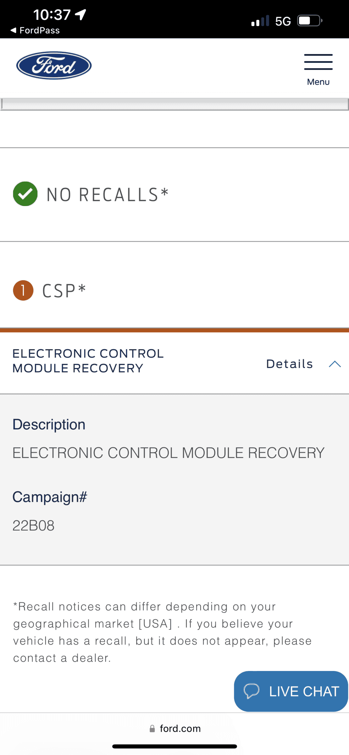

Anyone else have this alert in their Ford Pass app? Looks like it is something to do with the power up software update.

Nothing on mine. Are you seeing any dash warnings or alerts?

Nothing on the dash. Nothing thats effects anything except the control module is not updating over the air like it supposed to from Ford. Doesn’t effect drivability.
