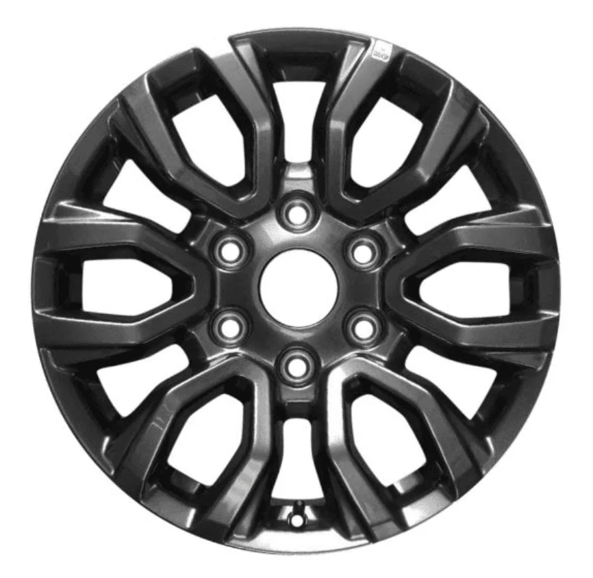

I picked up some ranger fx4 wheels 17x8 with a 55 offset. Will 285/70/17’s fit without any modifications?
Ford Bronco Replacement Tires for Bronco Base 1635385152037
