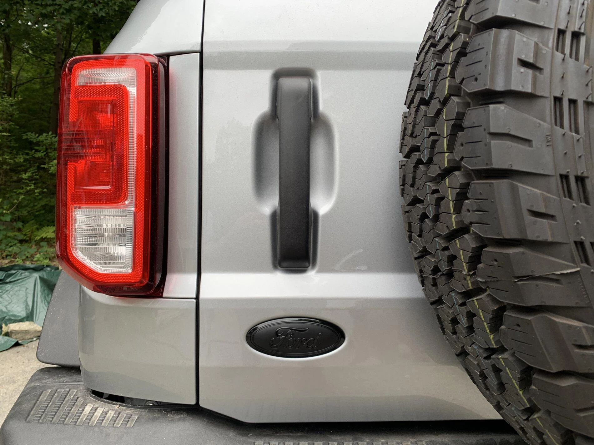

As for the Ford logo. I got one from Emblem City for $100. Was delivered in 2 days. It’s painted though.
ISFP Custom Emblems seems the best quality option. Might be the the way to go for the Ford logo. They should have them available soon. “We are an acrylic overlay cut via water jet and then painted with PPG colors and then we cover them with a polyurethane resin we had specifically designed for our applications. Our vhb tape has also been designed for our applications and is Marine rated (along with the resin).
Here's a test on our strength as well! It's to simulate road debris that you may encounter on the road! From bugs to rocks, we stand up to it all! No chipping, cracking, fading, peeling, pitting, denting or scratching!”
It was pretty easy taking it off - you want to use trim tools and get behind it. Ideally press the tabs on the clips and pull out. I cracked one clip - but, easy enough to glue/JB if need be. There is a solid pad of adhesive that needs to be removed from the clear coat. The edges of the emblem are pretty sharp and scratched the clear coat while working it off. But, nothing that can’t be buffed out.
