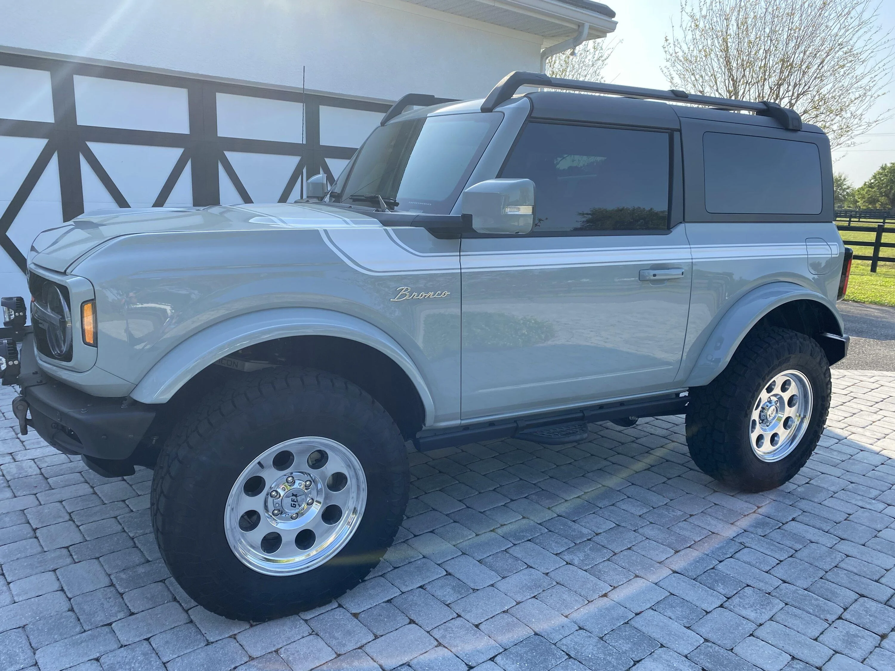

My favorite wheels are the US Mags U101s. On a Classic Bronco with Fender Flares and 33/12.50s the outside of the tire is even with the fender flare. But, this wheel has an offset of -37. They do have the Deep Dish look.
However, the same wheel, even if the bolt pattern was available, would stick out past the fender flare way too far on the 6Gen.
I went with these wheels on my Special Decor 2-Door build. Voxx 18x9 wheels with a +12 Offset. As you can see they do have a Lip, but not a Deep Dish as an earlier design wheel. At a +12 offset the 285 tire is even with the Sasquatch Fender Flare.
