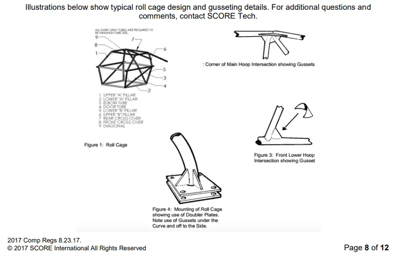

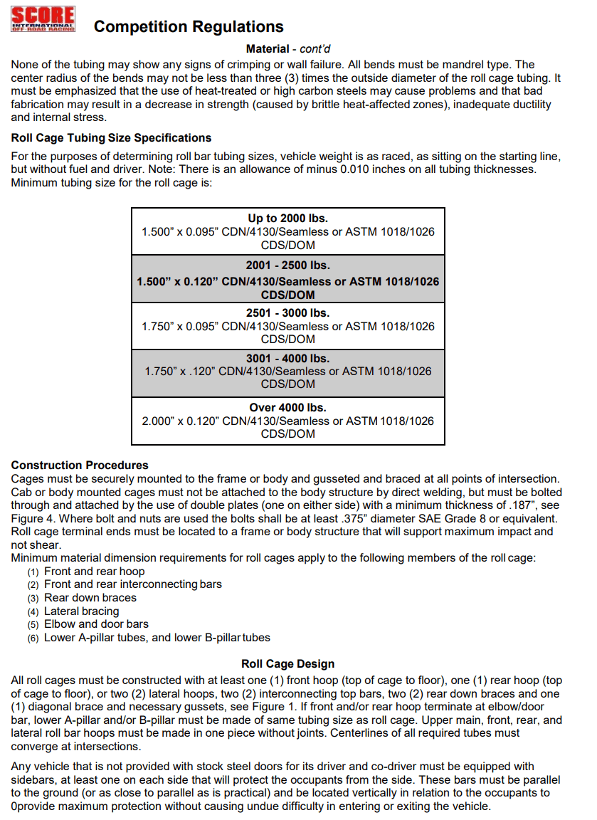

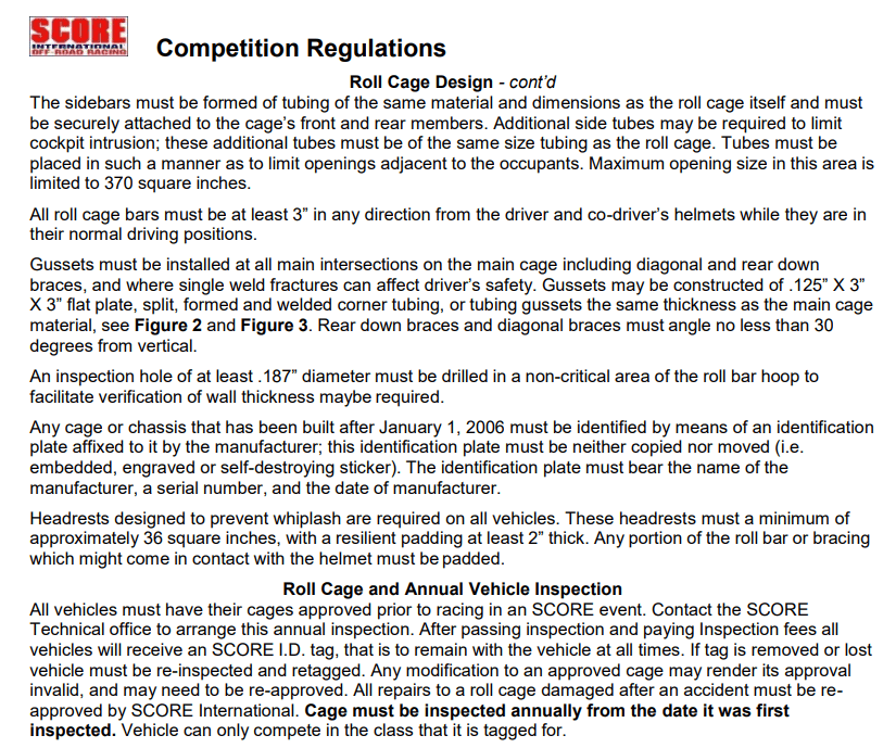

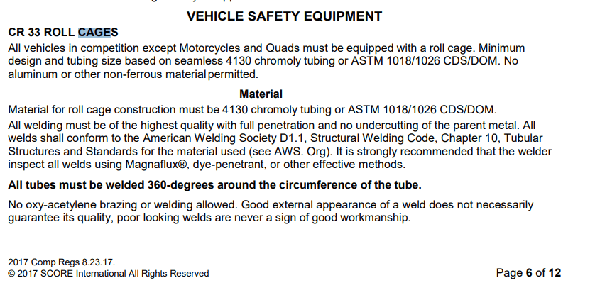

Snarky response:
Ford Bronco Roll cage? 1646166951745
Translated: You could have saved yourself and everyone else a lot of time by just asking the SPECIFIC question you have rather than the random, vague whatever it is you tried to ask.
Technical response:
As you are well aware, Baja 500 follows the regulations set forth by SCORE, their governing body.
The regulations are clear as to the cage requirements. Note that they CLEARLY state all cages must be welded in, no bolt-on cages allowed.
Page 6 is where things get spicy for you, and don't forget, you have to pay to play!
http://score-international.com/raceinfo/wp-content/uploads/2017/04/2017-Comp-Regs-8.23.17.pdf
Ford Bronco Roll cage? 1646166837042
Ford Bronco Roll cage? 1646166877098
Ford Bronco Roll cage? 1646166890506
Ford Bronco Roll cage? 1646166900700
