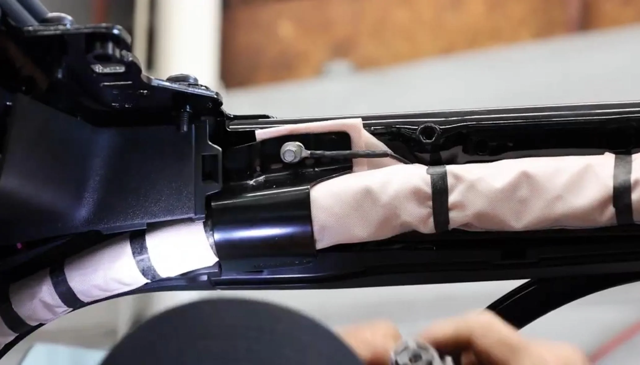

There are a couple grounding points just behind the passenger curtain airbag cover. Pop that off and you should see a couple bolts you can tie into there.
Ford Bronco Roof light bar ground IMG_1256
Thank you for that.
So now just buy a thicker gauge wire to run to the powered aux wire?

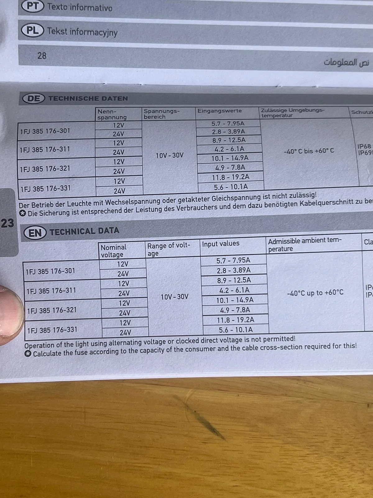

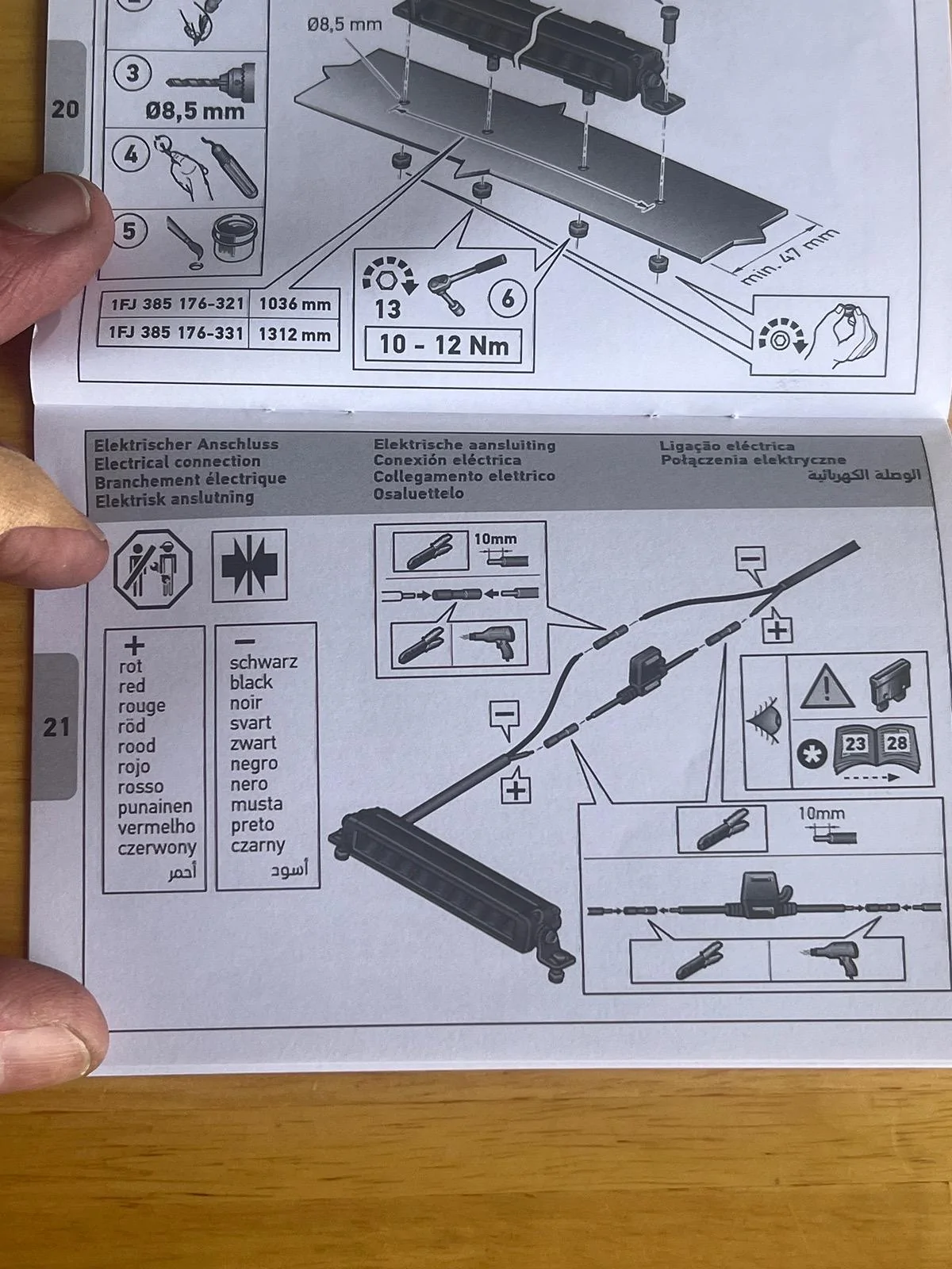

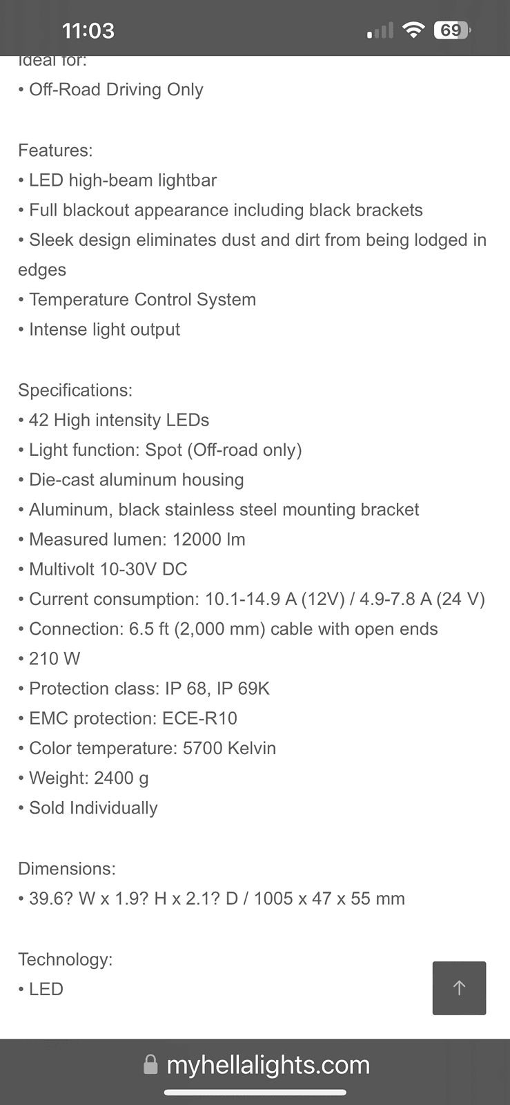

And this too. So says consumption is 14.9A but the ohms calculator shows 17.5A. Connect to the 30A or 15A circuit?

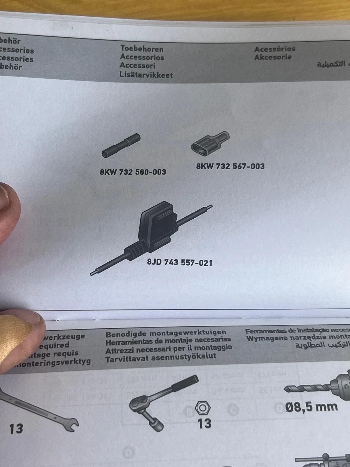

It needs a 20 amp or more upfitter. I believe #1 is rated for 30 amps.
As for wire gauge... 14 gauge wire will be sufficient for a 15 amp light bar. You don't need a fuse as the upfitters are already fused. However if you are confused by any of this please have a professional install/wire it up so that it's done correctly.

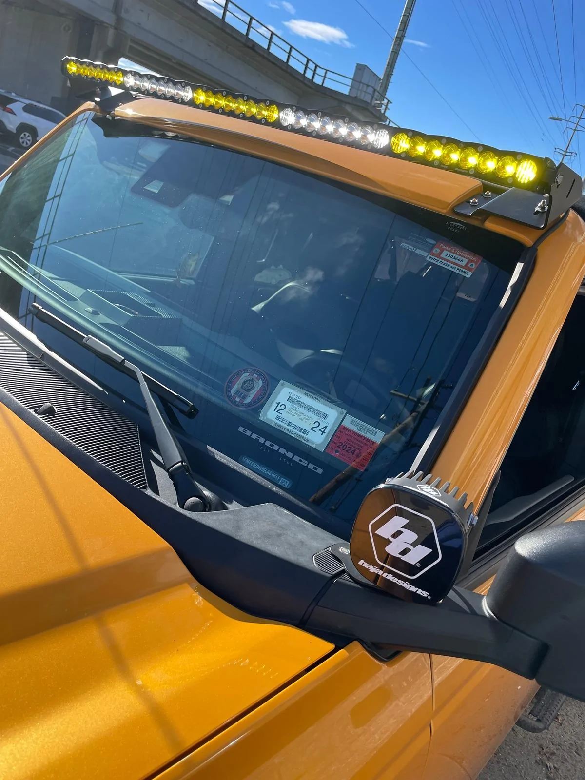

I did the pillar pod lights a while back and no issues. Just finished wiring everything up and so far works 😁. Bought 12 gauge wire and went to #1 30A.
I’ll take some pics and explain later.
Thank u for getting back to and answering my questions
