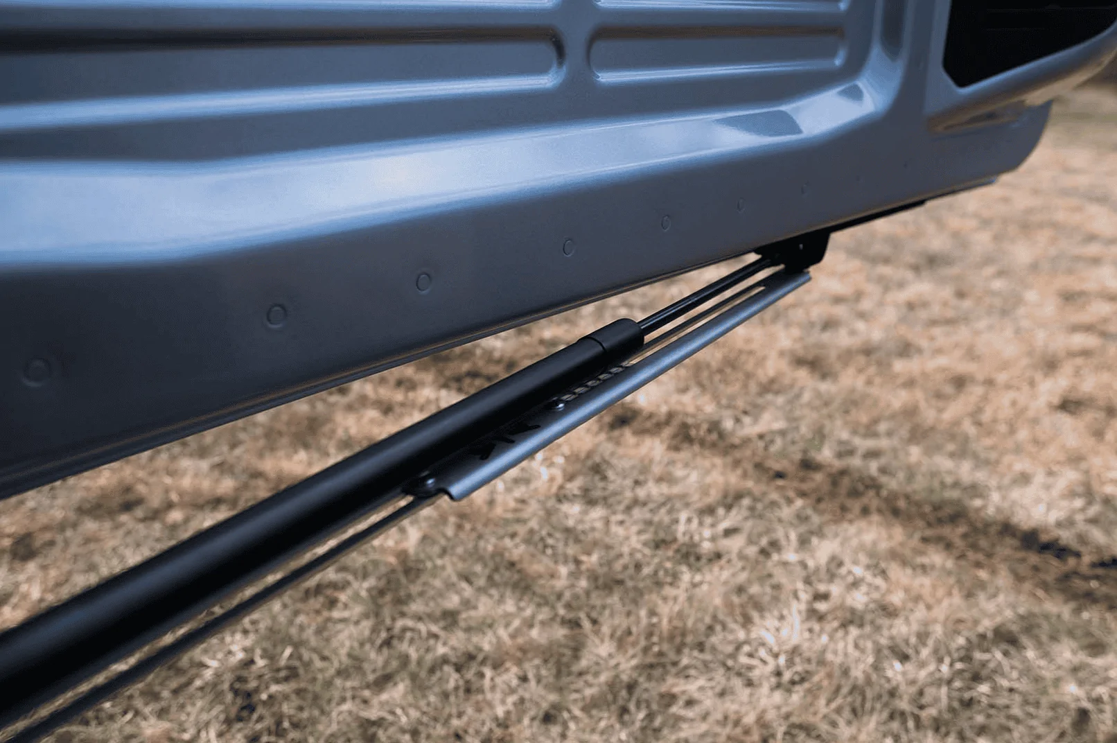

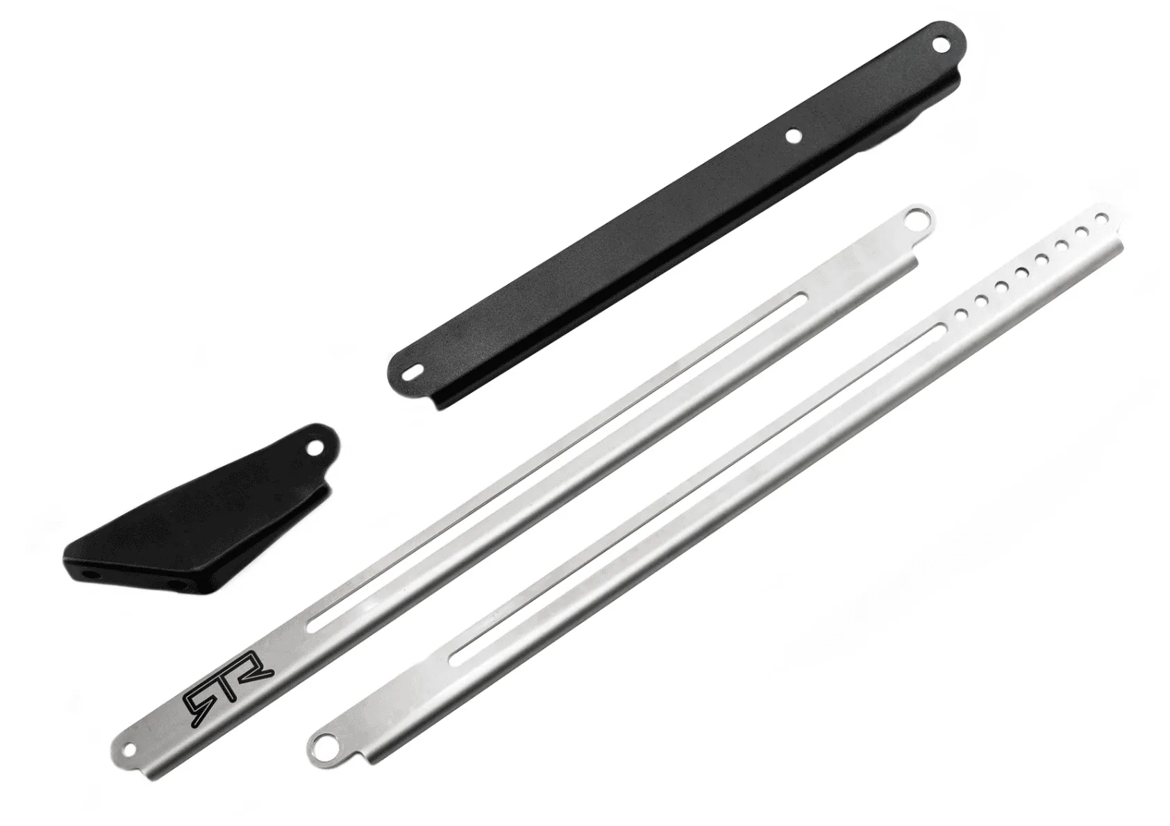

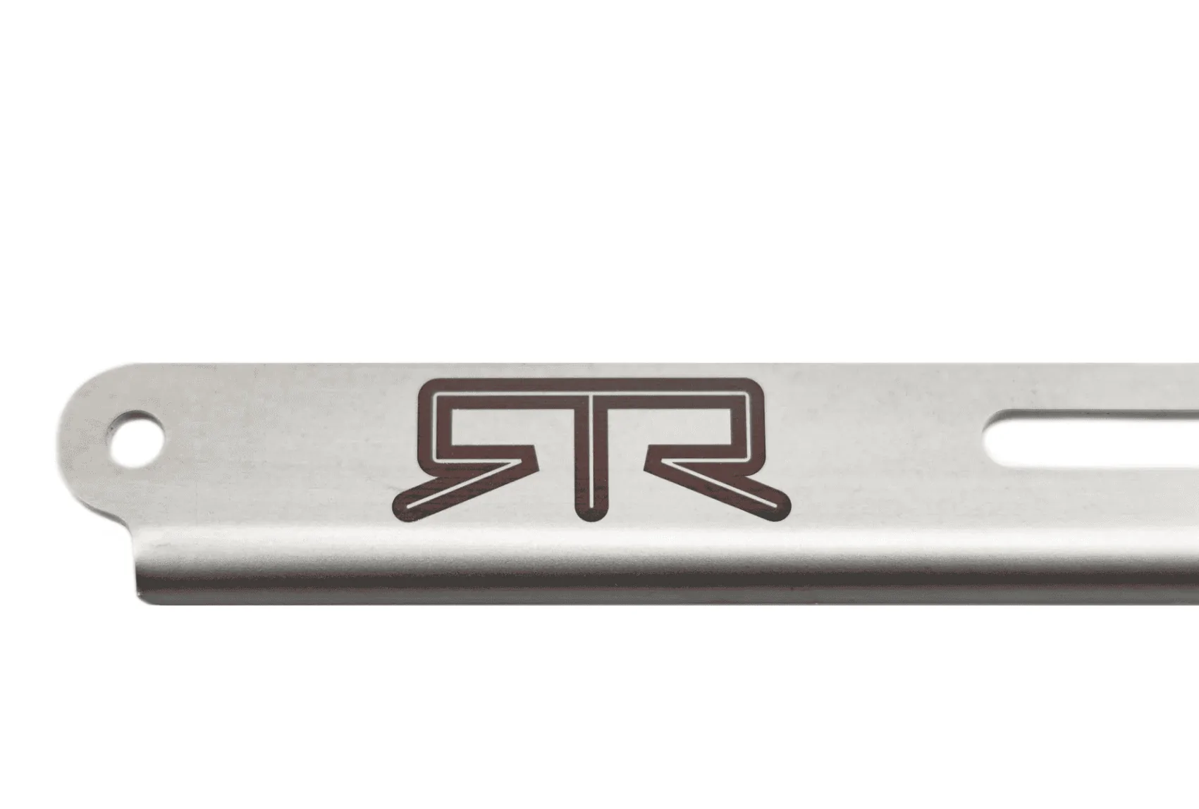

The RTR Adjustable Tailgate Stop was designed to use the OEM damper and mounting location while limiting the swing of the tailgate. Have you ever been in a situation where your tailgate has overextended? Even with the factory rear tire and no accessories attached, the tailgate has been known to overextend. If your tailgate overextends, it has only one place to go and that's hitting your Bronco's chassis or busting out a taillight. :eek:
If you have accessories on your tailgate, those accessories add more weight to your tailgate making it even more susceptible to overextension.
  • Recommended for any Ford Bronco with or without added tailgate accessories
  • Limits tailgate movement to prevent body damage from accessories
  • Adds protection to factory tailgate damper
  • Stainless steel sliding links and hardware
  • Laser-engraved RTR Logo
  • RTR Adjustable Tailgate Stop Weighs 3lb
  • No cutting or permanent modification required

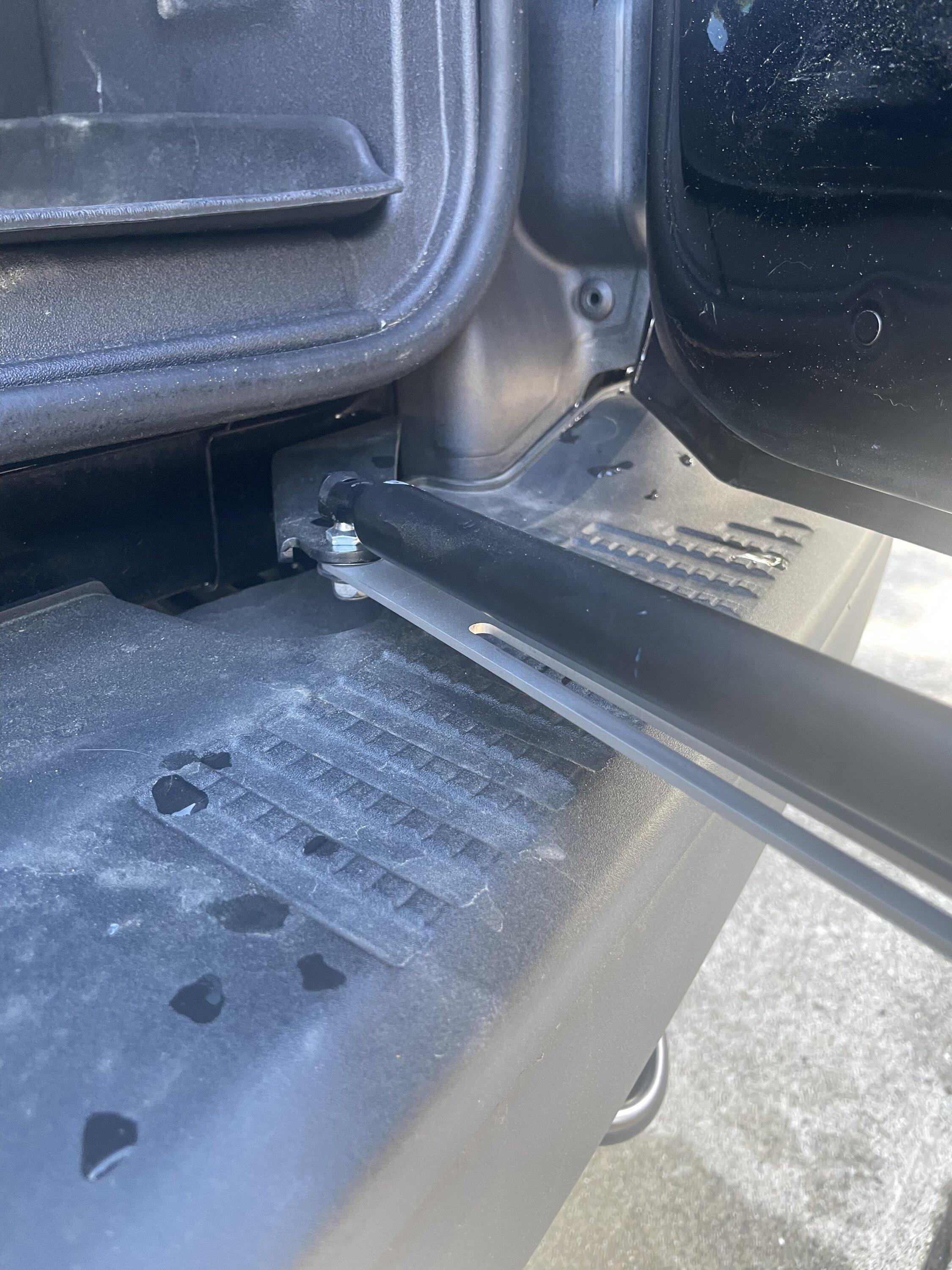

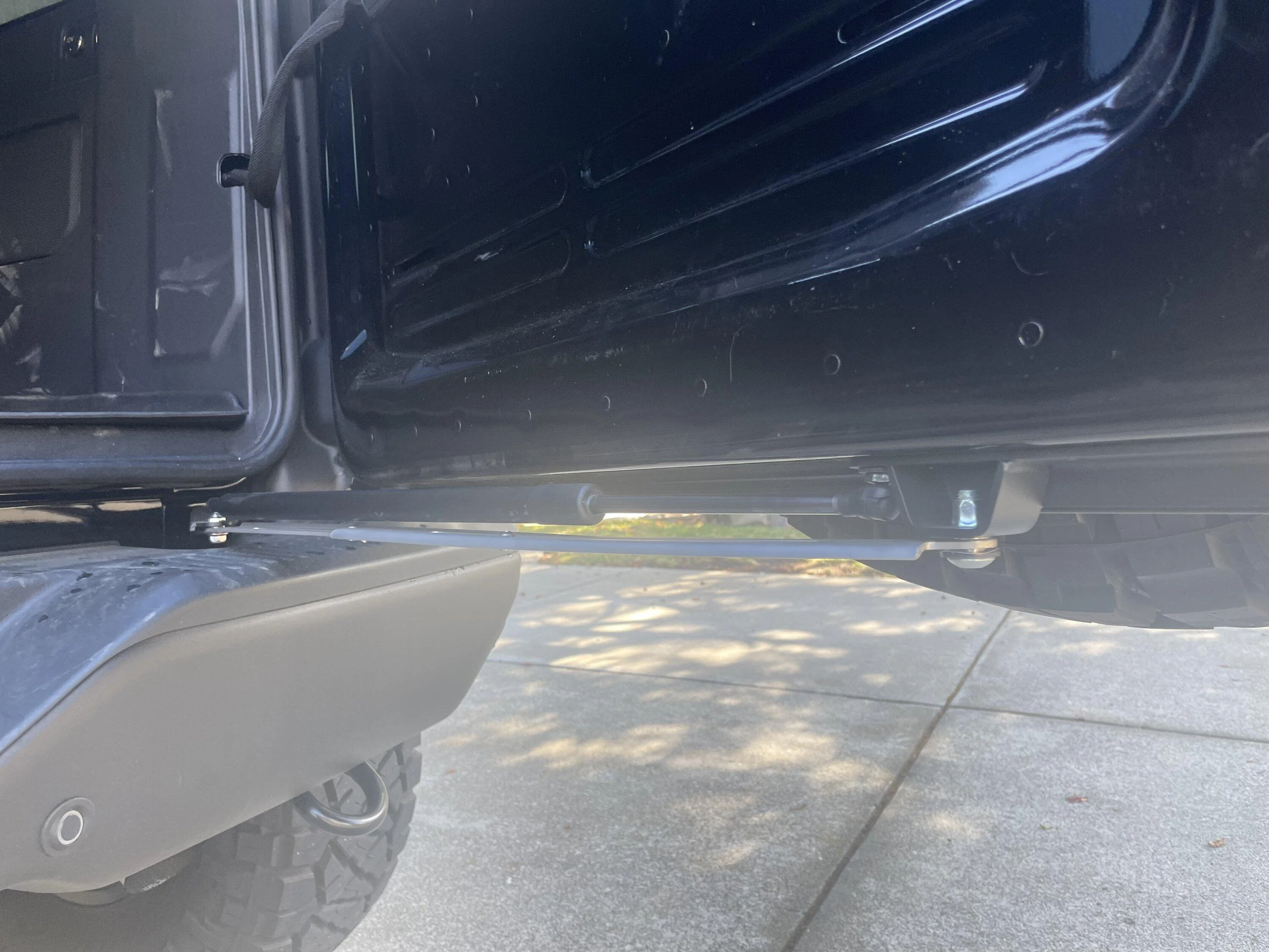

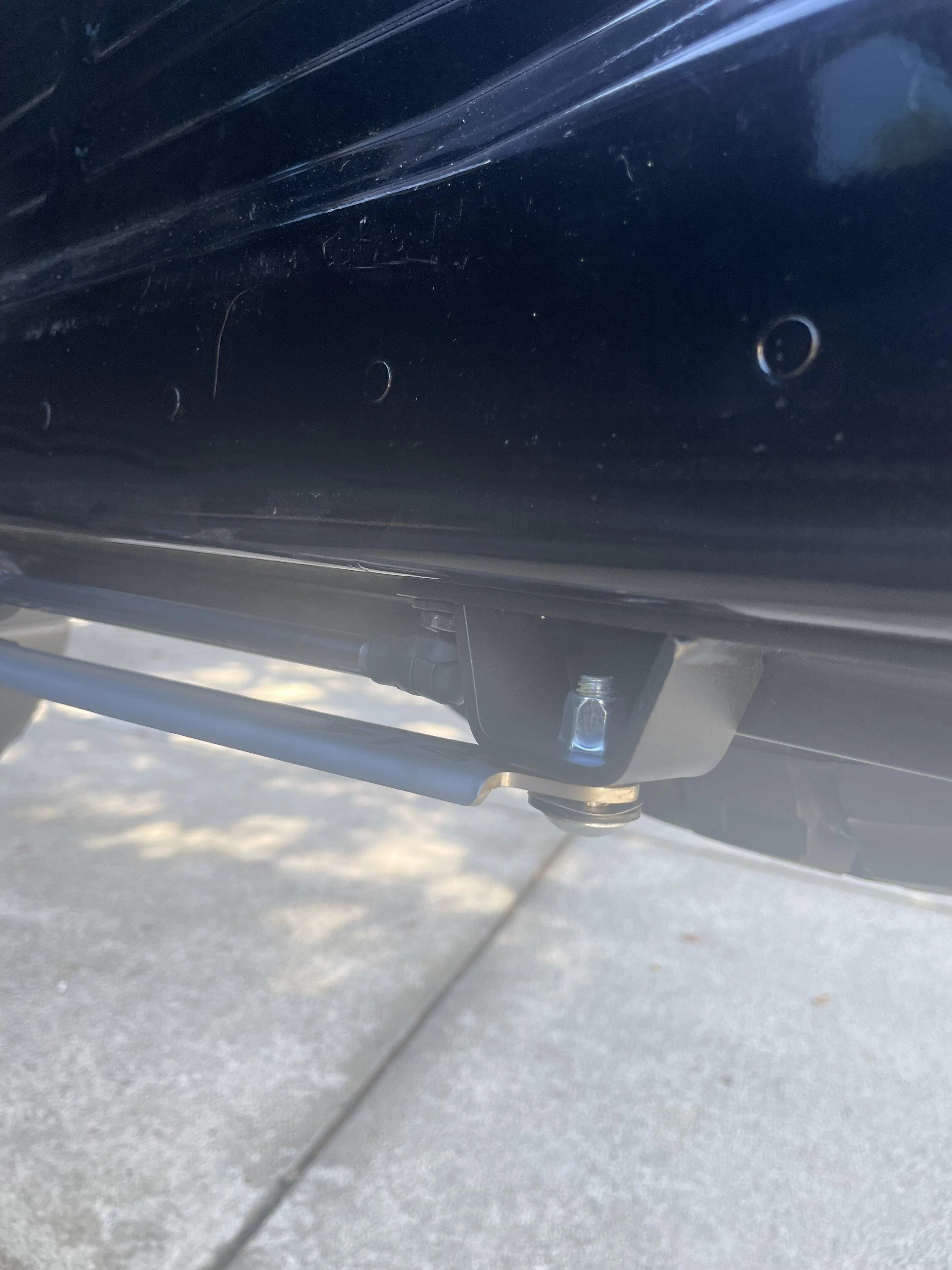

Anyone have additional pics of this item installed?
I’m curious how this bolts into the vehicle at the bumper, and how much clearance is needed. Attempting to learn if the limited arm would or would not be compatible with aftermarket rear bumpers.

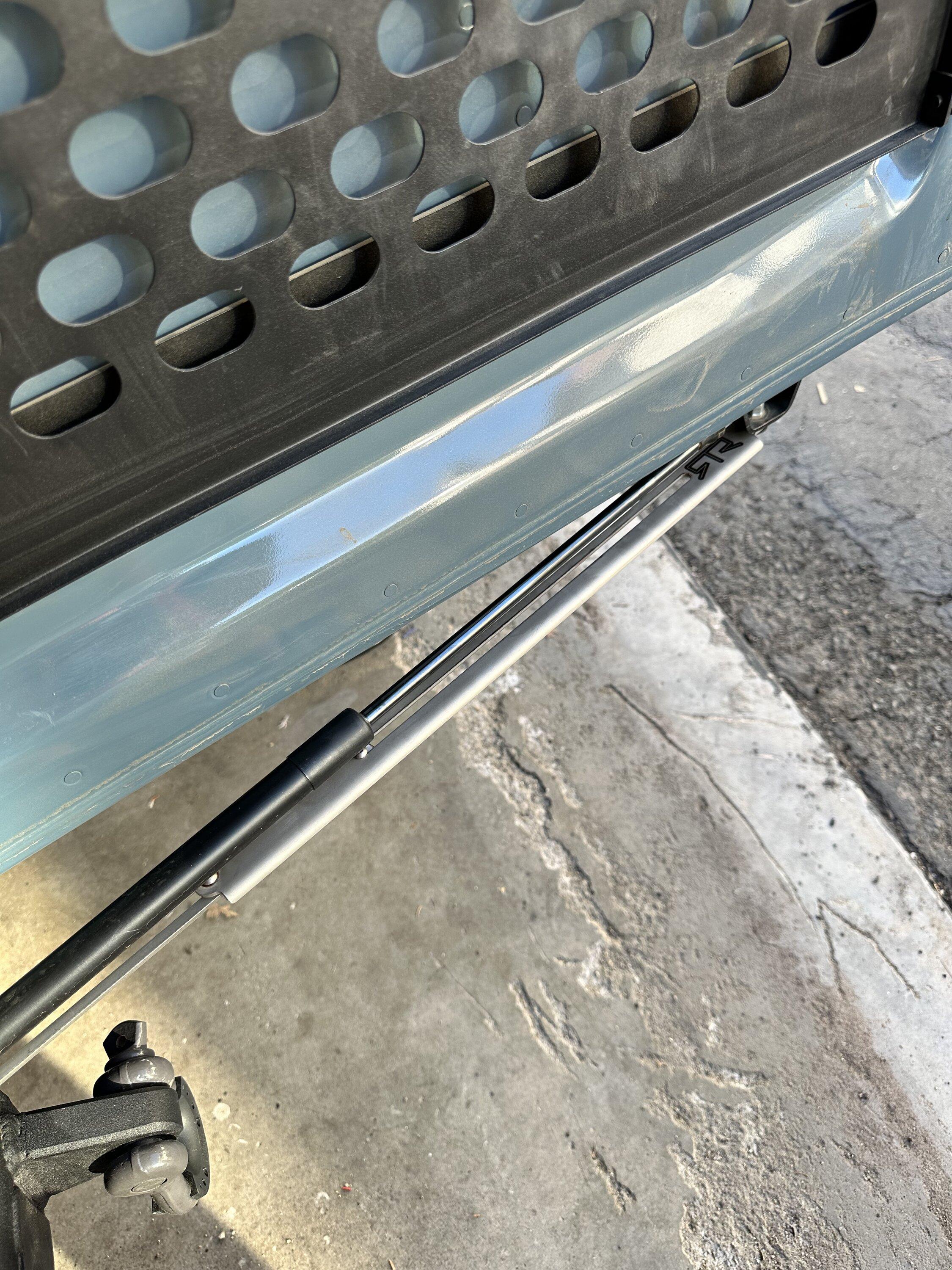

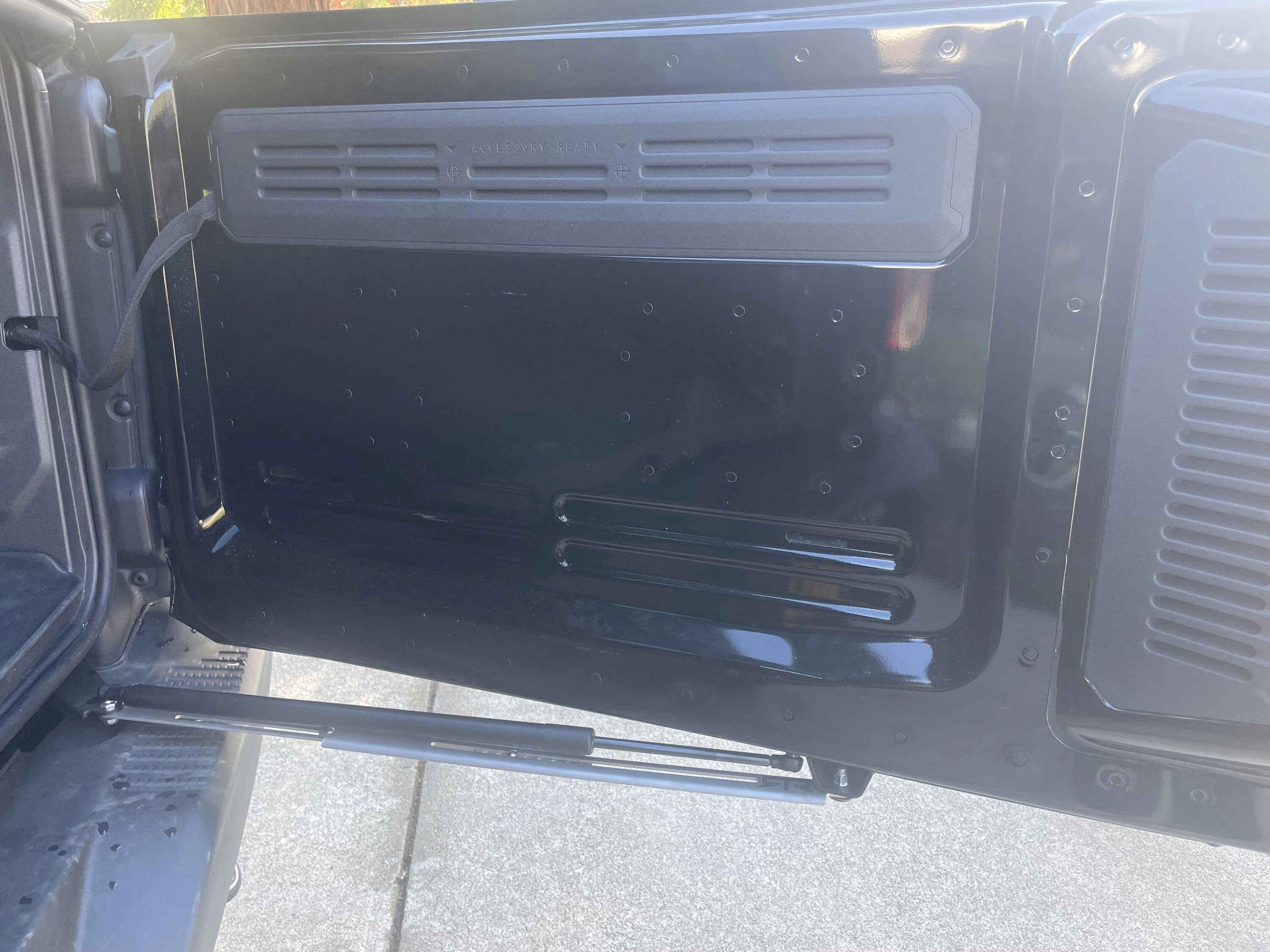

Here are a few plus a quick vid of it opening. I did have to use the provided bumper/ body mount washers as it didn't clear the bumper. (look at their instructions on the site). Cleared once I lodged those in. Hope that helps.

Thanks for the pics & suggestion to review the instructions, very helpful. Cheers.

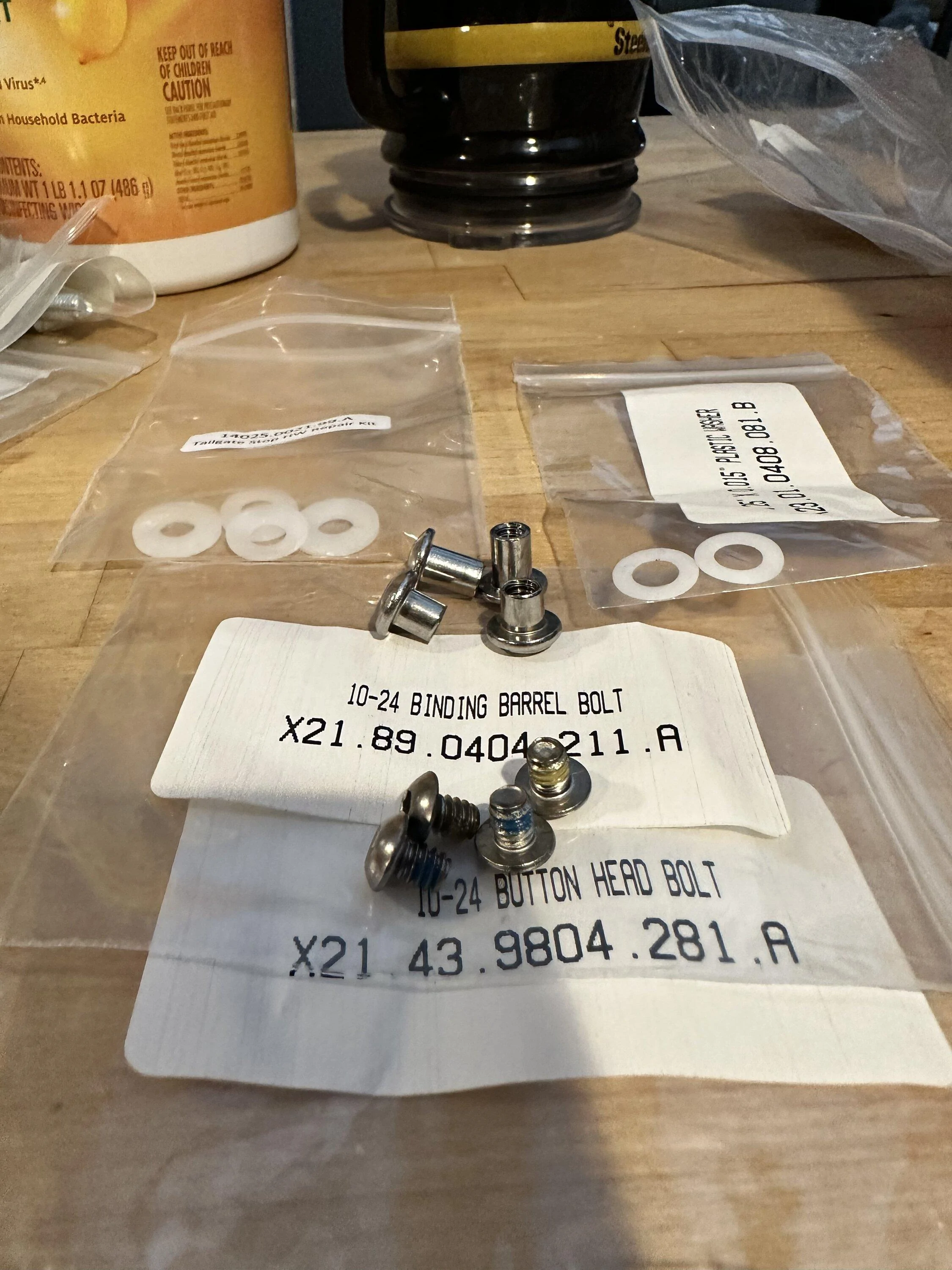

Anyone following along, I’ve got an update from RTR customer service from the form I submitted on their site. After providing some details about where and when I purchased the tailgate limiter they are sending me a hardware kit at no cost. They said the hardware had been redesigned with a longer barrel nut and bolt to prevent this rattling out issue. Very happy with the quick customer service and will update once I get it installed w a review of changes. I originally purchased mine in early May of 2023, not sure when the updated design took effect.

I received and installed the updated hardware today and things look promising. The longer barrel tightens down all the way and new set of plastic spacers eliminate the previous metal scrapping. So far so good. I am optimistic the design issues have been rectified! Thank you @RTR Vehicles stellar customer service🤙
