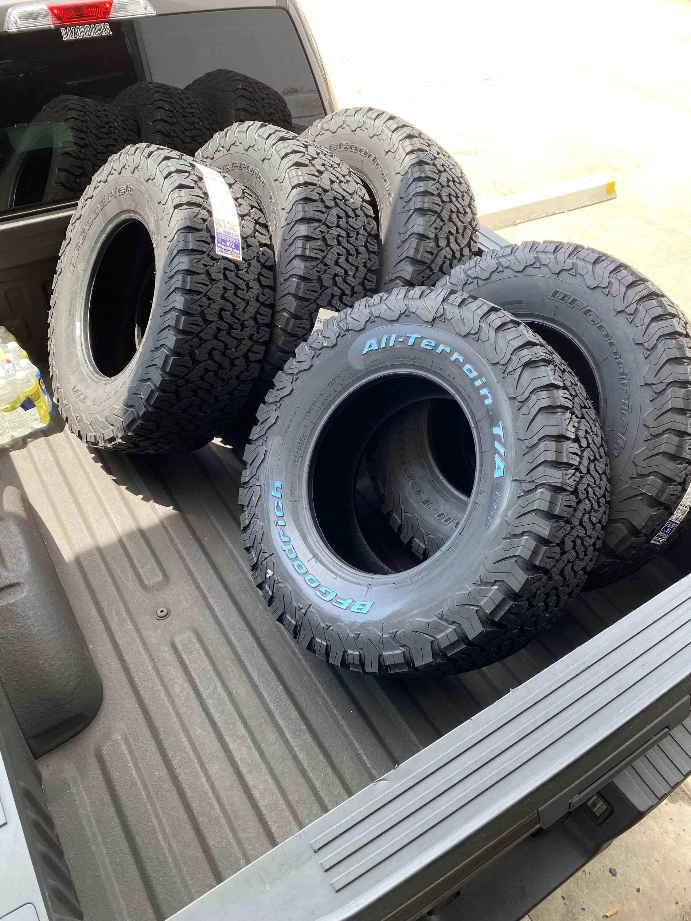

I didn't think you could get 35" x 12.50 KO2's on the outbanks wheels which are only 7.5" wide. I had 5 of them in hand a month ago and declined them, and opted instead to order some Toyo Open Country AT3's 285/75R/18 which are a little narrower at 11.2" wide and a smidge shorter at 34.8" tall Toyo says they will fit the 7.5" wheel. With the +55 offest on the OBX wheel and the 12.50" its got to be pretty darn close to the upper control arm. My tires should be in just after Thanksgiving so I'll let everyone know how it works out.

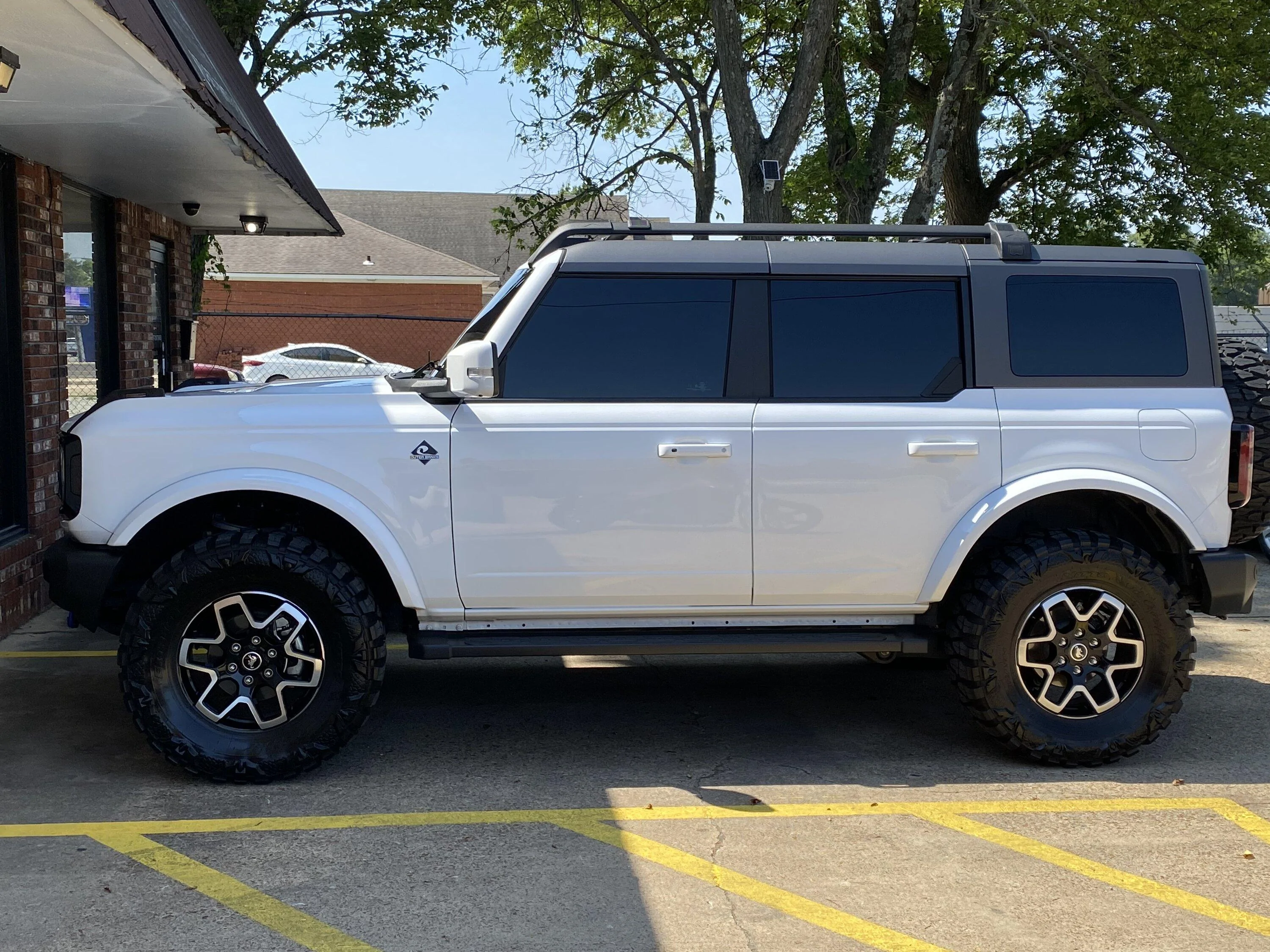

This is not my Bronco but I stopped and talked to the guy and he has 35 x 12.5 tires on stock OBX wheels. He said he had a 2" Rough Country lift and like a 1/4" spacer... No rub. So I ordered a set for ours that will be built the Aug. 15th.

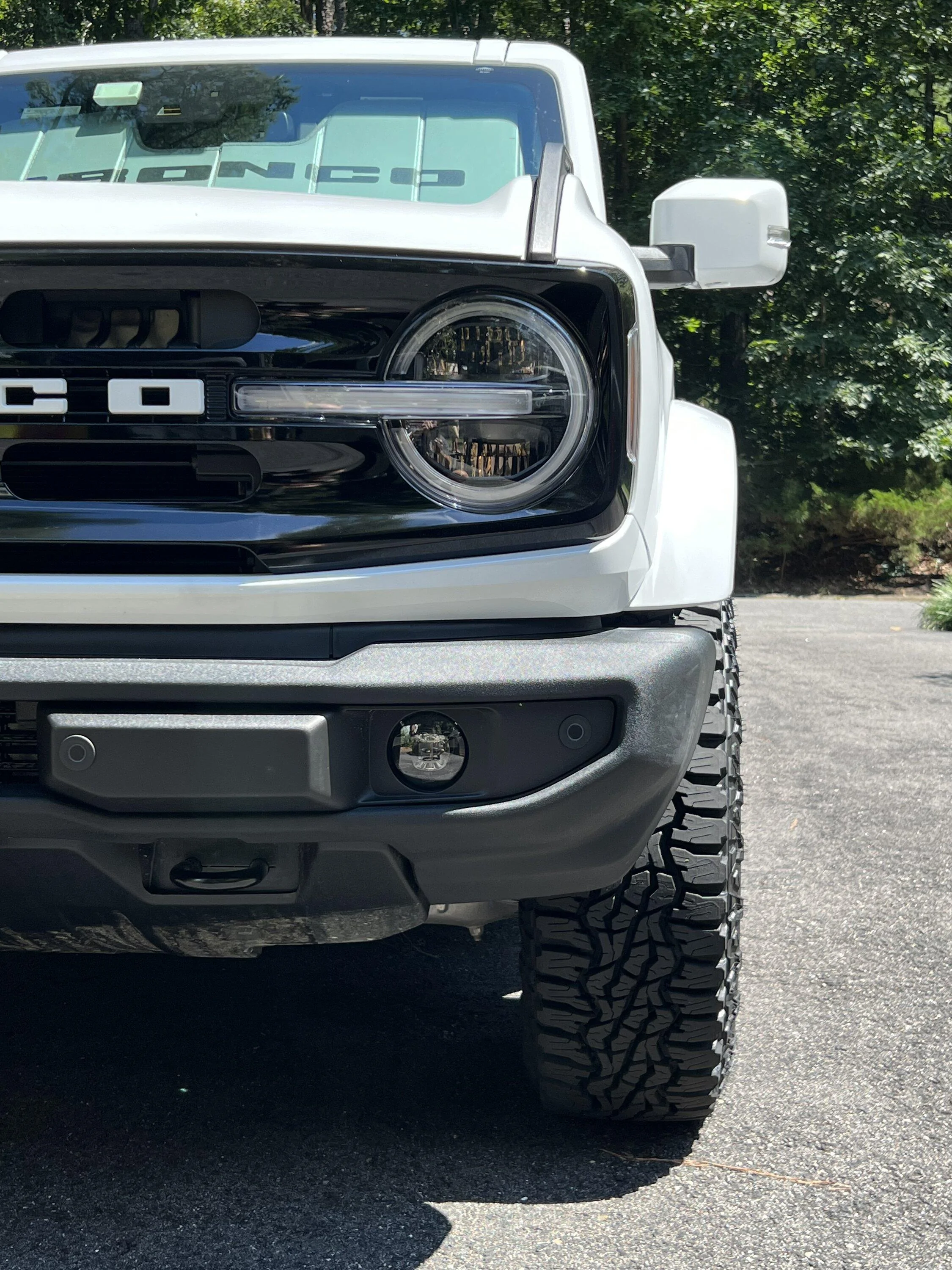

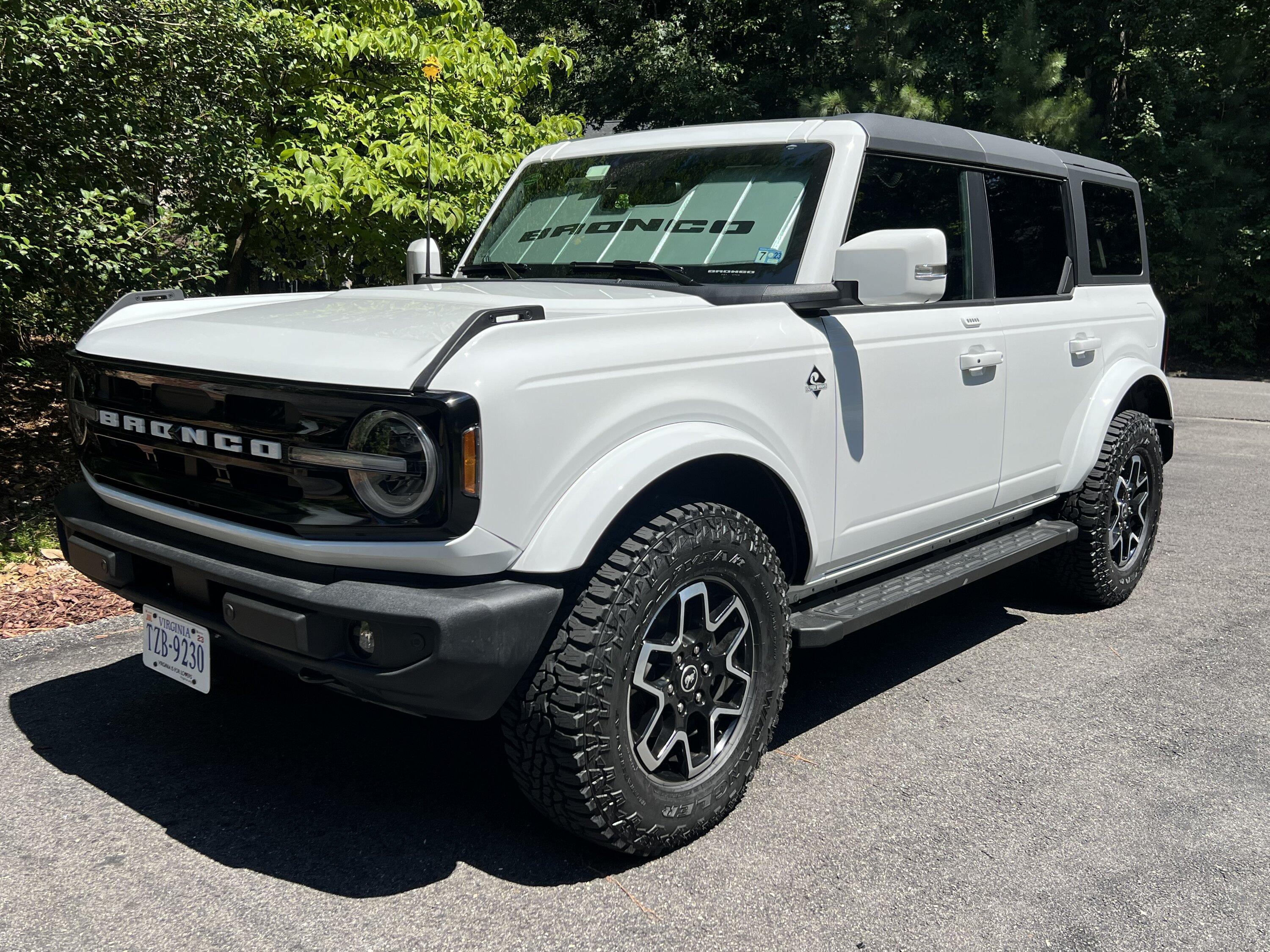

Stock OBSX wheels with 275/70/18 Goodyear Wrangler UltaTerrain Tires
Ordered a set of Eibach ProLift coil-overs to level it out, no rubs, no interference, wife is Happy!

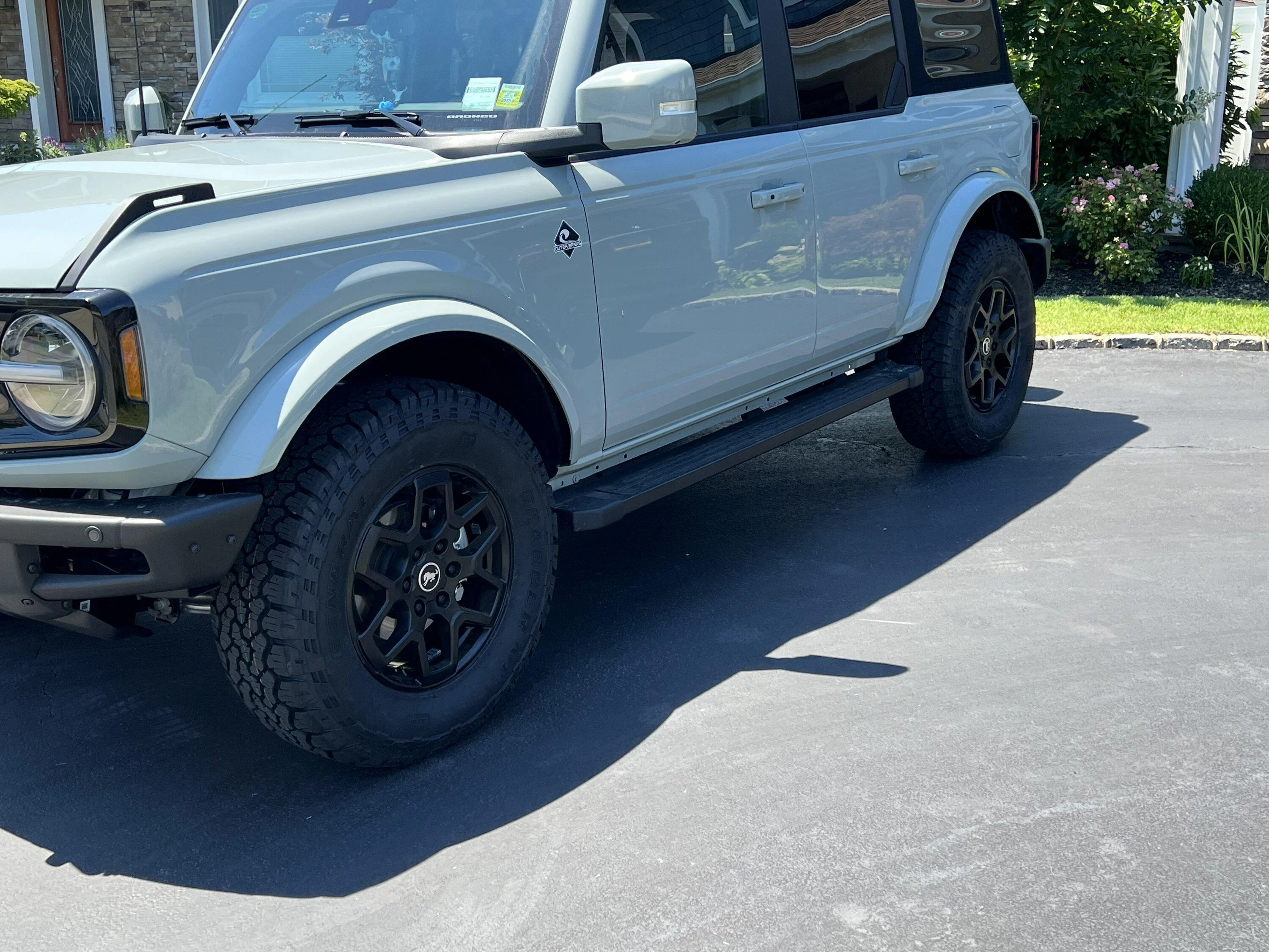

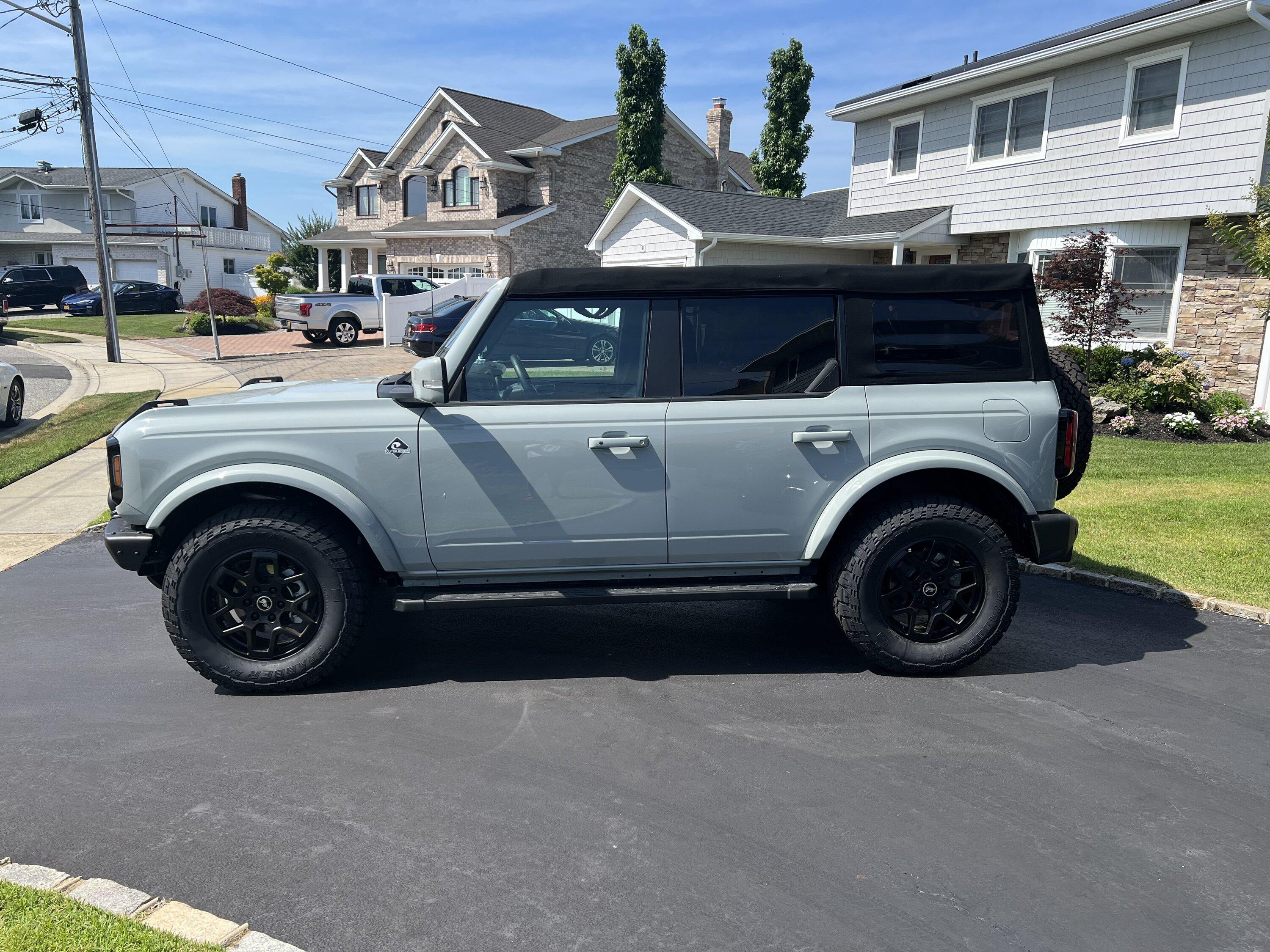

Followed the advise on the "Happy Medium" thread. Stock OBX, powder coated stock rims - satin black, OEM black lugs and grabber ATX 275/70/R18s

This looks awesome. I was planning to do the same thing. Gloss black paint on the wheels and 275/70/18 Grabbers. Thanks for the preview.
