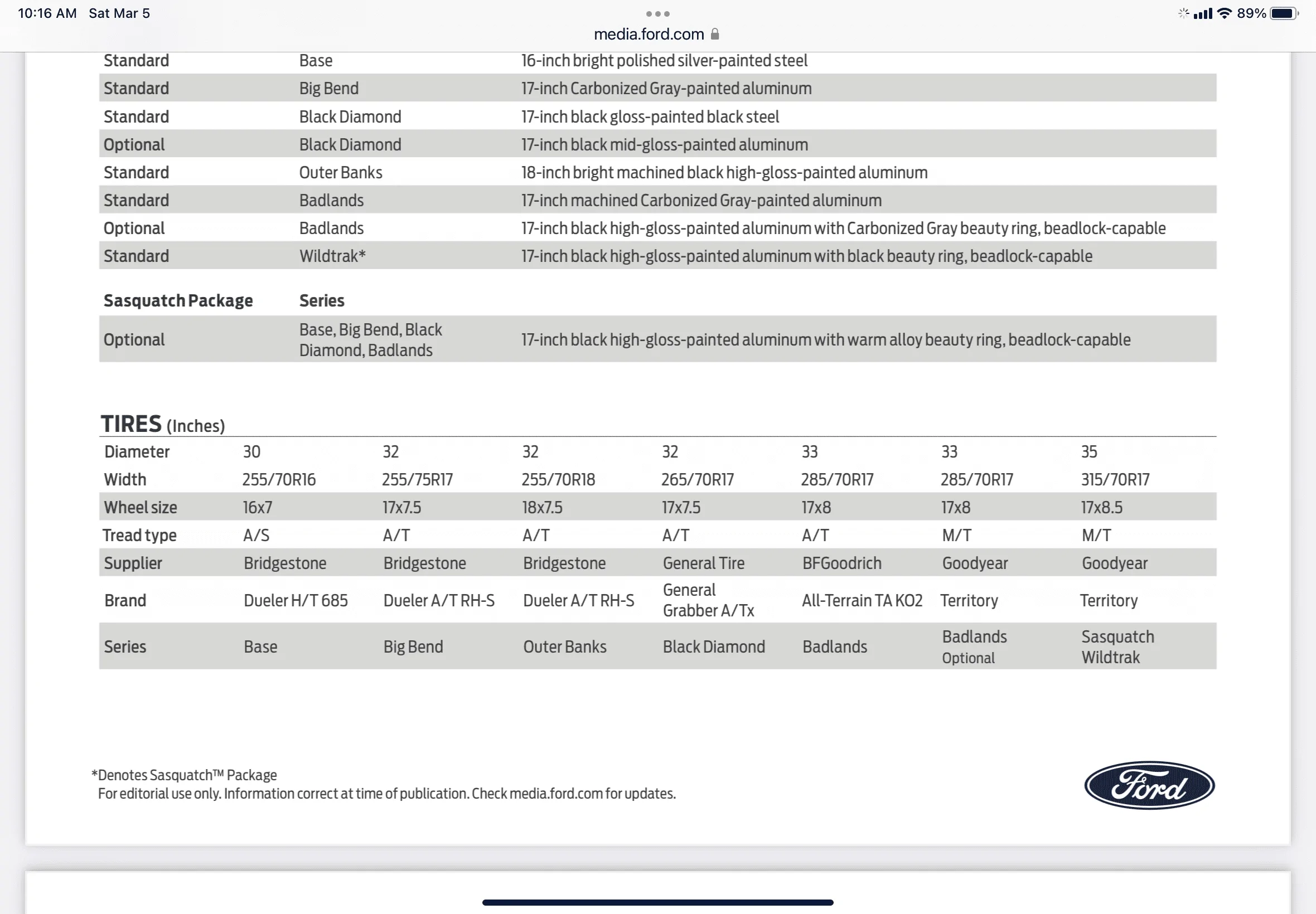

Thanks so much. Your rig looks great with these wheels as well and I see you are also using much larger tires. Should I stick with an 8.5 inch wide wheel with the stock KO2s in your opinion or should I expect any performance issue from using the 9" wheel?
A wider wheel will make the tire somewhat wider and also reduce the diameter some. I think the stock Badlands rims are 8” in width while Sasquatch rims are 8.5” wide.
Edit: I saw the tire width on a Ford spec sheet yesterday and I just looked for it online to confirm my memory but I can’t find it again so the above is based off my day old memory….
Second Edit: Found it!
https://media.ford.com/content/dam/...roduct/2022/bronco/2022-Bronco-Tech-Specs.pdf
https://media.ford.com/content/dam/fordmedia/North America/US/product/2022/bronco/2022-Bronco-Tech-Specs.pdf
Ford Bronco Show us your installed wheel / tire upgrades here! (Pics) B892DF4C-D721-4C22-9156-ECA9336C4E1A
Thank you for this. Not really looking to upgrade tires yet, in part due to cost, so I am going to hold off on the pro comp wheels until I can get a sense of how using the stock K02 on a wheel 1" wider than stock will affect on and off road driving, mileage and poke. Thanks
