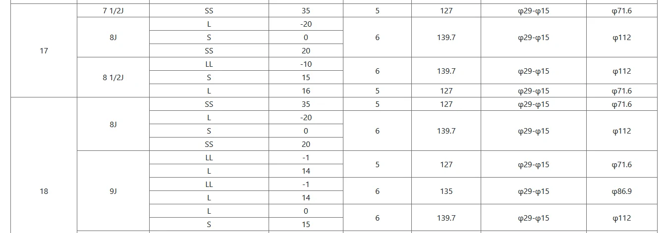

here are the specs for Volk TE37XT M-SPEC.
in 17x8.5, it is either -10 or +15 offset
in 18x9, it is 0 or +15
17x8.5, it is either -10 >> 2-4 months to order
17x8.5, it is either +15 >> 10-12 months to order
18x9, it is either 0 >> 2-4 months to order
18x9, it is either +15 >> 10-12 months to order
Runs $800-900/each (depending on size) and does not include center caps. Center Caps are like $40 each
Ford Bronco Show us your installed wheel / tire upgrades here! (Pics) 1647264442849
I'm not sure if anyone has seen these. Volk TE37XT M-SPEC. A good amount of size and offset options (black or bronze). Forged wheel, so it'll be strong and light weight (17lbs for 17x8.5). I'm considering these once my Bronco comes in.

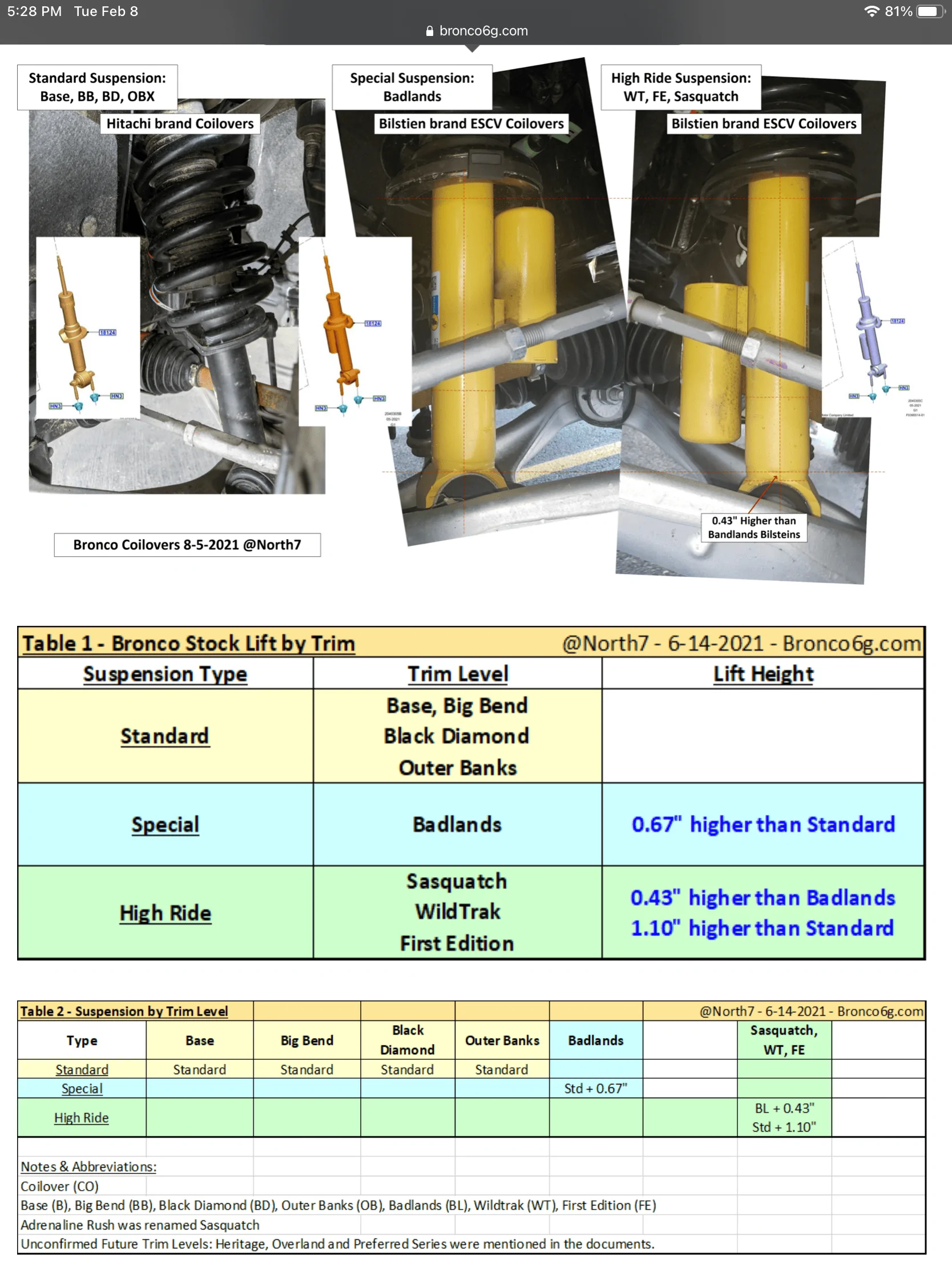

what's the stock lift size that comes with the badlands?
There’s a thread on the forums that covers this very well, but I couldn’t find it. The attached image is from that thread.
if I find the thread, I’ll update this reply to include it.

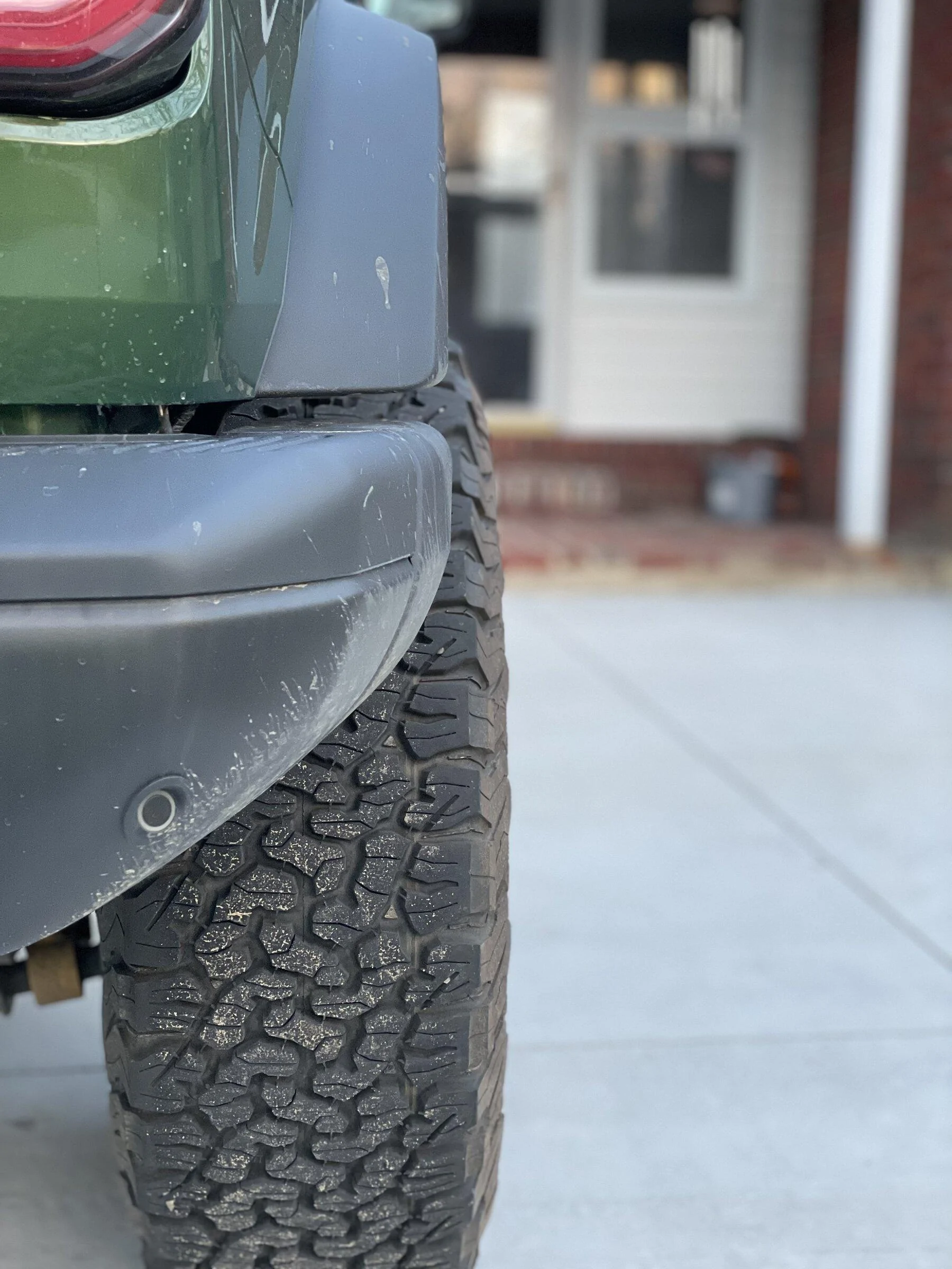

Do you have any pictures of your poke w/ the +18 offset and this size wheel/tire combo?
Thanks.
NJRoadkill
Oct 29, 2021
432
955
South Jersey
www.instagram.com
22 Bronco Badlands 2.3l Manual
Thanks.
When I put the straight edge to tire, tape to fender, (rear wheel) there was 1/2” poke OEM.
New wheels [email protected]. Same method, same tires, 1-3/8” poke

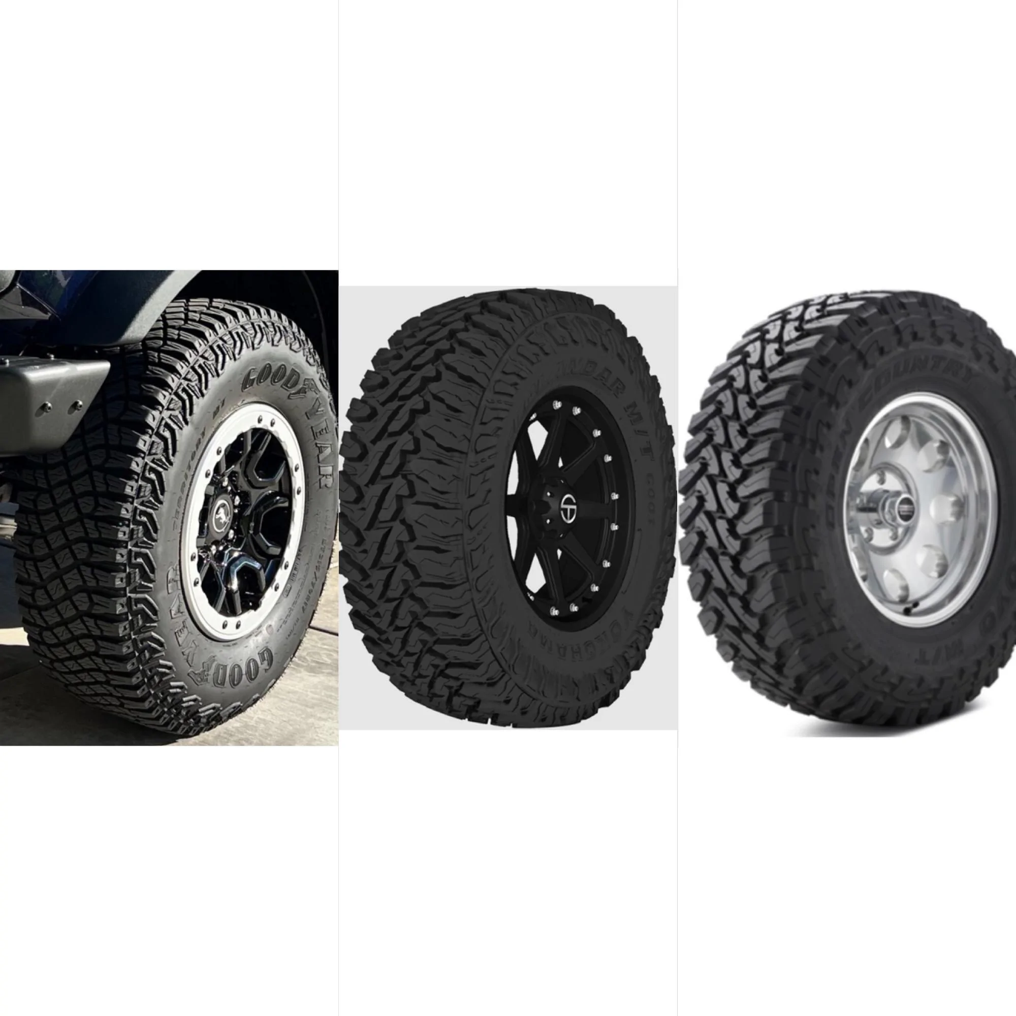

For those with 35's who is not having rock fling issues and what did you change to?
Inlinejohn
Feb 6, 2022
56
1,105
906
WA
Several
I’ve heard Toyo M/T and Yokohama Geolanders might be a good choice for dealing with this problem. I’m gonna go Toyo. You can see the tighter tread pattern of the OEM Goodyear tire which is more like an A/T tire and is holding on to the gravel/rocks when driving slow then once you get some speed, the tread separates enough to dislodge the rocks and alas fling all over your rig. The other tires shown have a wider more rugged tread pattern and most gravel does not stick.
