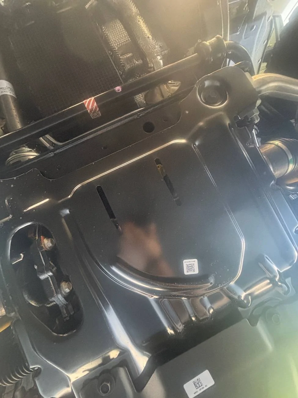

Yea I think I see what u r talking about
Had to crawl under my car real quick but I think mine does have the 2nd engine plate behind the initial bash plate with my “capable” bumper so I think I got that covered.
Ford Bronco Skid Plates Priority IMG_5553
I’ve been on keeping an eye on the OEM “full body” plate but I already have half of it (the set minus fuel tank and transfer case) so it feels kinda pointless.
I think I’ll take up @B22-2023 ‘s advice on the rear lower shock mount covers and call it there.
