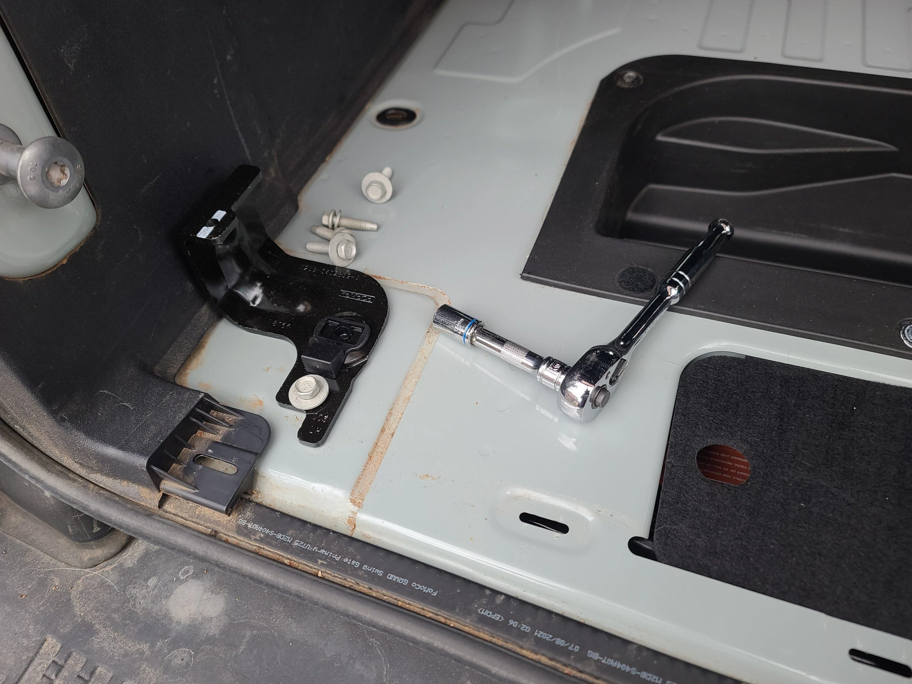

You use the same bolts from the existing latches, the don't come with that part.
Ford Bronco Slide out tailgate install - '21 BL Sas 20230128_133435
Ah good to know. Since the first page of the packing slip listed the bolts with quantity, I was expecting the kit came with the bolt hardware.

Sheesh... Thanks guys for chiming in. Sounds like unless I want a work out and *hope it doesn't strip and "self-threads" by nature of strong arming these bolts, maybe buying a tap is worth a few bucks?
That said, when I hopefully get the bolts in my third order attempt, I can take them to the hardware store and test thread sizes. Until then, for those who had pre-tapped the brackets, any idea what size tap to purchase?
Thanks guys.
I also received my brackets without the threading done so had to do it myself. For future reference to anyone else that has this problem it required a M8-1.25 tap.
Yeah seems that norm from what I'm hearing.
Ford dealership where I picked it up said : "That's normal as Ford chooses to have you thread on the go via screwing the bolt in without it pre-threading for some applications. "
I'm like.... Erm... OK? All said, I happened to have the M8-1.25 tap on hand from something else on Bronco I had to fix prior, so I just pre threaded it and worked fine.
Note : Perhaps in just my case, but when I carefully / slowly pre-threaded it myself, I did notice that when it came time to bolt it down in those tapped spots, that although the bolt threaded very cleanly and decently snug, it did feel just a bit weak on tighting that I stopped a little short of the recommended torque specs in fear of stripping.
Otherwise easy peasy nice and smooth.
