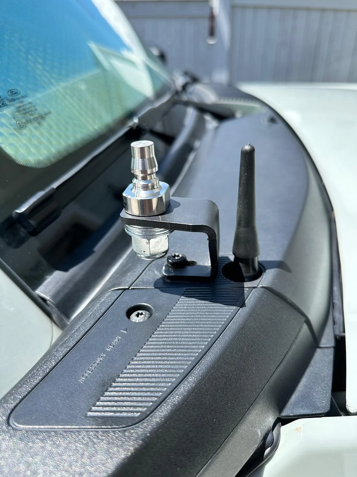

I recently to a trip to a state park that required a dune flag (Sand Hollow State Park). I bought a flag, not thinking that it wouldn't be mount-ready. For the trip, we rigged up something behind the spare tire, but that left me trying to decide where I should mount it in the future. I have the capable bumper (without the detachable endcaps), so that ruled out the mounts I've seen for the modular bumper. I found a mount that attaches to the spare tire carrier, but I'm too OCD to want to see that attached all of the time without a flag. Plus, some parks require flags to be mounted to the front of the vehicle. There are mounts for the trail sights, but the flag would interfere with GoPro video. I got the idea of mounting a flag at the accessory mount of the rearview mirrors, but I couldn't find any. I did find a pod light bracket kit for the F-150 that looked like it would work. When I got it, I realized I would need to drill out the hole for the flag (the minor DIY part), but otherwise, it's a perfect solution.
Ford Bronco Slightly DIY dune flag mount solution tempImagebPnQVQ
The bracket is angled so the bolt that attaches it to the Bronco is easily accessed with the wrench and Torx T30 bit that comes with the Bronco toolkit. The bracket can be rotated in any direction. That's my 2.5" stubby antenna for reference.

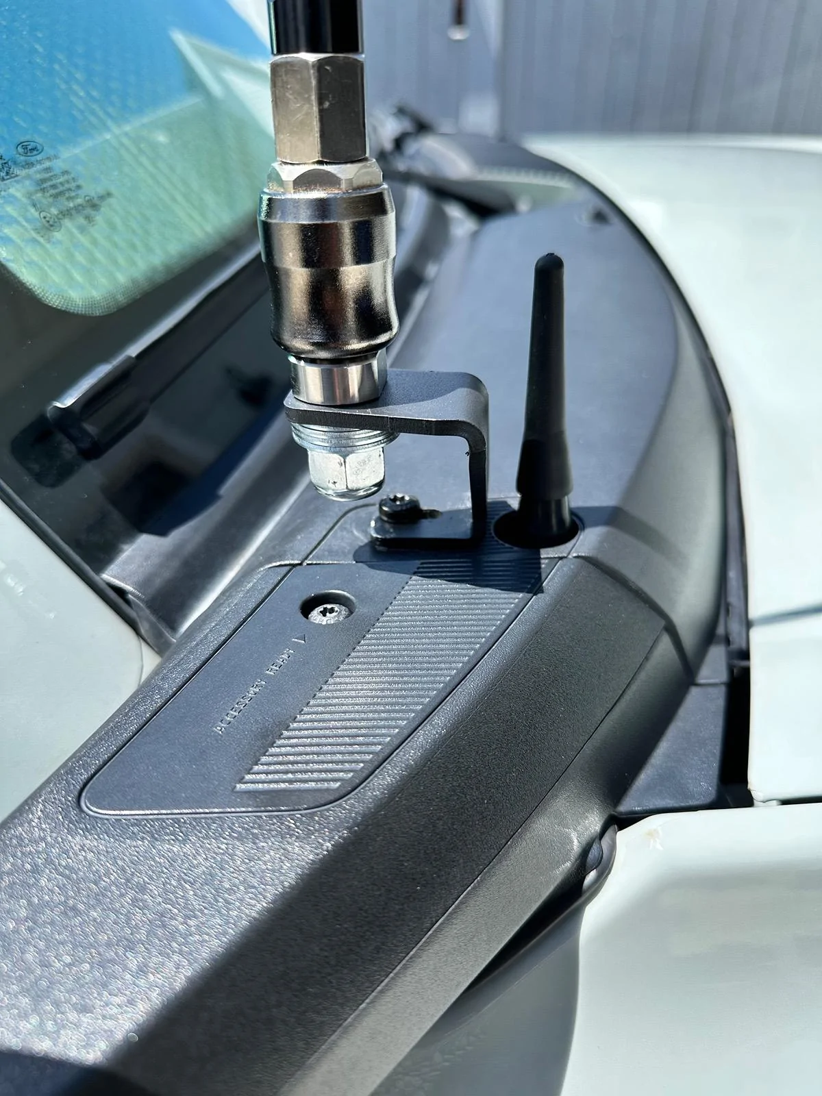

The flag can be easily detached with the quick disconnect when we want to get back on the road. When I'm done using the flag for the trip, it takes only a minute to completely remove the mount, if I want.

That seems like a lot of stress on that one small screw holding the bracket in place.
Agree. Tall flag puts a lot of leverage on that one screw. My pod light mounts use 2 screws to attach and would be twice as strong.
I'll admit I haven't tested this yet, but the width of the bracket spreads the load and should prevent sideways flex so that the screw only needs to supply the downforce. But we'll see. I don't have a lot invested in this, so I'm not afraid to take the loss if need be. The flag is pretty light, too.
If I had seen something that used both screws, I would have gotten that, as long as the price was reasonable. I don't have the tools to fabricate anything. I liked that these are aluminum.
