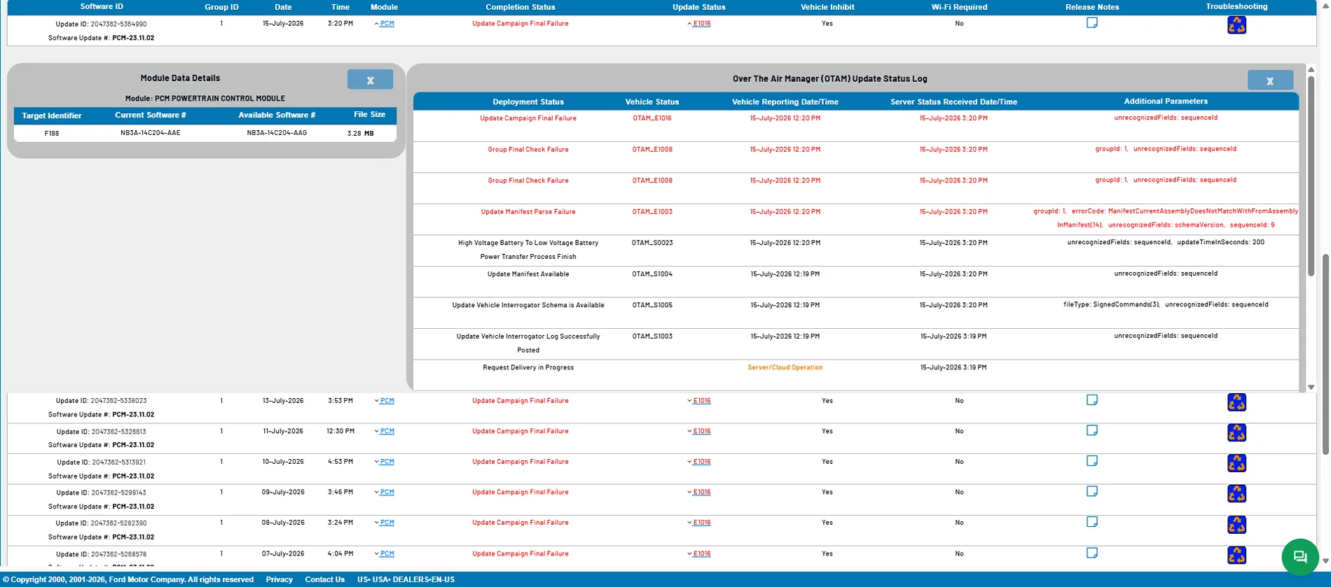

Just like the other guy, it has failed many times with the same manifest mismatch. The same OTA was sent to you again 3 hours ago and will most likley fail again then time it tries to install. it's only one file in the F188 location which is the strategy file.

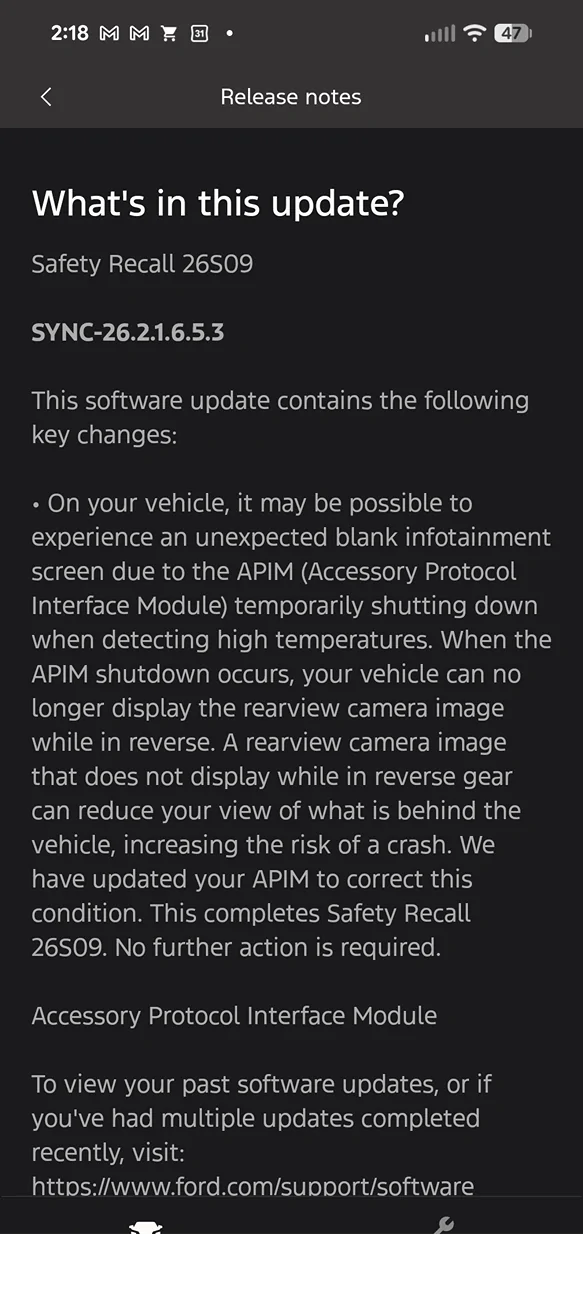

OK. Curious because I got letter notification yesterday that my Infotainment screen blackout recall has been fixed via an OTA update in May. The app says it was an issue with the APIM, but wondered if this HVAC update could be related since it was a heat soak problem with APIM. Experience has shown me that two seemingly completely unrelated things sometimes are not.
Ford Bronco Software update error message on PCM-23.11.02 - Not Completed Screenshot_20260716-141824
Ducati1098
10,000
23,250
Midwest
Yeah I think that’s unrelated.
If they were going to use the HVAC module somehow to help with the APIM overheating, it likely would’ve been included in the same recall (26S09)
Not to mention, there’s really no plausible way to make the HVAC help prevent the screen from overheating.
