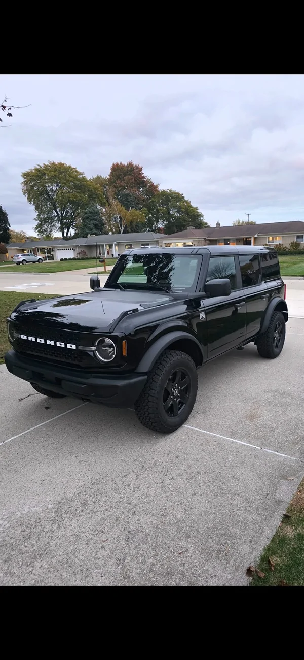

Ok so this is what I'm working with. I have a 2025 bronco big bend which I'll attach photos. I already have my front struts which I'm using to level out my bronco as well as new upper control arms, im just waiting on the rear fox struts to come in and my tie rod sleeves which both come in on monday. Im using my stock wheels and I'm adding toyo 315/70r/17 tires, and I know there are people out there that say that tire doesn't fit, but I have seen enough people use this tire on their stock rims and it works. My question is do I need spacers because of the offset on the rims itself. Im not going off roading as well, its simply a daily driver and I'm looking for a more aggressive look. I was going to buy new rims but the daughters tuition just went up 2800 a year so there went those funds. So do I need to add around a .75 in to a 1 in spacer or am I good with what I'm doing.

I dont even know when I would hit a full lock out this is strictly a daily driver, I just want it to be a little taller with bigger tires and a more aggressive look.
