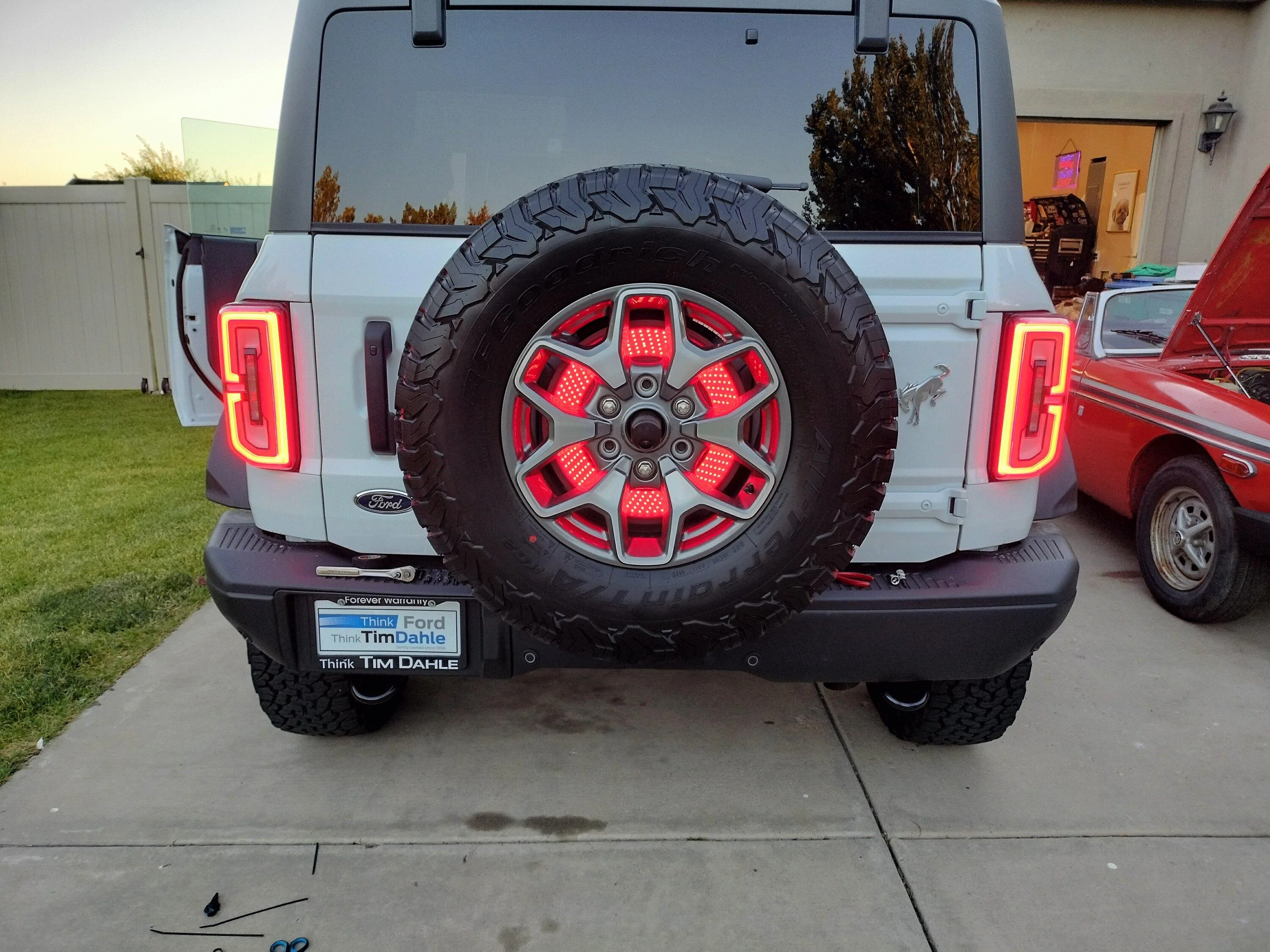

I like this one on mine. I was able to remove the factory brake light that stuck up a little bit, and also folded back the rear seat headrest. This way I get a clearer view out the rear window.

That looks clean.
Could you link the spare light?

Was this a plug and play or did you need to spice into the taillight wires?

Plug & play from deep in the Amazon!
Have Sasquatch rims on it now.

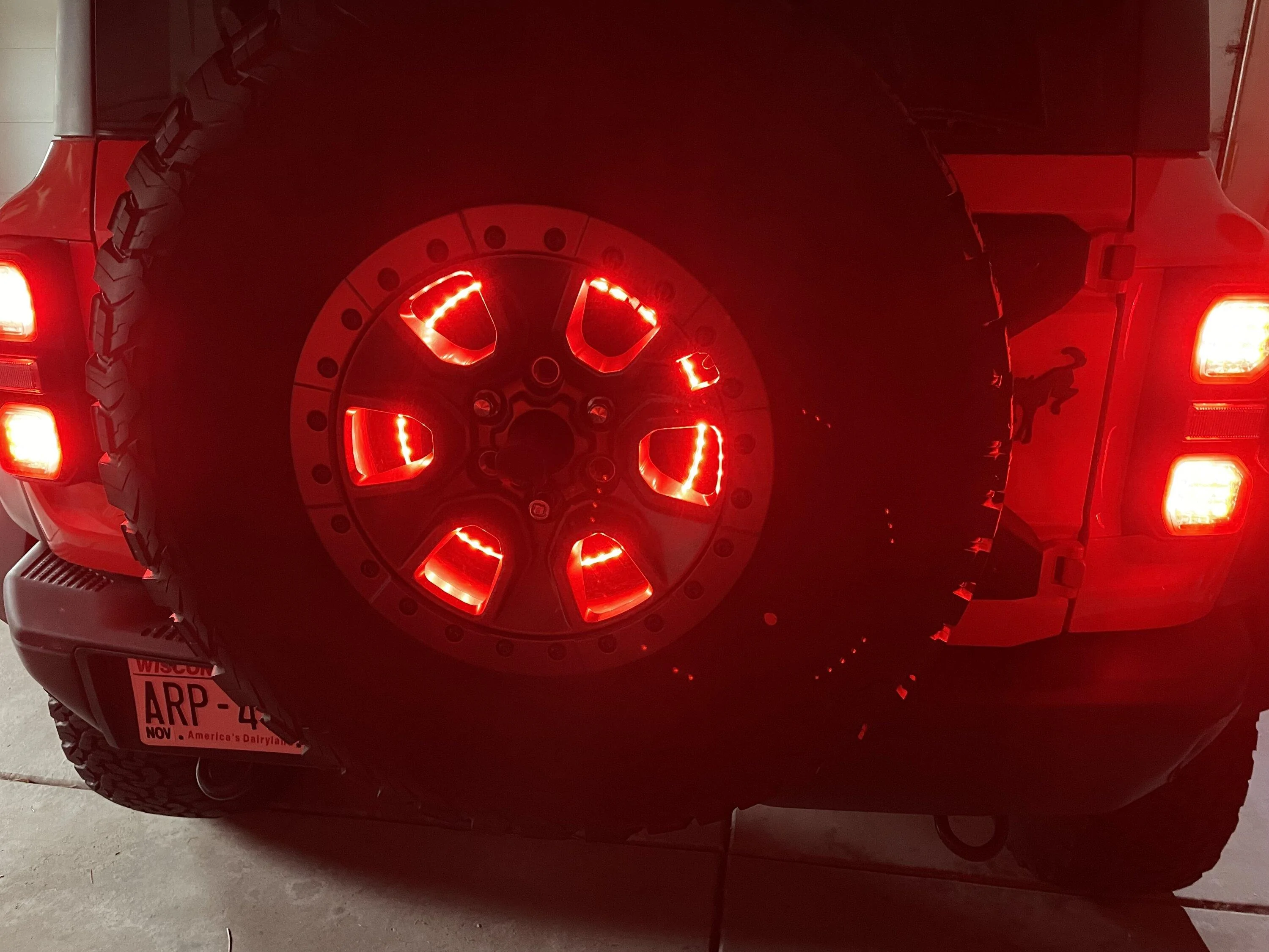

I used this one. I’ve been on the fence about recommending it. Now that it’s installed I do like it, it’s just their install instructions and customer service are weak. They state:
“Bronco Models without towing package and separate turn signals will not have a running light feature”
It basically forces you to tap into your tow package wiring near your hitch to get full functionality. I live in the road salt northeast and this wasn’t a good option for me, so I figured out a better way tapping into tow module on driver side in the cargo area and pulled the reverse light from the drivers side rear signal. Works fantastic now.

Here is the link....
OFFROAD GAMERS Spare Tire Brake Light for Bronco Third Brake Light Plug & Play,Red LED Wheel Brake Light Compatible with Bronco 2021 2022 2023 -Present 2 Door or 4 Door… https://a.co/d/8y8JzvS
