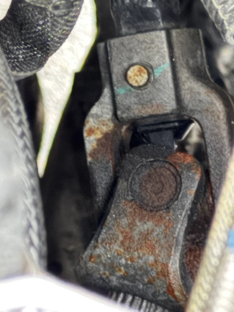

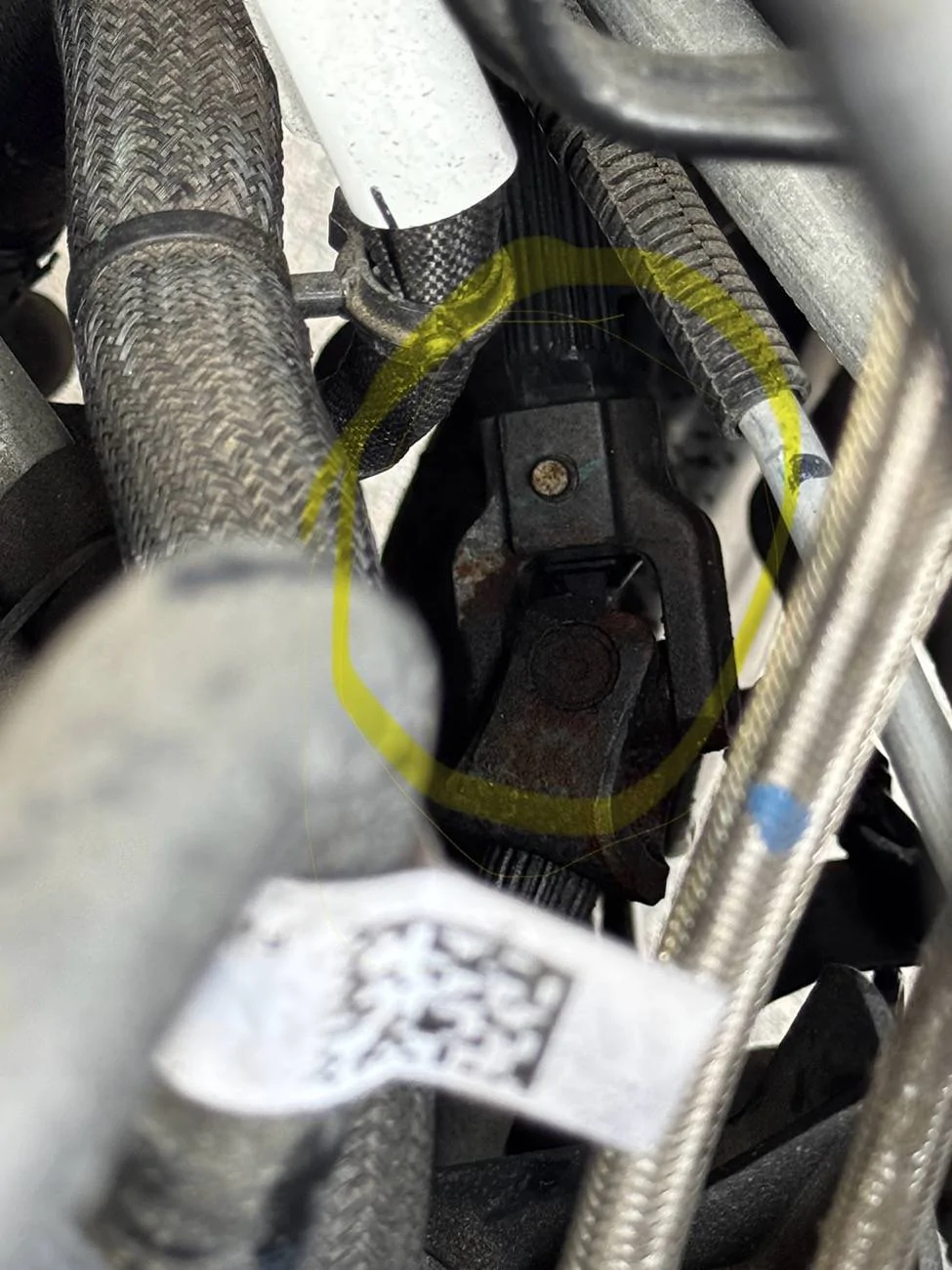

Been feeling a strong steering resistance at certain points in my Bronco big bend ‘21 no Sasquatch. Under 40k miles ! I scanned with forscan. Deactivated nibble function and highway ‘don’t react to movements as much’ feature . Then I bought a topdon tlink j2534 adaptor and used a 2 day fdrs license to reset and update the pscm. No change. Then disconnected the passenger side tie rod and removed it, removed one bolt securing the steering rack loosened the other one and dropped the rack towards the ground on the passenger side. Removed the cover over the electric belt drive with 7 x #30 torx screws - all looked perfect . No plastic or aluminum slivers . Put it all back together. Then finally found the problem ! The lower steering shaft universal joints were seizing . Sprayed with WD 40 to confirm. Steering which the day before had been unsafe to drive with was fixed instantly . Will replace the lower shaft.

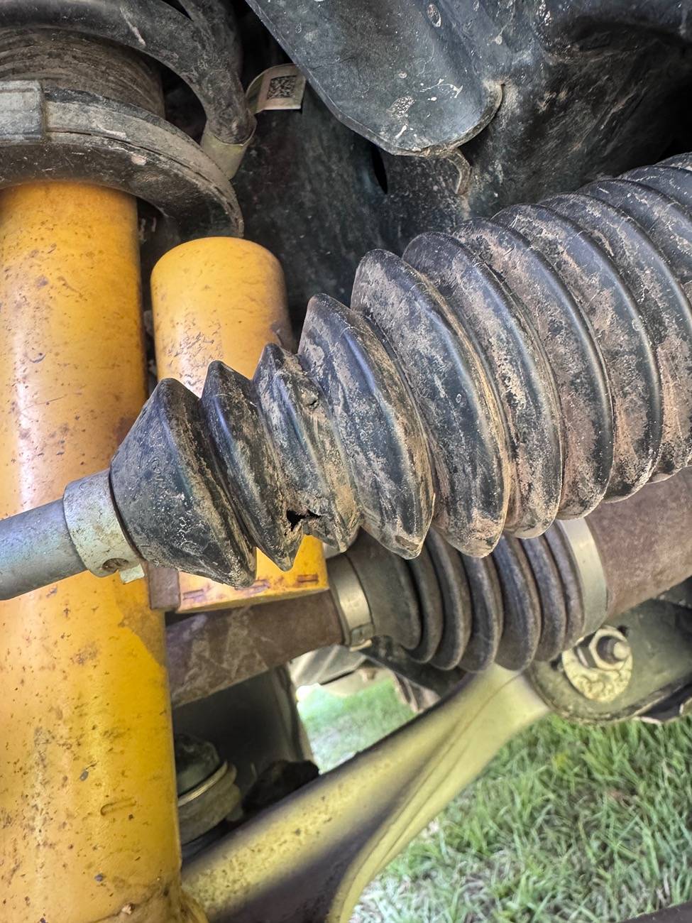

I had a stick tear a boot and then well down here its all mud and not much crawling so yeah it got filled with water

Someone recently had a faulty/partially seized joint on their lower steering shaft on a different thread. That’s probably one of the first and easiest things I’d inspect.
I had exactly this . Pulled the steering rack half apart looking for failed bushing and updated pscm first with fdrs. Didn’t help. Then I found the rusty culprit. Quick spritz with WD40 fixed it (temporarily until I can replace the lower shaft) . The steering wheel would not even return to center and had very stiff resistance at points . Now it’s almost perfect.

Check your boots for tears. As I tore mine and water got in and it started making grinding noises and randomly locking up.

just WOW, got referred to this thread after posting an issue with steering, sprayed some WD40 on the 2 u joints in the steering columng (2 that I found, how many are there) and it worked!

Yes! Love it . There are 2 joints - you nailed it. And if it reverts to binding up again replacing that part is a) easy b) way cheaper !
