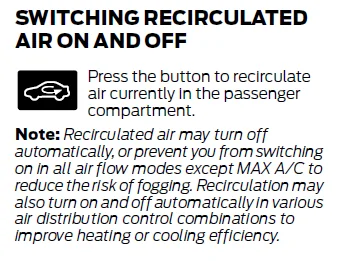

Discovered the same issue while we did a road trip over the summer. Based on what the manual says, it will turn recirculate on and off on its own to reduce fogging risk.
From manual:
Ford Bronco Blower fan speed inconsistent Screenshot 2022-07-10 052638
Only thing I'm not sure on is when its in vent and at highway speeds, it does come in a lot faster.
