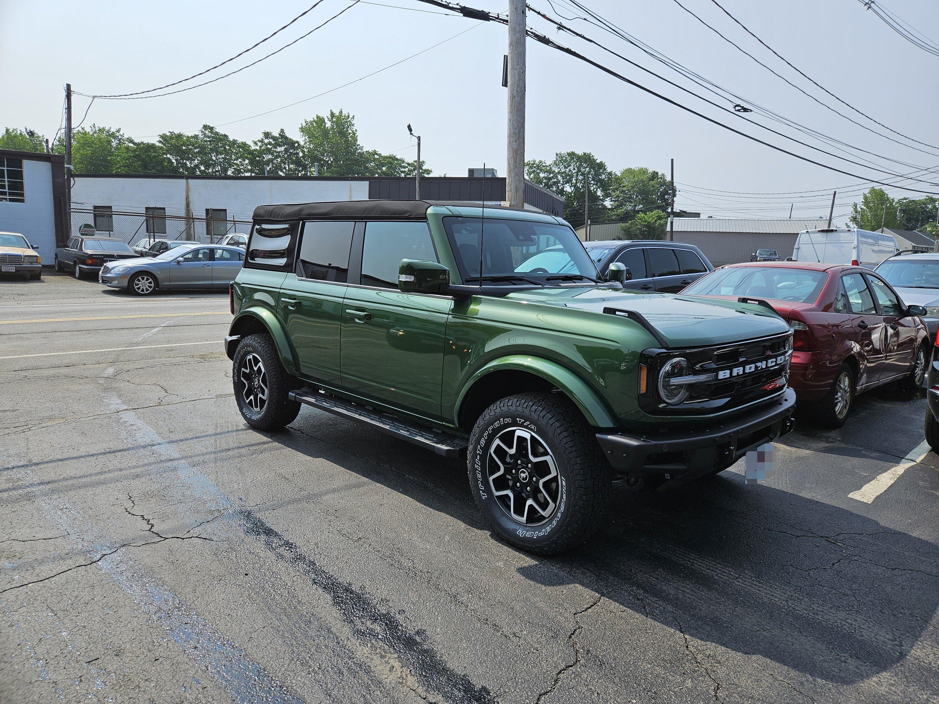

I picked up a 2023 4 door obx non sas and the first thing I did was swap tires to 275/65/18 bfg trail terrains. They are the same 32 inch height as stock, just .8 inches wider. My first drive on the highway it was pretty shaky. Took it back to installer and they rebalanced all the wheels. Took it on the highway again, it was better but still a bit shaky at 75mph. I had the installer ride with me and they agreed something is wrong. He ordered two more tires and swapped the ones that used the most weights. It definitely rides better, but I still have a very slight vibration in the steering wheel at 70mph to 75mph (lane keep assist is off). Hunter road force was used to balance, tire shop is well respected. So, after this whole fiasco I doubt it's a tire balance issue. The steering wheel doesn't shake, it's more like vibrations. I just feel like it should be smoother like everyone else says on this forum "it's butter smooth ". Definitely not butter smooth for me. I'm going to re torque when I get home, I doubt that's the issue anyway.
Any ideas?
Thank you!

That's a pretty chunky tire. I've noticed that if my grabbers are inflated to 40-42 psi, they will transmit a bunch of vibration and shake. 38 psi and lower they really smooth out. Mileage will vary.

It looks chunky, but it's more on road focused than the all terrain Ko2. Tire shop said this is a favorite for jeep grand cherokee owners and it has a smooth ride. I have psi at 36 all around.

Update: Tire shop is helping me swap into another brand. Hopefully that helps as these BFG's are not cooperating with the bronco. I think I'm going with falken wildpeaks. It's a shame because I love the looks of the BFG's, but the ride is not smooth.

This is what was puzzling me the most. I thought maybe this is just how the bronco drives? But my 2011 f150 with half worn tires drives smoother on the highway than my new bronco. I don't think that makes sense. I'm even planning to test drive another bronco just to compare.
The tires are a passenger load. They feel soft and give a great ride on back roads. Just on the highway it's constant vibrations in the steering wheel and doesn't give confidence at speed. It kind of feels like I have a rock stuck in a wheel throwing the balance off (I checked many times for rocks).

Ok got ya. Yes the Bronco should ride the same as your F-150 generally speaking, I have an 08 F-150 and it rides like the Bronc. Sounds like the balance may be off or you still have a bad tire on there.

I am happy to report that the issue has been fixed! It was just bad tires that wouldnt balance right. The tire shop let me swap to Falken wildpeaks at no charge. They were a night and day difference. Thanks for your help everyone!
