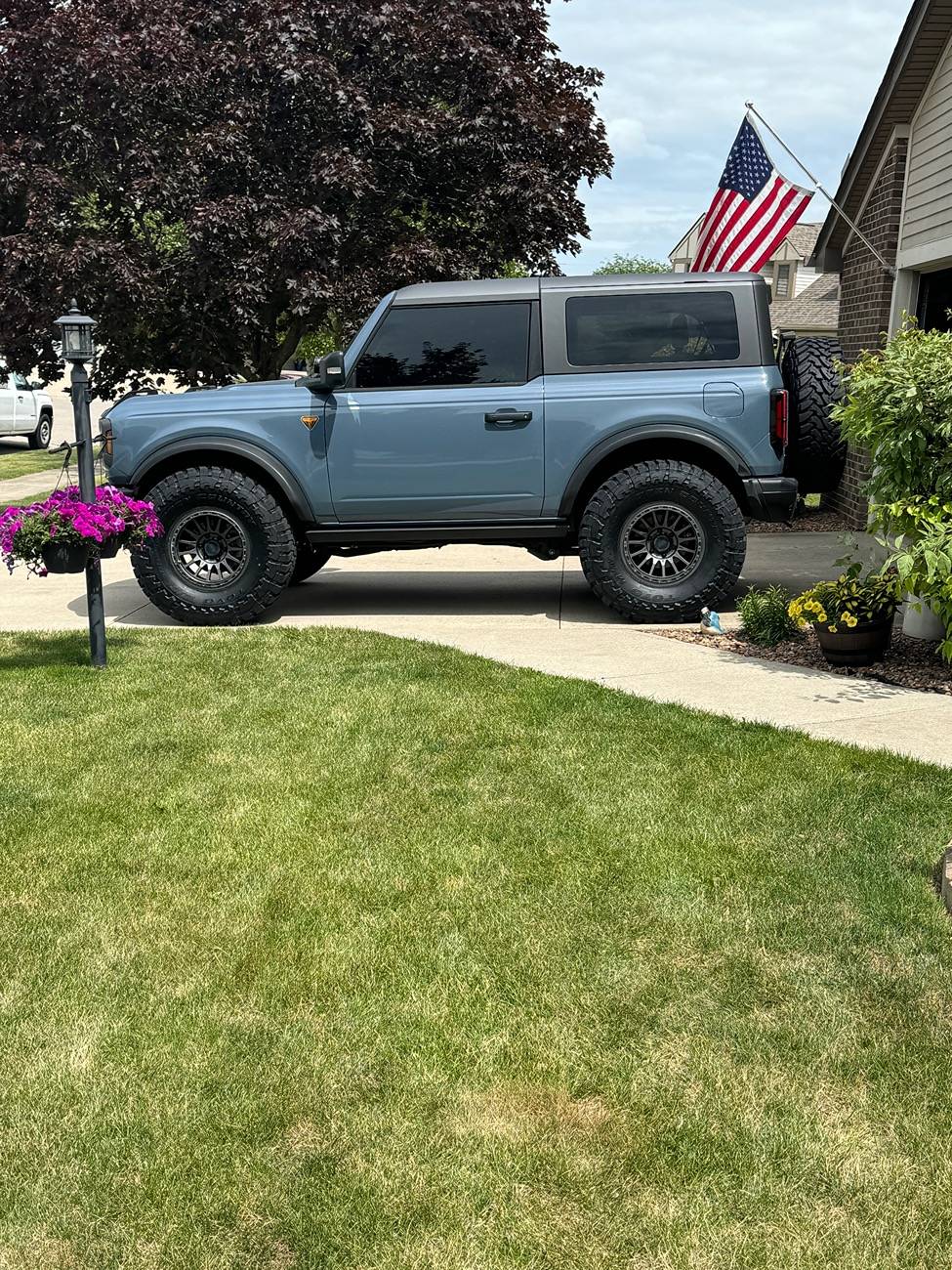

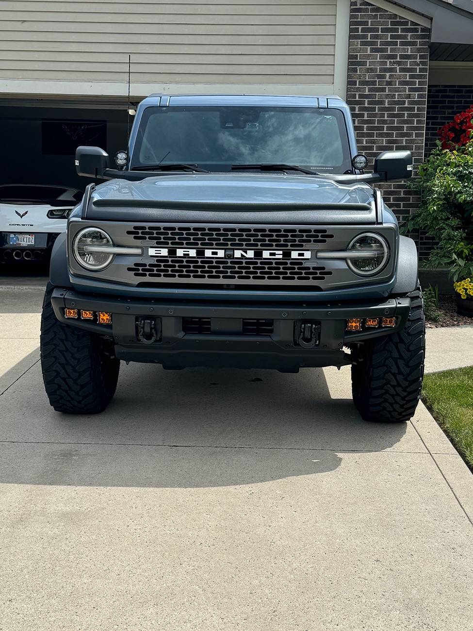

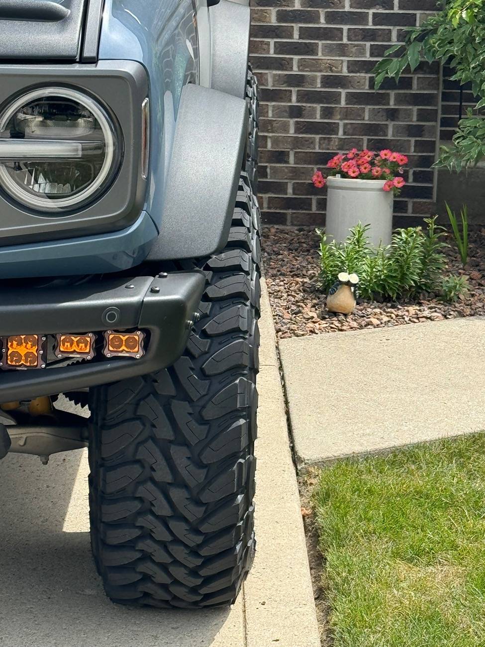

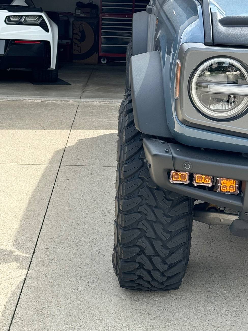

It will rub at full lock going forward and while reversing unless you chop the crash bars out or throw on min 3 inch lift. Here’s mine on 37s on stock sas suspension and with a 8.5 wheel and 0 offset

I haven’t yet. Since those pictures I threw fox coilovers on it and have 0 rubbing issues on road. Off road is a different story.

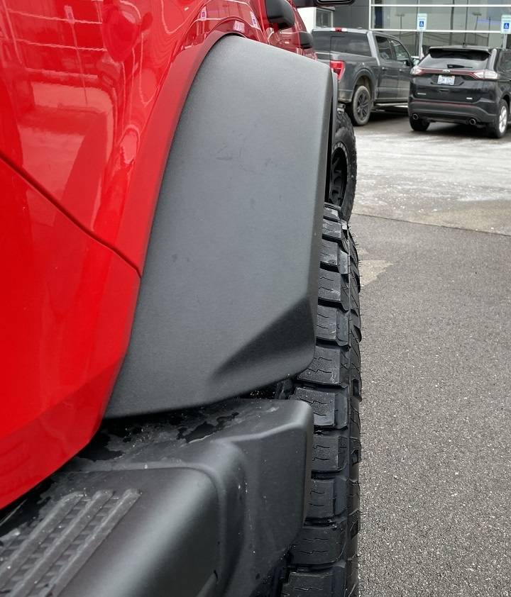

Here's a picture I grabbed off here of someone with 18x9 -12 offset. They do stick out a bit past the Sas flares. I think the +6 to 0 offset works best for 9" wide wheels.
