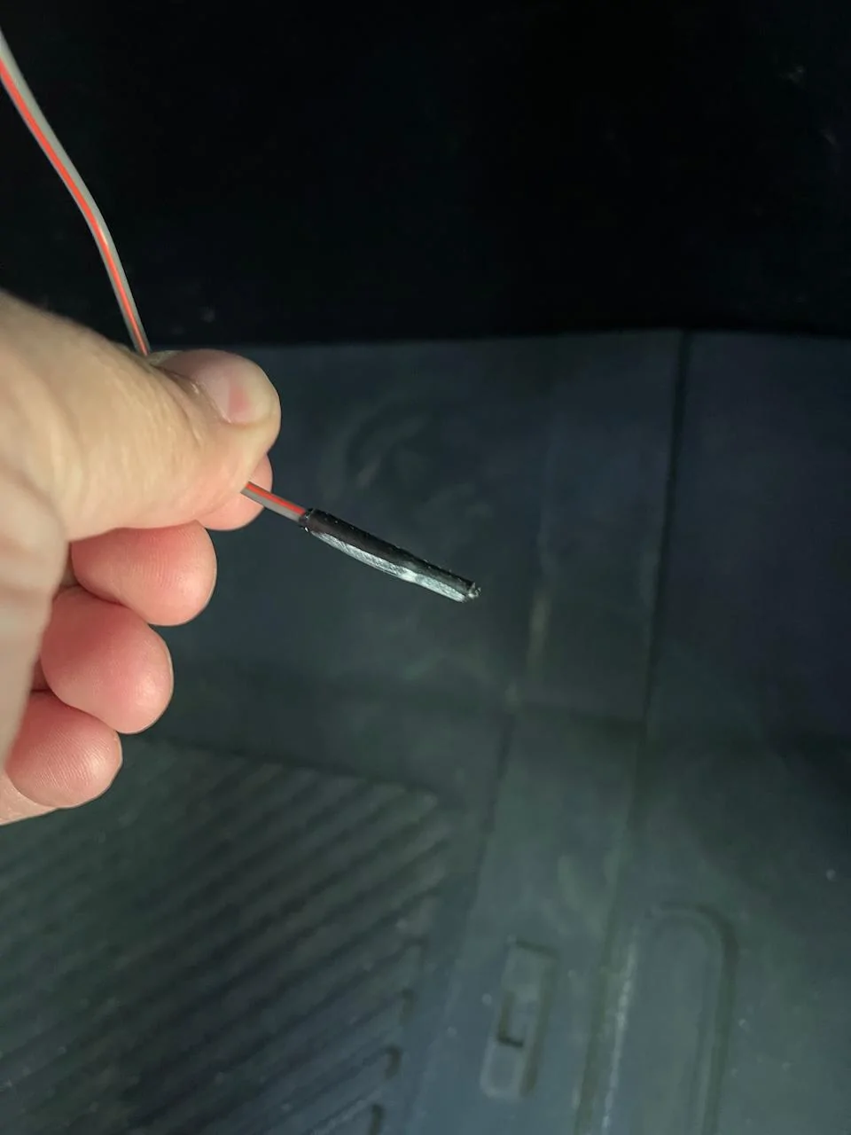

Anybody know what this might be? 3 week old 4dr Wildtrak.

Is it hanging down from under your glove box? If so, could be one of your non-powered aux cables, probably the one that runs to your right-hand visor.

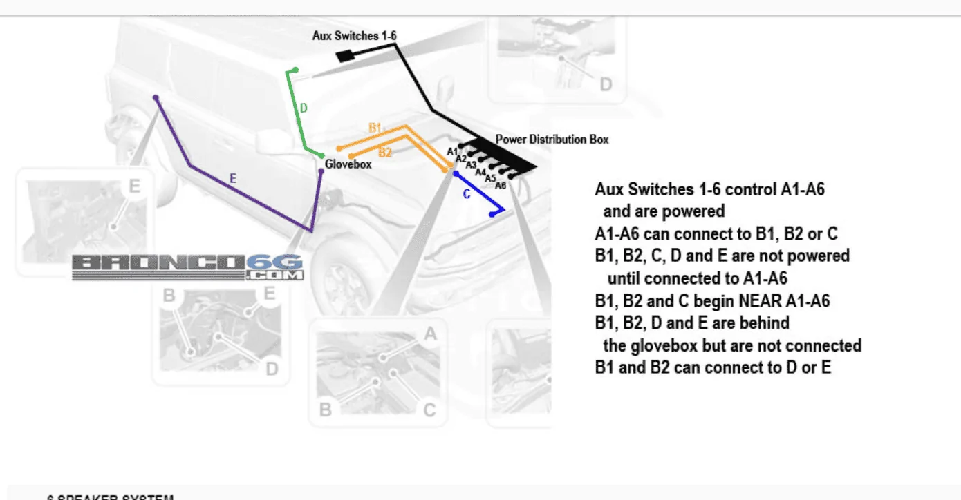

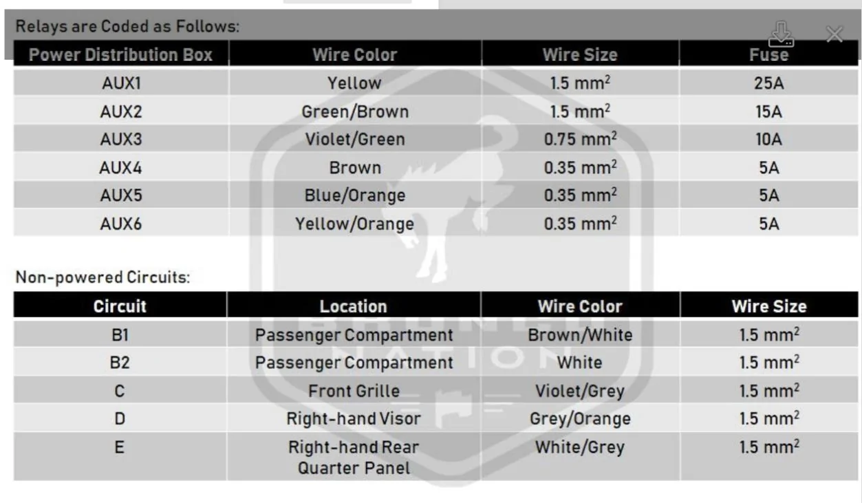

Based on the wire color, grey orange tracer it should be D on the diagram. There should also be a white with grey tracer for E in the diagram.

So "D" runs from the glove compartment to the right visor area? So these are just wires waiting to be attached to something, like B1 to relay, then B1 to D, then something cool connected in by the right visor?
Thanks for the quick response.
Correct, you’d hook up an Aux wire under your hood to your B1 or B2 there, then under your glove box you’d hook up B1 or B2 to your D wire, then at the top of your visor you’d hook up your D wire to your light or whatever you are going to run there.

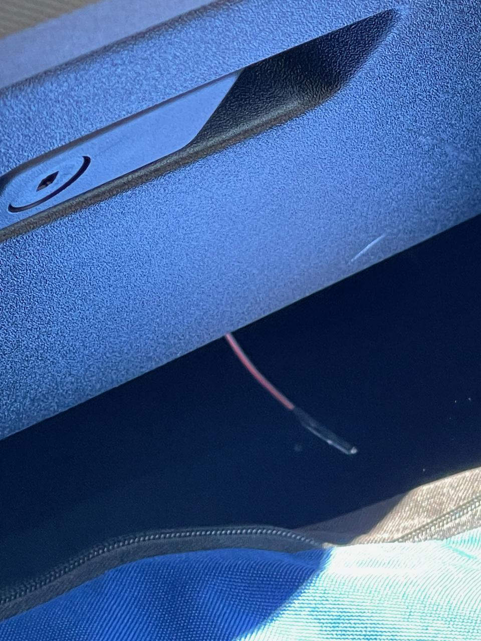

This just happened on my 2023 Badlands roughly 3 weeks old. Do I just tuck the cord back up there?

that is all I did. I haven't seen it since then.
