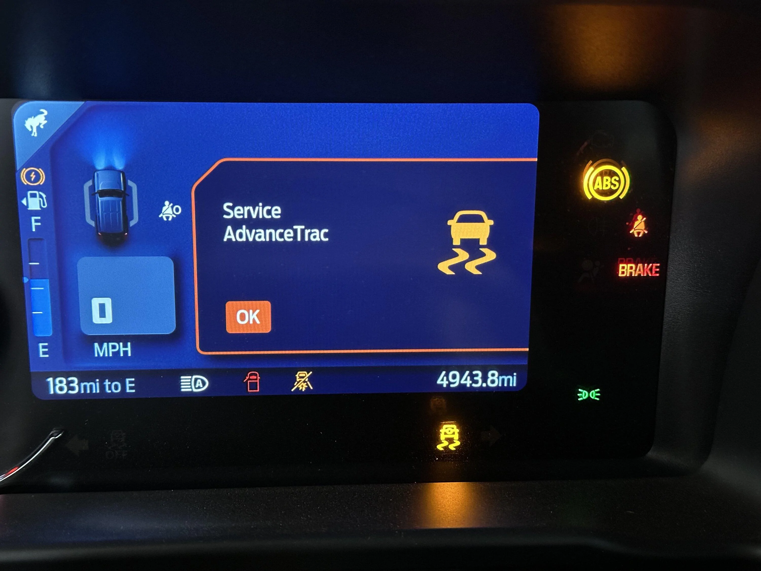

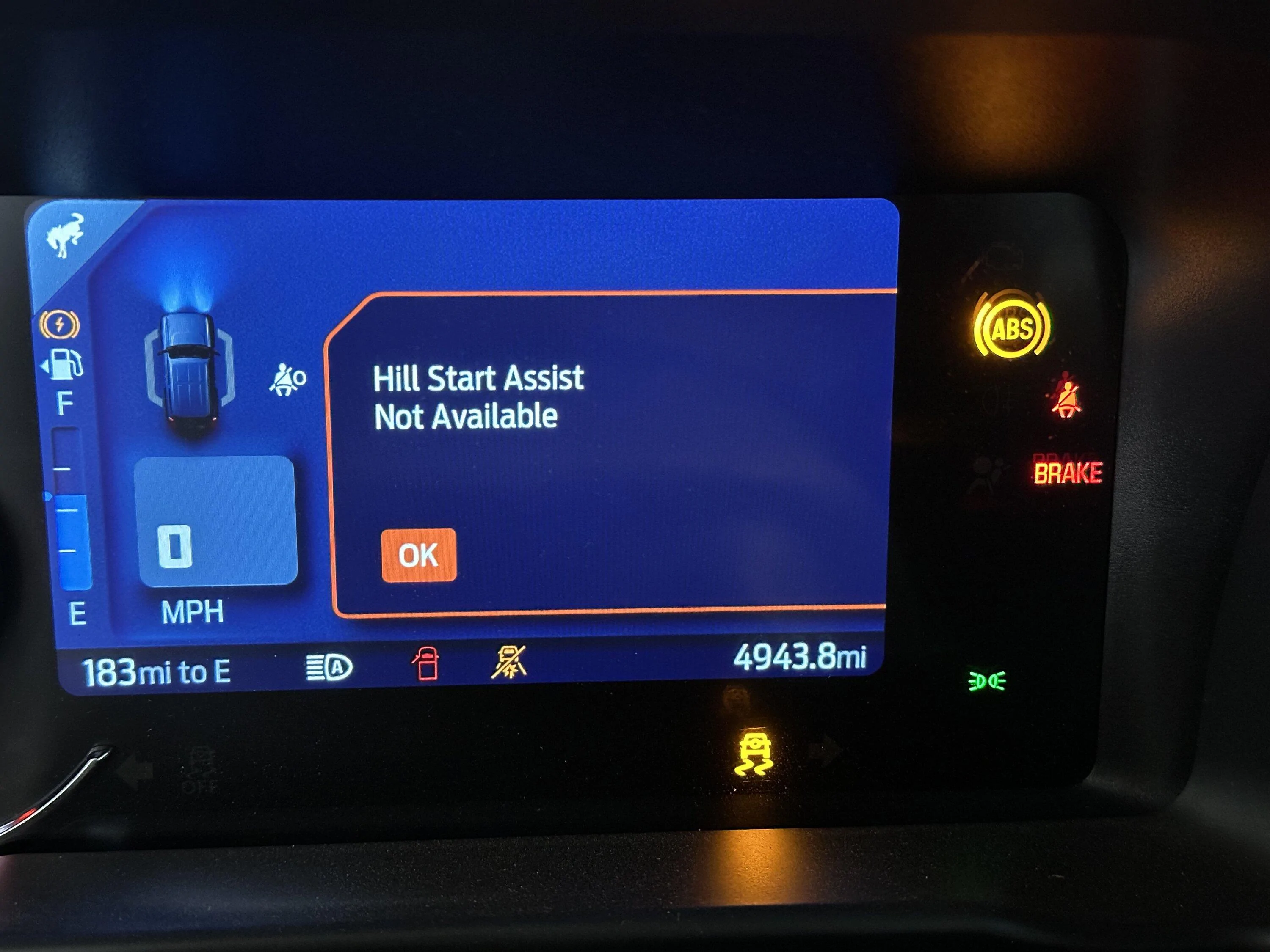

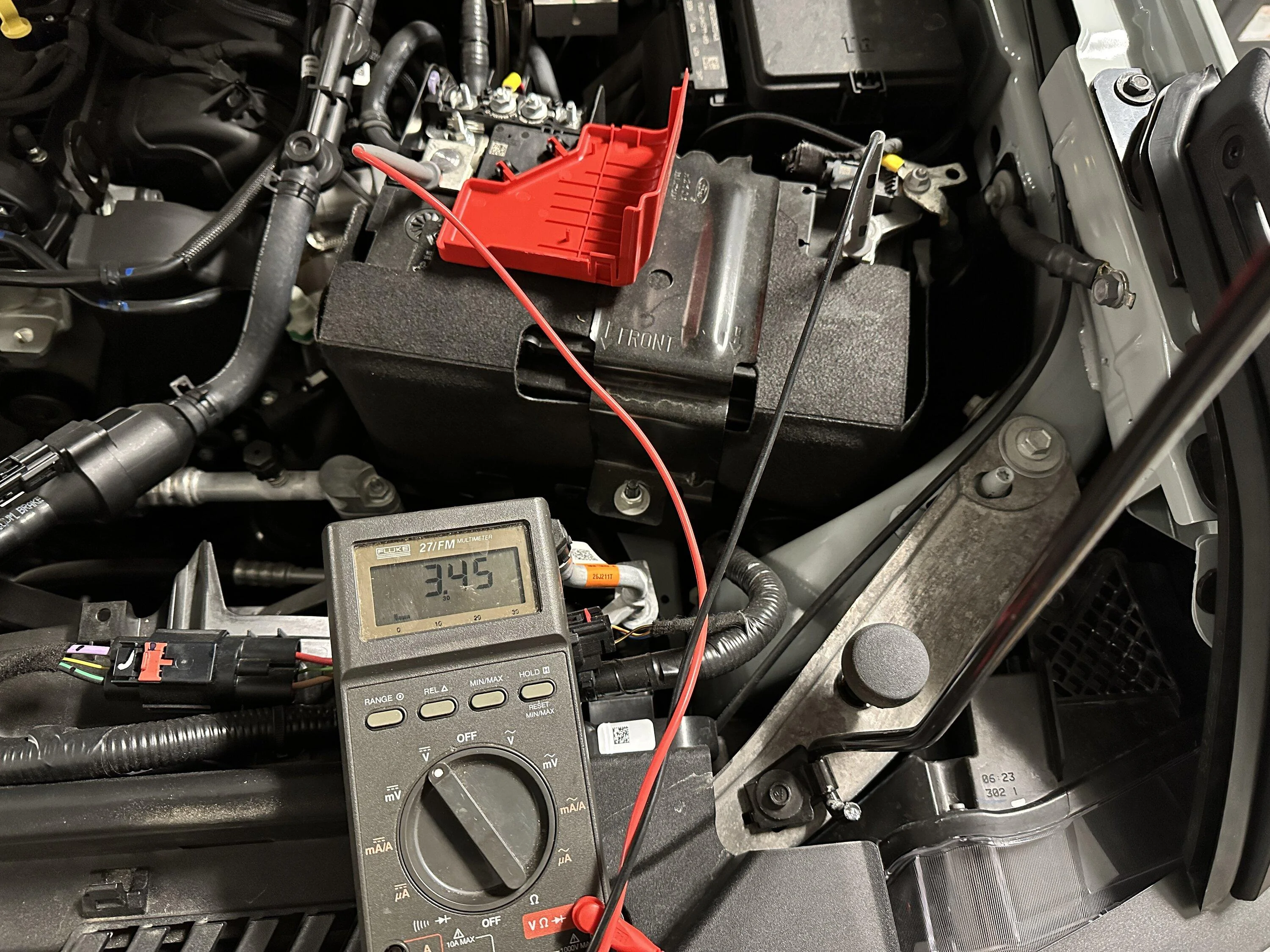

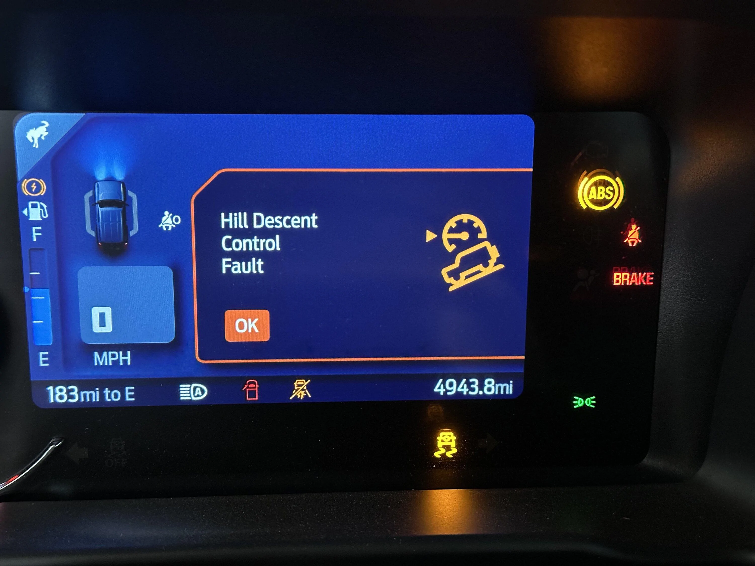

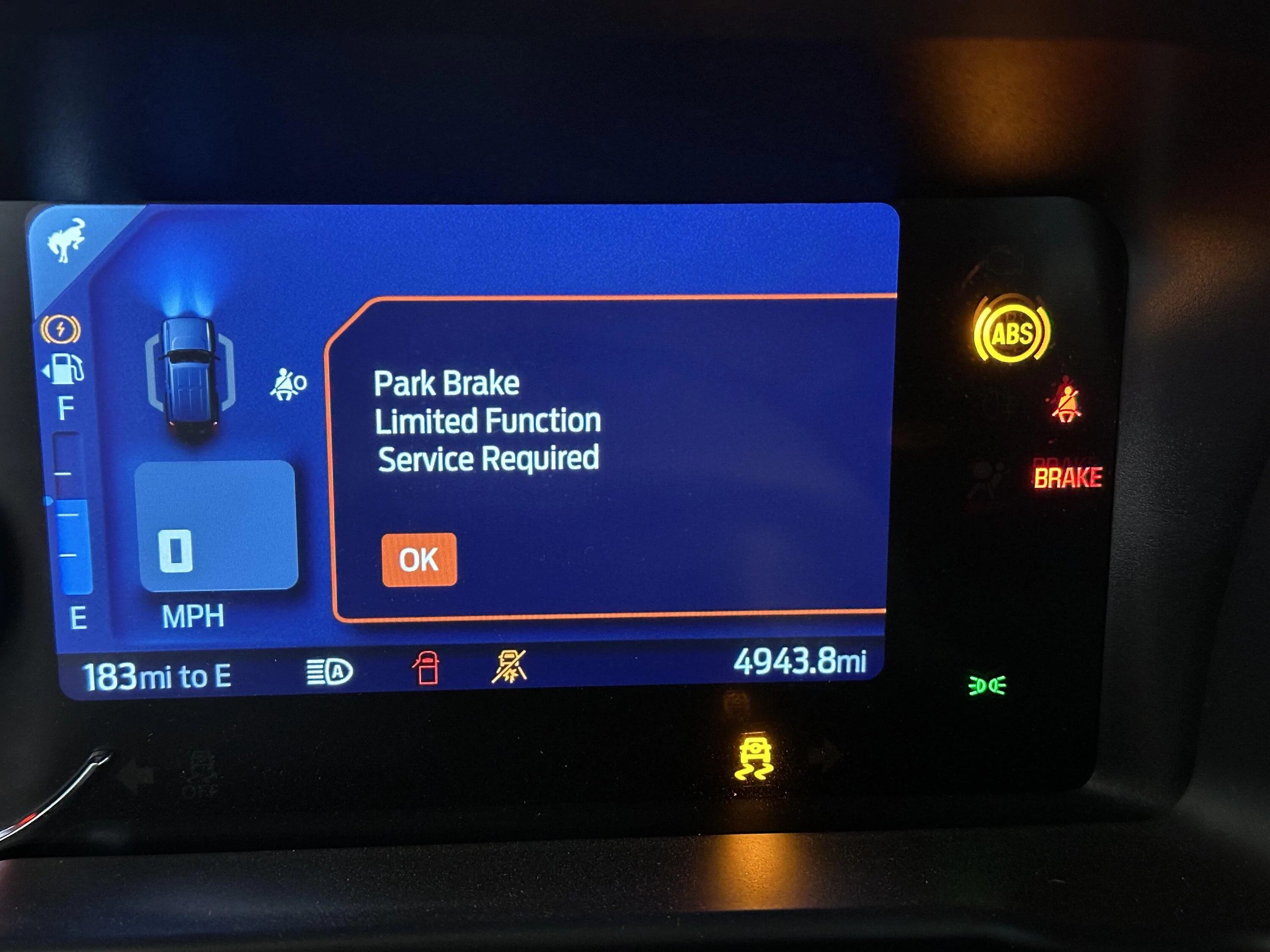

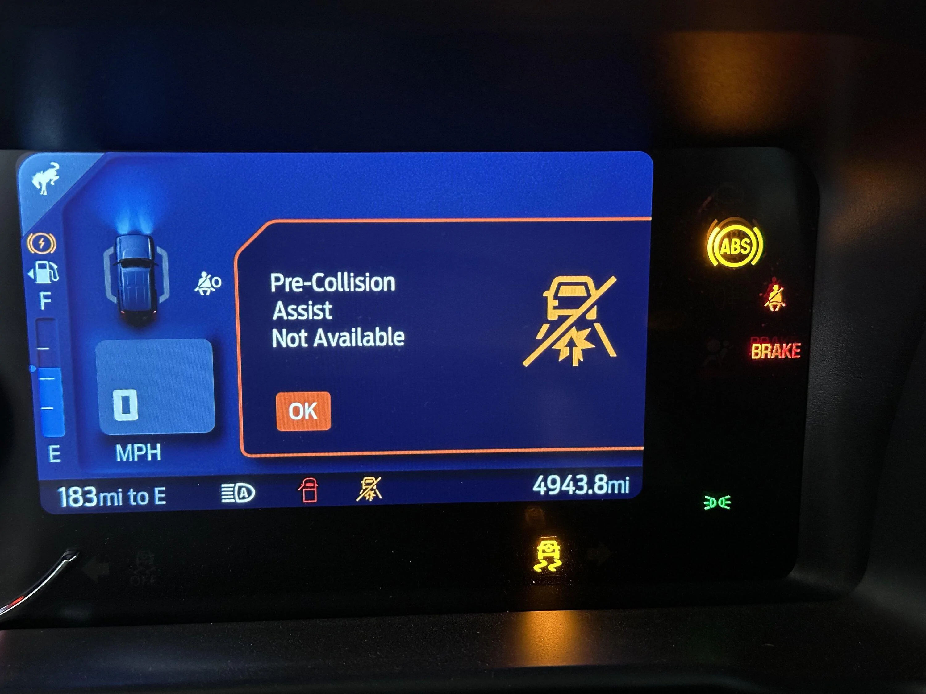

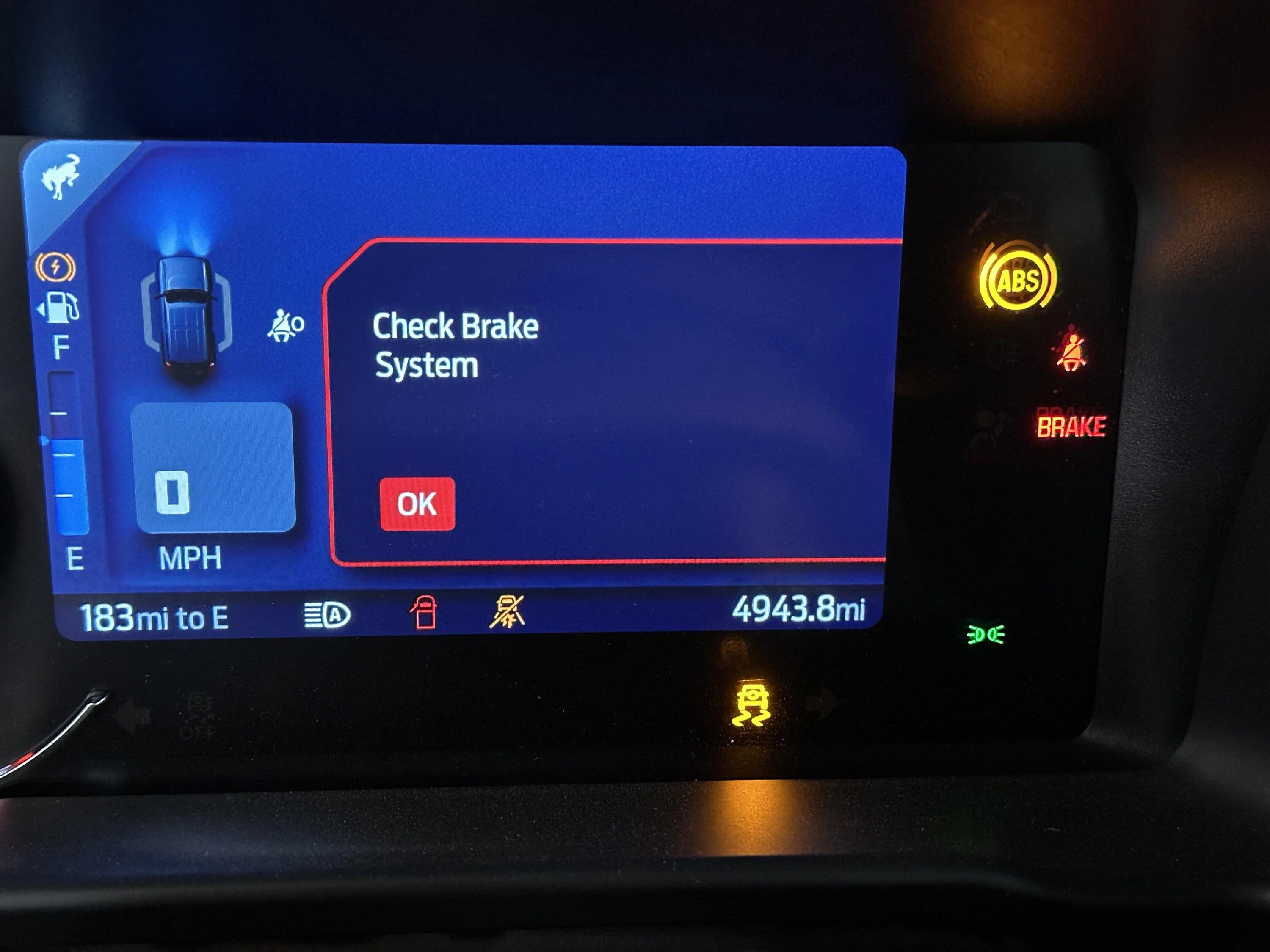

Mine isn’t stuck in 4x4, but after a month and a half of not using it the battery was down to 3.45 volts. I used my 7 amp Ctek charger for about 24 hours and the battery (surprisingly) seems ok. A week later I’m still getting all of these warnings when I start the truck. The truck is in the garage for winter storage, so it hasn’t left the driveway to possibly let things reset out on the road. I did try letting it idle up to temp then shutting it off and disconnecting the battery for 1 minute, all the warnings are still present.
Yes, my 2021 Bronco doesn’t have 5,000 miles yet. I have an employer provided work truck for daily use.
I got to work this morning and did my normal check for new service bulletins and this one came out about battery draw issues from a problem I have never seen. Might be worth considering for those with battery draws.
