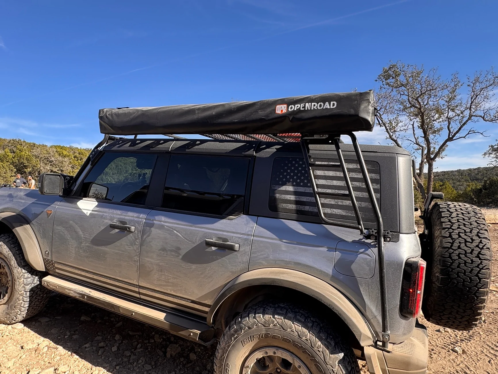

I am also interested. I have added lots of weight as am prepping for some long distance camping (not true overlanding). Drive a Badlands Sasquatch with addl RC 2 1/2” lift+tie rod upgrade+track bar. I’ve added Broaddict interior molle panels in cargo area and overhead in seating area, M2M drop down shelf and rear tailgate, drop-down shelf, Gobi rack and went from 35’s to 37’s. I’m not through yet, I have coming a rooftop tent from openroad along with a shower to supplement my OpenRoad 270 awning with sides. And winch. This doesn’t include all my accessories like refrigerator, etc..

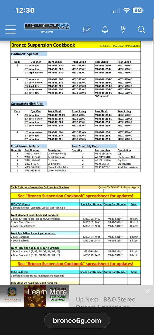

But I did some research too. If you look in the suspension section there is a master post listing of all the different springs used by ford. cannot remember if 24 are included, but for my 25 Ford uses different numbering.
So here are my thoughts, I did not buy a 24 like you did, ended up ordering a BL 2.3L SAS Manual, ordered it with factory tow to get stiffer rear springs. Knew I was adding winch… it would add weight and there are posts that it would lower front end, if so then I could get the front springs for a 24 w/ 2.7L SAS w/tow package… I had order the 2.3l.
Just now I am installing the winch so I will see if it changes ride height…
Winch plus 100#
2.7L plus 100#
2.3L minus 100#

But since I have an auto 2.7l, it looks like those are the stiffest springs, regardless of tow\no tow. I'd love to hear how much dive you get on the front. Thanks for trying it out.
