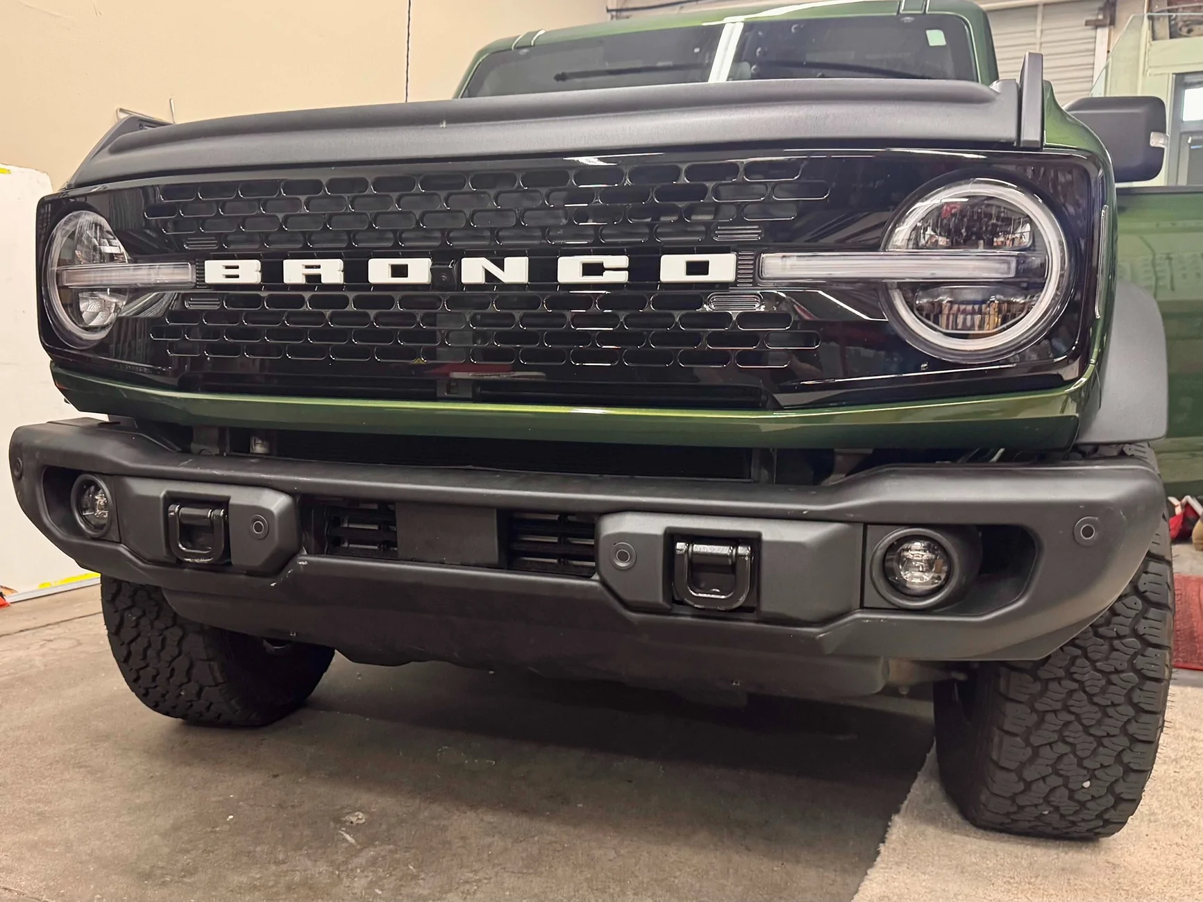

Yes, I did complete the project. Sourced a clean Capable Bumper from a local owner for $100. He was nice enough to include the metal bash plate and support brackets which were easy to install. Purchased 4 parking sensor bezels ($50) from my Ford dealer. They were not an exact match from my plastic bumper, but i did my best to align them as I was not sure how this would affect their performance.
Installation was challenging but not overly difficult. I was concerned the wiring harness from the plastic bumper was not going to be long enough but after some finagling I was able to make it fit. Drilling the holes with a cone-shaped bit worked great on both the plastic and metal surfaces. I used a dremel tool to notch out the sides for the bezels, I made it (almost) perfect.
Parking sensors work as designed.
About a 2 hour project and I'm pleased with the results. Looks so much better.
