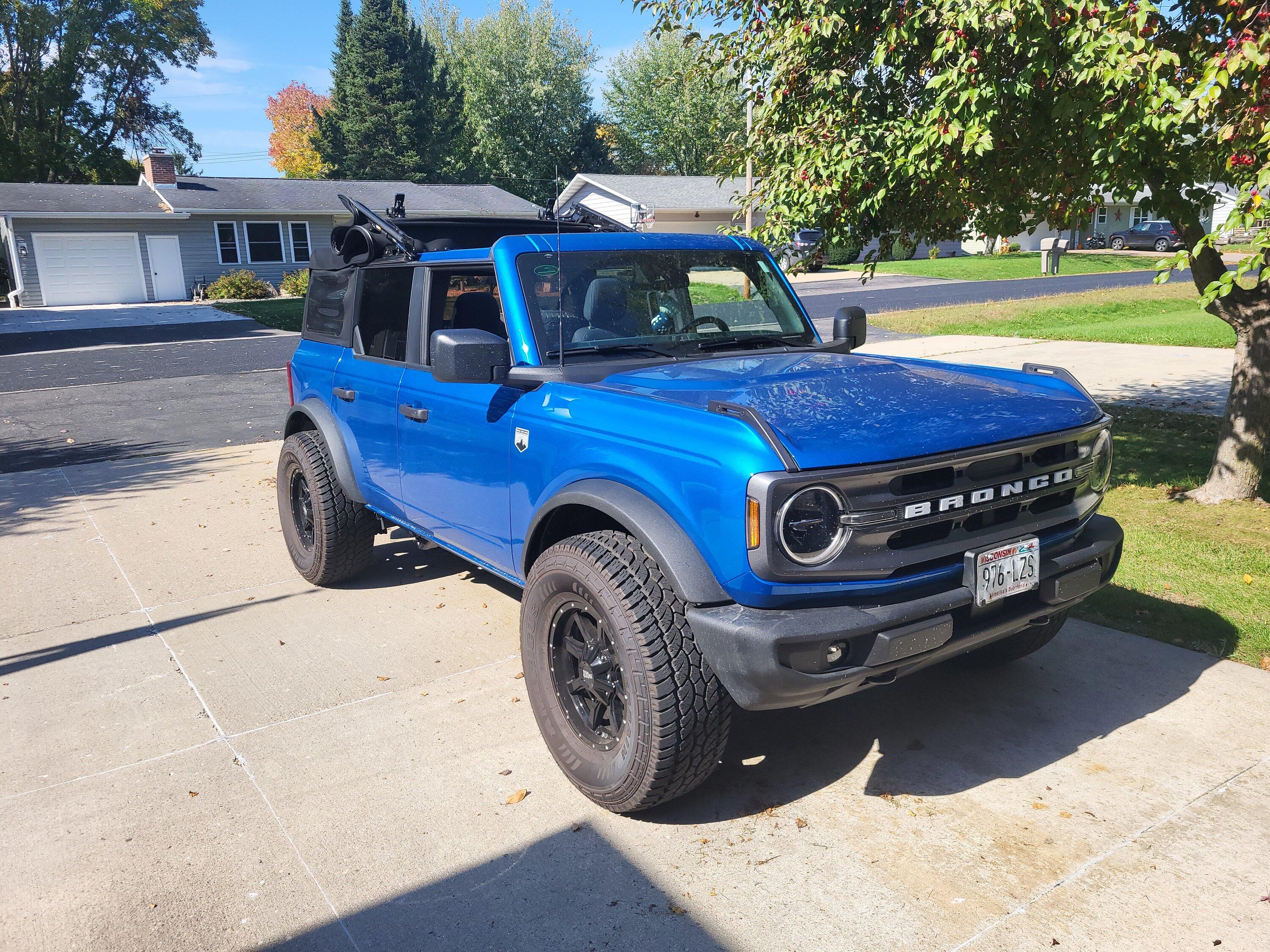

Hey all. My 2022 Big Bend Bronco came with after market 35 in tires when i bought it about a month ago. The Bronco shakes like hell when I get up to 65 mph.

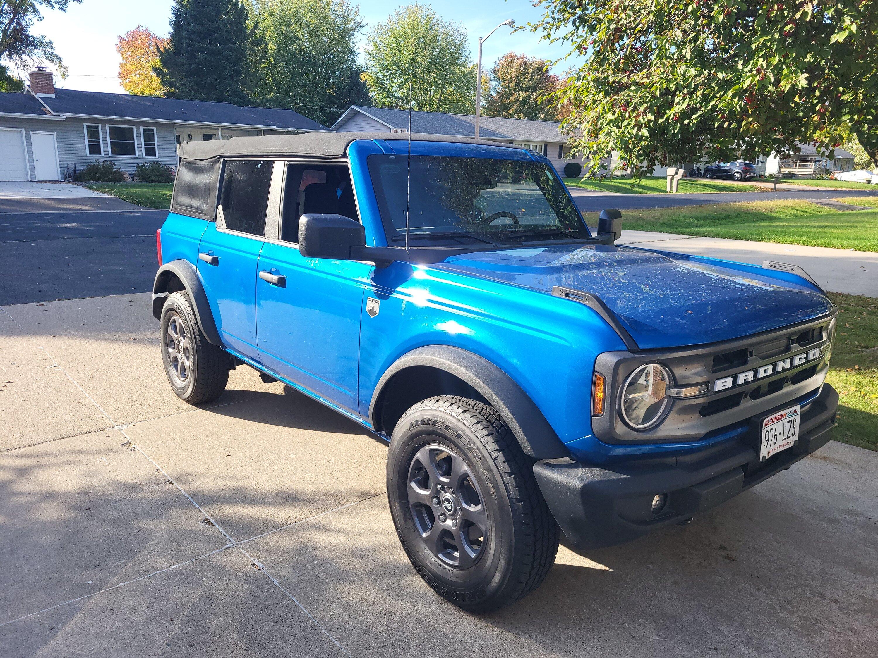

A buddy of mine suggested picking up some cheap takeoffs for trips and such, so I found some and I'm putting them on today.
I was also told that the smaller tires will do better in the snow anyway, and being in Wisconsin, that is a consideration. Salt causing damage to the larger rims is a concern as well. I'm still pretty green with big trucks in general. Almost always drove small cars exclusively before.
So just looking for some feedback on if I'm making a mistake going back to the smaller OEM tires for the winter or not. I plan to go back to the bigger 35s in the Spring, and plan to get them road balanced then to hopefully eliminate the shake in the future.
Do i need to worry about causing damage switching back and forth between tire sizes? Should I stick to one size in the future?

You shouldn't be shaking at 65mph...need to get them balanced properly.
A more narrow tire will most likely perform better in snowy road conditions assuming an all-terrain tread pattern. Switching between tire sizes won't be an issue other than your speedo being off.

Also have alignment checked by a reputable 4x4 shop or your local ford Dealer. Prev owner may have added spacer lift………..alignment is a good idea when making any suspension changes. Good price of mind. Tires are expensive.
